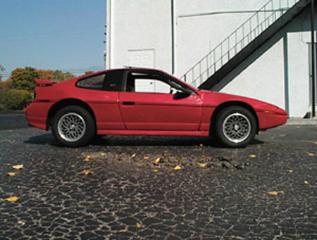

Just sand out the ribs. I think the combo looks agressive myself. The purple car was my 383 v8, named Raptor.
I dont like the 'snowplow' GT nose at all, the main reason I swapped it.

Ya I really like the look, it is very aggressive looking... I was trying to find a picture of one on google, but nothing... Thanks for posting those...
