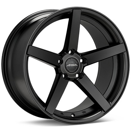

I think those are the wheels (ASA GT 8's) I'll get for my Fiero after having the current set since 2003...
I want to go with 17" in the front and 18" in the back. Right now I have 17x8 wheels with front 215/45R17 and rear 235/40R17 tires.
I have upgraded to the Held/Arraut sport suspension with coil-overs and bump-steer kit and have a 10mm spacer with longer wheel studs in the rear.
Now my questions are:
- When tire size can I go with?
- What offset do I need to have the wheels faces sit flush with the body?
EDIT: It's for an 87 GT and I have WCF's 13" big brake kit on the car which pushes the front wheels out a bit...

Loose the spacers, 18x8 25mm is flush with the lip. 245/40r18, on my 87gt. Look up my build thread for pictures. I don't have the bump steer kit but I do have the older style front coil over kit with the single bar control arms

Nice ride, i have an 87 gt with the arraut kit on the rear. I run 18x8 rims with a 35mm offset and 240/40r18 tires. Plenty of room back there looks good with the fender and doesnt stick out or in too far, just right. I staggered the tire size on the car to give a better look with 225/40r18 in front. All four wheels are tsw snettertons and have the same offset. I dont have any different hubs or spacers on the car and the rim fitment is perfect. I sit low with shortened bumpstops in front and flipped plates in the rear. Front tire is 1 inch from the fender on height with no stick out either. Hope this a helps it took me 2 years to find what i wanted and it was worth it, perfect the first time. Its your ride pick the wheels you like.

Yellow I have almost your exact setup on my 87 GT, Held coilovers 6mm spacers with extended studs. I have 18x9.5 with a +40 offset in the rear and using a 255/35/18 tire, this is the maximum offset on a 9.5"x 18" wheel that can be used with your setup (3/16" clearance). This is what it looks like,

That is a nice set of wheels that will go very well with your car and look trendy. But be aware that for them to look like in that picture they need to be wide. Otherwise they will look like the pic below which is not as aggressive. Going with 17s and 18s should allow you to find a better offset for the front (usually available in 17s but not 18s) and also go wide on the back. You need to find first which wheel widths are available in your model that will fit. After that then you can focus on the tires part which should be a lot easier. A 7"-8" front and 8.5"+ rear wheel would look great. The good thing is pre-88 cars are more forgiving to front wide wheels. Many times a wheel will come in 8.5", 9" or 9.5" but not in anything less than 8" which is a problem for the front of 88s. Later on I want to upgrade mines too. Good luck!
