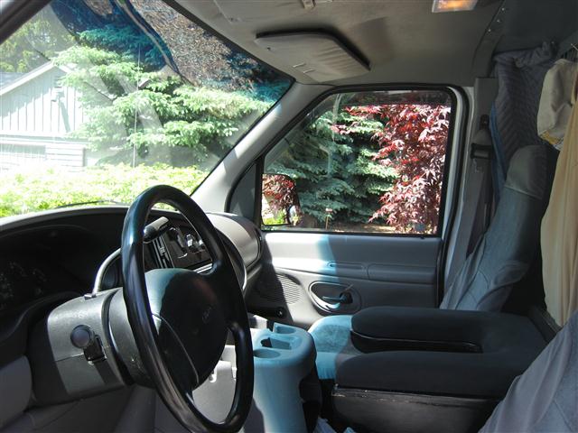

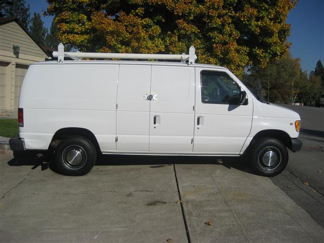

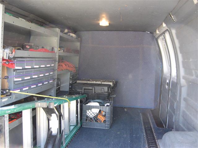

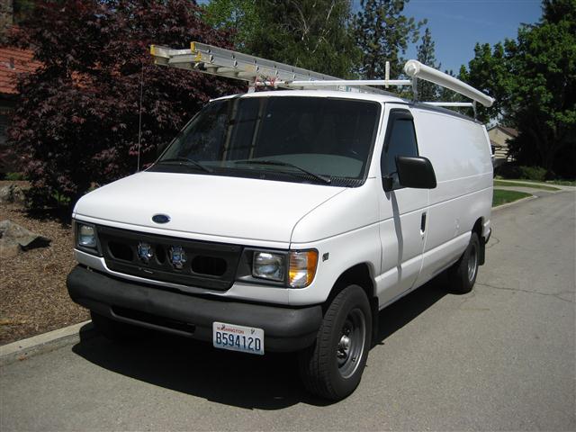

My last baby.... She was in rough shape, and in need of a trans, but she shined up well, and gave me a few years of nearly trouble free labor. I did all of the flooring, and E-track. Installed carpet, and even had a sound system bumping a cheapo 10". The moving blanket made it bearable during the Michigan winters. It got down right humid in the passenger area. I had even built a custom console.

, and that 1 ton suspension is harsh too!
It may be harsh, but it is ever so gratifying parked next to an E150 that is loaded up dragging it's tail, while your van sits tall and proud with a full load. Jealousy will ensue...
