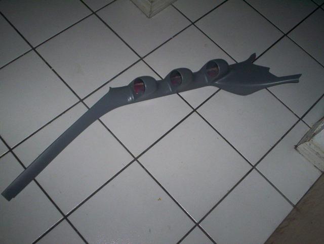

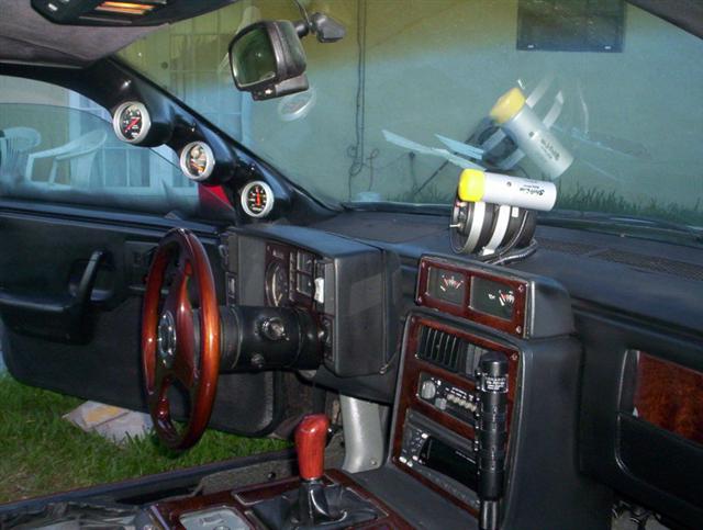

You can make your own like I did with a Ford F150 guage pod and mold them together it will take some filing to get the proper fit.

You can use Autometer part #17303, 17305 or 17311 these are the 2 -1/16" style the smaller ones and stick them with a good adhesive first then use body filler to blend it in and sand it till smooth water sand and paint to match.If you are running a performance engine the guages are a cheap insurance of the crucial engine functions so you can monitor what is going on before it is too late .....better safe than sorry.
