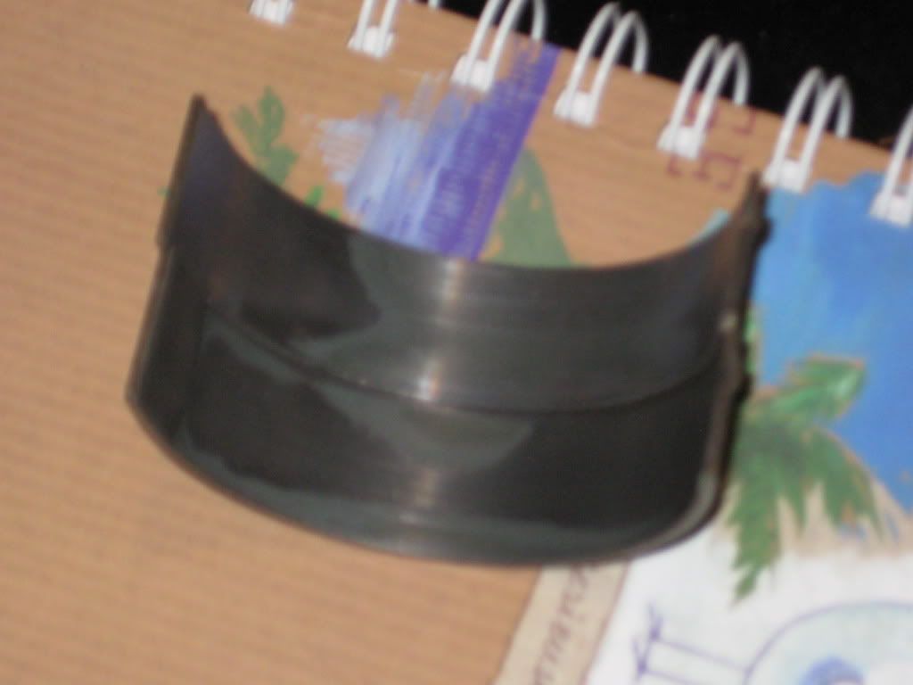

It's actually pretty easy to spot a worn bearing once you can see it. Here is a pic of a bearing that has SOME wear. Still running nice and quiet with good oil pressure and no engine noise. They got replaced in this example, but just to show what a good, but worn bearing looks like.

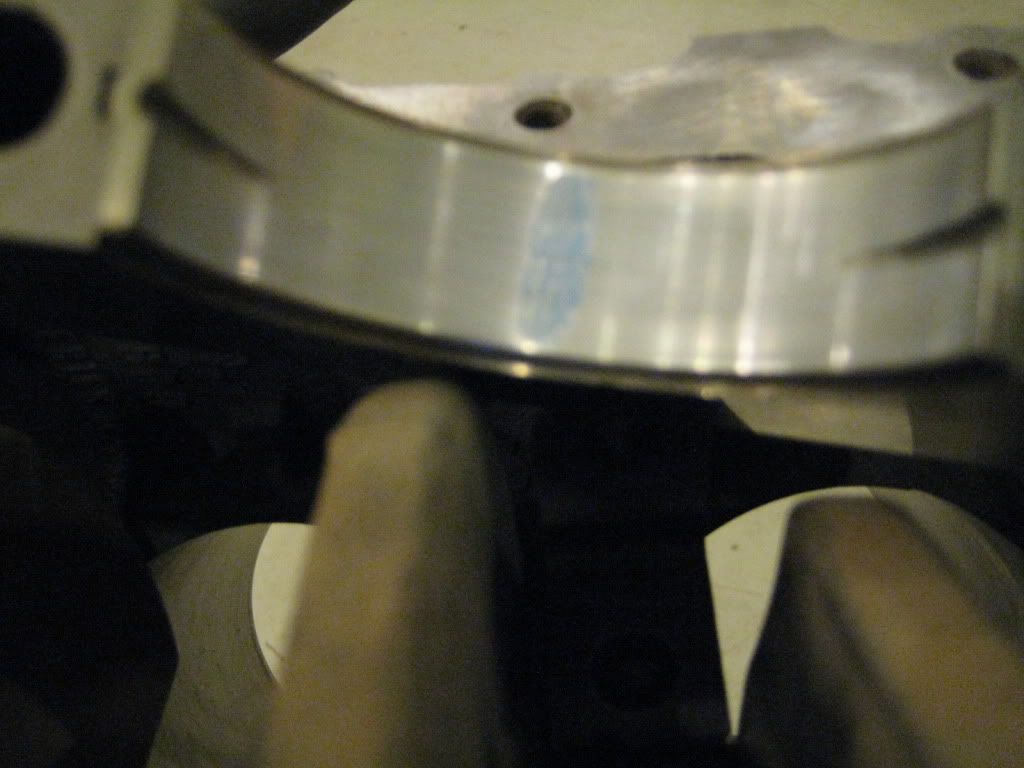

Here is a good used bearing. The blue is plasti-guage. If you use plasti-guage, clean it off when done.

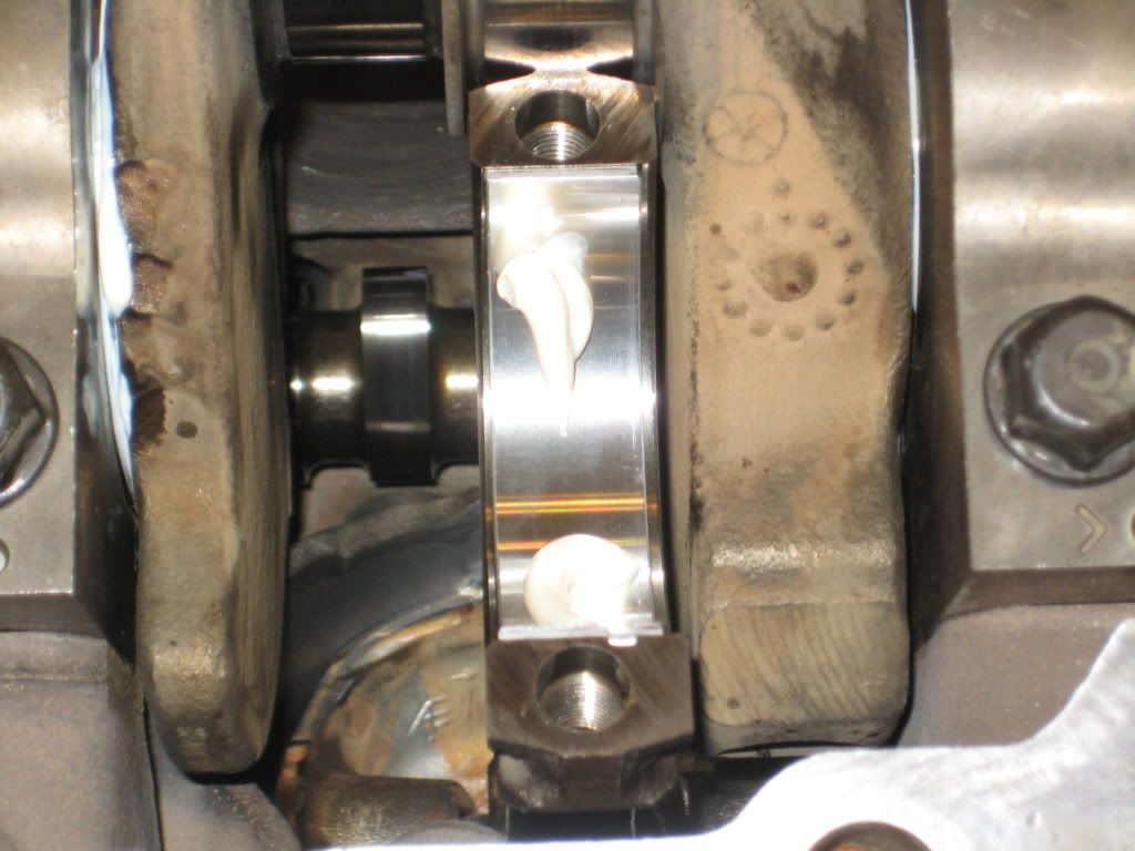

Here is a new bearing with a couple globs of assembly lube on it

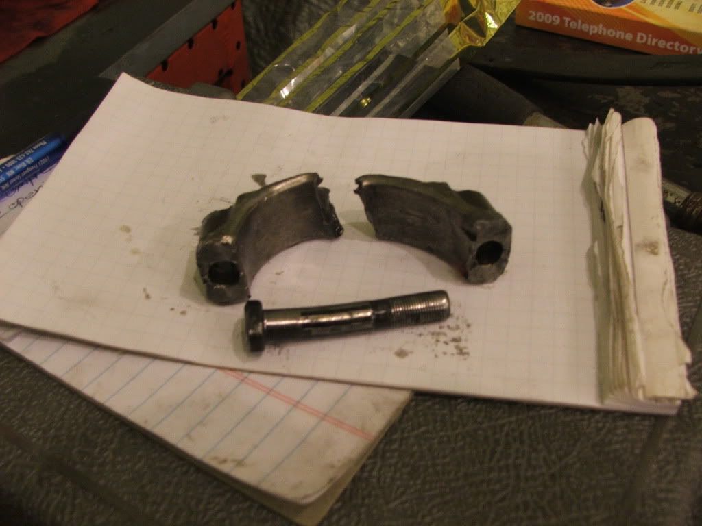

Here is a very bad bearing
Ok, that's a rod cap, but just imagine what the bearing looked like. That was the result of a spun bearing. If you see a spun bearing, there will be no doubt in your mind if it is bad or not. Pretty obvious. But at that point, the engine is already knocking pretty loud.

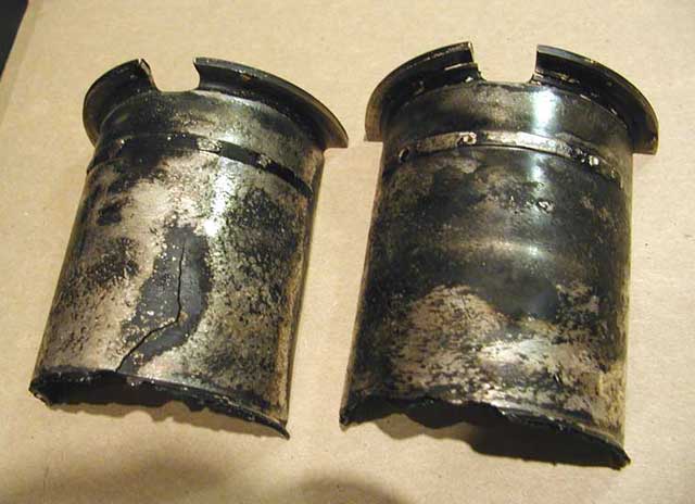

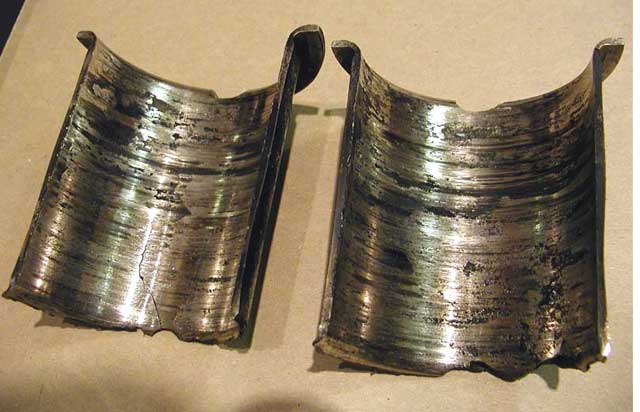

Now THIS is a bad bearing:
