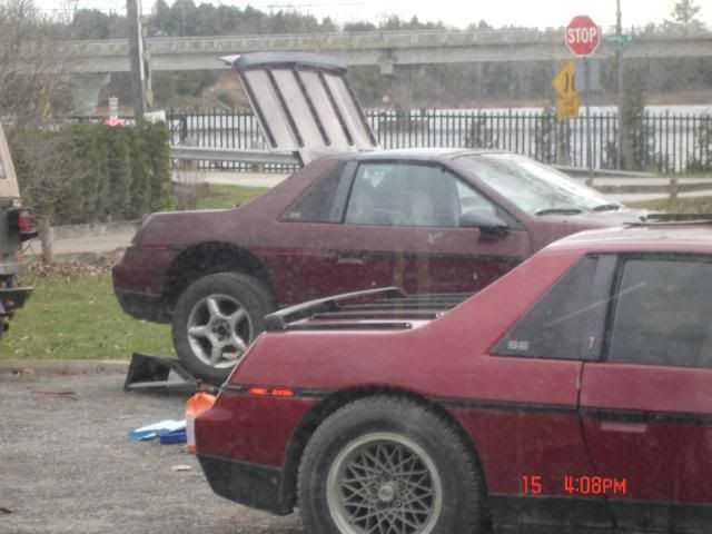

Report this Post02-22-2009 09:21 AM Click Here to See the Profile for rourke_87_T-TopSend a Private Message to rourke_87_T-TopDirect Link to This Post
I have two '87 SE's both Burgundy/Black, they look identical to yours. both L44's. I am restoring the car in the background of the pic, it has a C&C T-Top fitted prior to delivery on April 6th 1987, it also has a Muncie/Getrag. No Air conditioning completely original except a poor quality repaint. it even has the original cassette player still.
How is the paint on the one in the foreground? Have you thought about swapping those panels over? Or do you want to keep the matching VIN tags on everything (panels, etc)?
Don't know if you know... but the 87 SE is actually the rarest of the production Fieros. It's not really worth any more or less than other cars... maybe less than an Indy or a Formula, but it's the lowest production model made. They only made something like 1,700 V6 1987 SEs. And they only made 1,400 87 SEs with the 4 cyl in it.

Report this Post03-25-2009 09:32 PM Click Here to See the Profile for rourke_87_T-TopSend a Private Message to rourke_87_T-TopDirect Link to This Post
The one in the background is a low mileage/kilometre's to be precise, T-Top. 2.8 / 282 Getrag. the car suffered a cheap paint job early in it's life. I am restoring it at the moment with many new and aftermarket parts and parts cars, paint is far down the list at the moment. The one in the foreground 2.8 auto, it has a lot of nice parts but it is my everyday driver, hauls the trailer around etc. eventually this one will be my car to modify. I just bought an Allante transmission yesterday and planning to put onto my '88 cradle etc.
