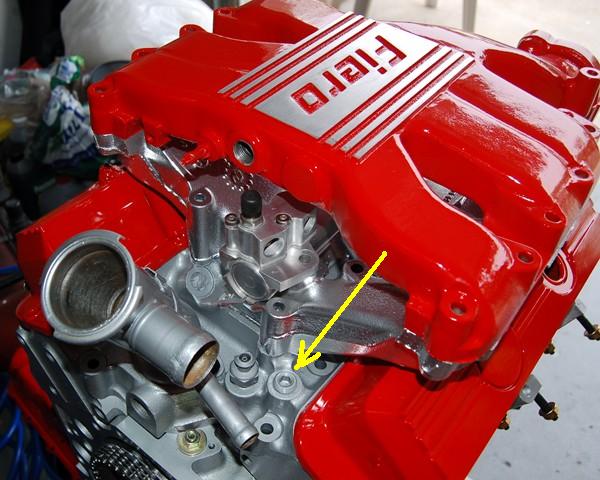

See the black bicycle tire valve stem cap, located a bit straight above the tip of the yellow arrow? Thats the valve. Yours will have a metal cap that kinda doesn't look like it will screw off, but it will kinda easily. Under there is a bicycle valve stem type valve. Push it in the middle and it should squirt the gas.
Wear eye protection. Have a fire extingquisher handy. Have some rags handy to catch the squirt if needed.
Don't wait too long after the prime or your test might not be valid. The fuel rail should hold pressure for a fair amount after the prime, however many don't any more. That really doesn't matter much, just as long as it has pressure when the pump IS running.
