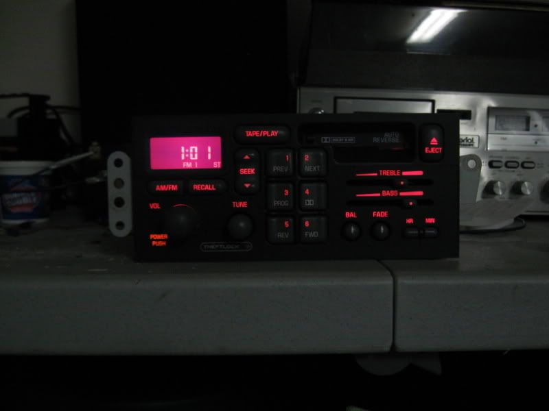

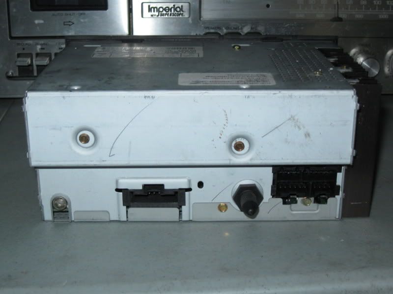

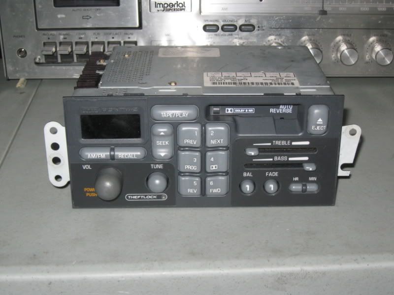

I found a Pontiac radio today on Craigslist but the guy didn't know what year car it is from or even if it works. It was practically free so I picked it anyways. I would like to bench test it to see if it works. My problem is that it does not have a pigtail. Does anybody have a map of the pins showing what they are? Thanks in advance! Here are a couple of pics of it.

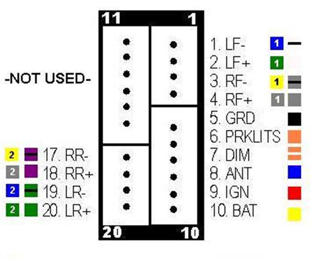

More info on the pins: http://www.andylphoto.com/fiero/wiring.html

The bench test went great. Thanks again for the help.

Somewhere around 1989 GM started using a different plug on SOME radios. The 1991 Deville radio I installed in my 89 GMC truck was the same except for the plugs and the little Caddie stuff on the knobs. It also worked all the time. The older GMC radio was a some times radio. Sometimes it worked, sometimes it didn't. I purchased the adapter off of E-Bay for a few $s and have been using it since last May.
The 1999 Chevy truck CD radio I had in my Silver 86 coupe used that same adapter.
Its called a 20 pin radio-12 pin car adapter.

See pinout diagrams here: http://www.installdr.com/Harnesses/GM-Wiring.pdf
