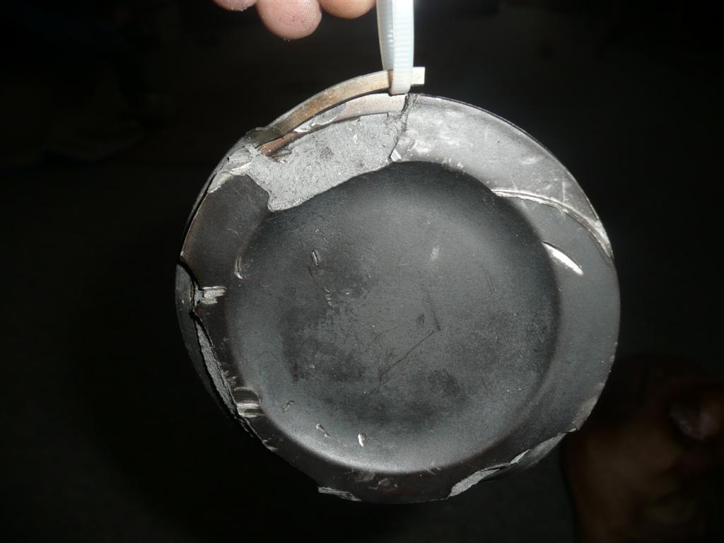

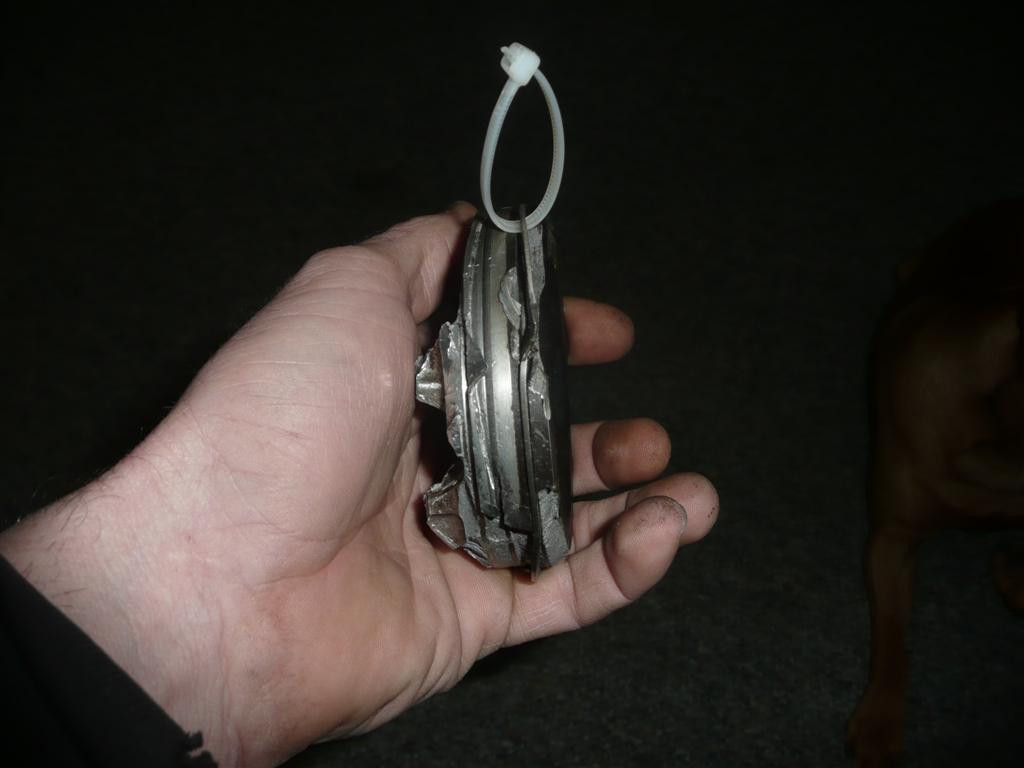

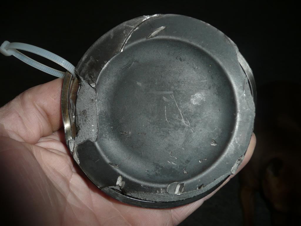

Question, what is the MOST commonly failed part on HIGH horsepower 3800 setups?
I will tell you right now it is not the pistons. In every case that I have experienced when the "**** hit the fan" it was a rod that went (most commonly L32 style rods, but that seems to be just because most high power builds use them).
Again, you are not getting my point.. I was not asking why a forged piston is awesome, I was asking what busniess you have telling me/the world that a forged piston is the best way to make a 3800 a better motor.
Also, one of my favorite advantages to a stock piston, is its ability to shrug off events that cause knock through the form of compression ring blowby. It helps knock events significantly more so than a forged piston with fancy "total seal" rings

In my experience, the most common cause of a spun rod bearing other than an oiling system failure has been overly aggressive timing. The excessive load placed on a piston during pre-ignition forces the thin film of oil between the rod bearing and journal to dissipate for an instant. This creates a temporary dry contact between the surfaces.

Well I think these pictures are relevant to this discussion. Unfortunately! I'm still not 100% sure what caused this. The engine had been together for a while and up to this point was coming along rather well. The engine was 98 l67, gen V , 3.25, s1x, n* w/Lq4 maf, 42lb inj, ported heads 105 springs, lim gasket matched, headers, full gasket kit, full bearing kit, rings, lifters, and push rods. Everything except pistons. I think its anyones guess whether they would've helped or not. The tune was on the safe side(DH's), no kr to speak of, afr seemed to hang around 10.5 to 11(although 1 time at wot it went to about 13 for a glance), timing was safe at 15.5 to 17 at wot. Well as stated before everything was going fine except I couldn't get 3rd gear to shift at 6200 instead 5600. On the pass that it blew on The only thing changed was timing. Done by me of course with very little understanding of what it was suppose to be. I know I should've went to 3.0 pulley before adjusting timing but I'm only human. AFR fine, running roughly 19 to 20 degrees through 2nd, but at the top of second it advanced to 24 degrees and then poof. Again no sign of kr before the blow out. It blew out a huge chunk of block from #3 cyl, broke #3 n #4 rods clean from their respective pistons and off the crank. Both pistons were still half way up in the cylinders with the rest of the shrapnel in the pan. I was never easy on this engine. Oil pressure was never really great @ around 25psi. I felt it would be doomed cuz of that but I had guys say theirs ran at that pressure without issue. I would've liked to had 50 psi but. Take your best guess or give your opinion on why this happened so I dont make that mistake again. DH told me the same thing he said in this thread being a rod bearing failure as a result of the engine builder. I could buy the way ryanfrommichigan explains it. Like I said this thing had no prior odd noises, rod knocks, or anything so I dont think I had a spun bearing going into that run. Would a rod know show up as kr but more of a false knock? Chris
Wow, that sucks. Based on the info you've given and the pictures you've posted, my best guess is the stock piston suffered from the classic failure they are known for: design flaw (top compression ring placed too close to top of piston) and insufficient piston ring end gap for the conditions which caused the ring to deform due to the excessive amount of heat it was subjected to which snapped the ring land off the top of the piston.
Would the use of a forged piston have prevented this? Hard to say. All I can say is the forged pistons are designed to take more punishment than stock cast slugs. They also tend to have the top compression ring moved down further from the top of the piston vs. stock which does not expose it to as much heat. It probably would have lasted longer but I don't think anyone can say for certain your engine would not have suffered a failure. I can say that forged pistons usually don't come apart in chunks like cast ones do (as shown in your pictures).

Just to say in relation to demtentia's failure.
I have ran 24 degrees of timing, on the same gas, on the same pulley, running leaner AFRs without issues before... and I didnt have the cam. So I was a bit confused at to the failure being directly from the extra timing. The knock sensors on that car were actually turned up a bit in sensitivity, and adjusted for the cam properly, so he always saw KR when tuned wrong... yet it poped without even a hint of KR before it went.
Could it have lean spiked from the fuel pump? Probably, and thats still to this day what I account the failure to, but I also think it could have been crank related, due to the rod blowing out, then taking the piston with it. If you look close at the piston pictures, you can see where the piston rotated in the bore, causing the ringland failure. It is most likely, unless prior damage was done, that that piston was perfectly clean, until the rod snapped and twisted it in the bore.
