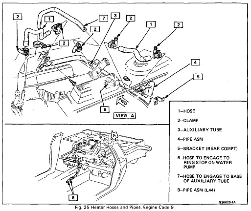

Mmmmkayyy....
It was cold this morning. Very cold. Ice all over the car type cold. I scraped it off, got in, and remembered.... 'oh yeah, i dont have heat... $#@$'
My problem seems to be that i have no hoses going from the engine to the under car pipes. Help me out here:
There should be 1 pipe from the water pump area to the under car hoses
There should be another from the intake manifold area to the under car area?
There doest seem to be any good thread with this information or better yet, with a picture.

The under car side pipes are to and from the radiator. The pipes for the heater run alongside the fuel tank and come up on the firewall.
Section 1 in the Factory Service Manual has complete diagrams and diagnostics for the heating and A/C system.
Download one here (get the 1986 manual) http://www.fieronews.net/fusion/downloads.php

Be careful, most likely the heater core was leaking, so the previous owner removed the coolant hoses.
