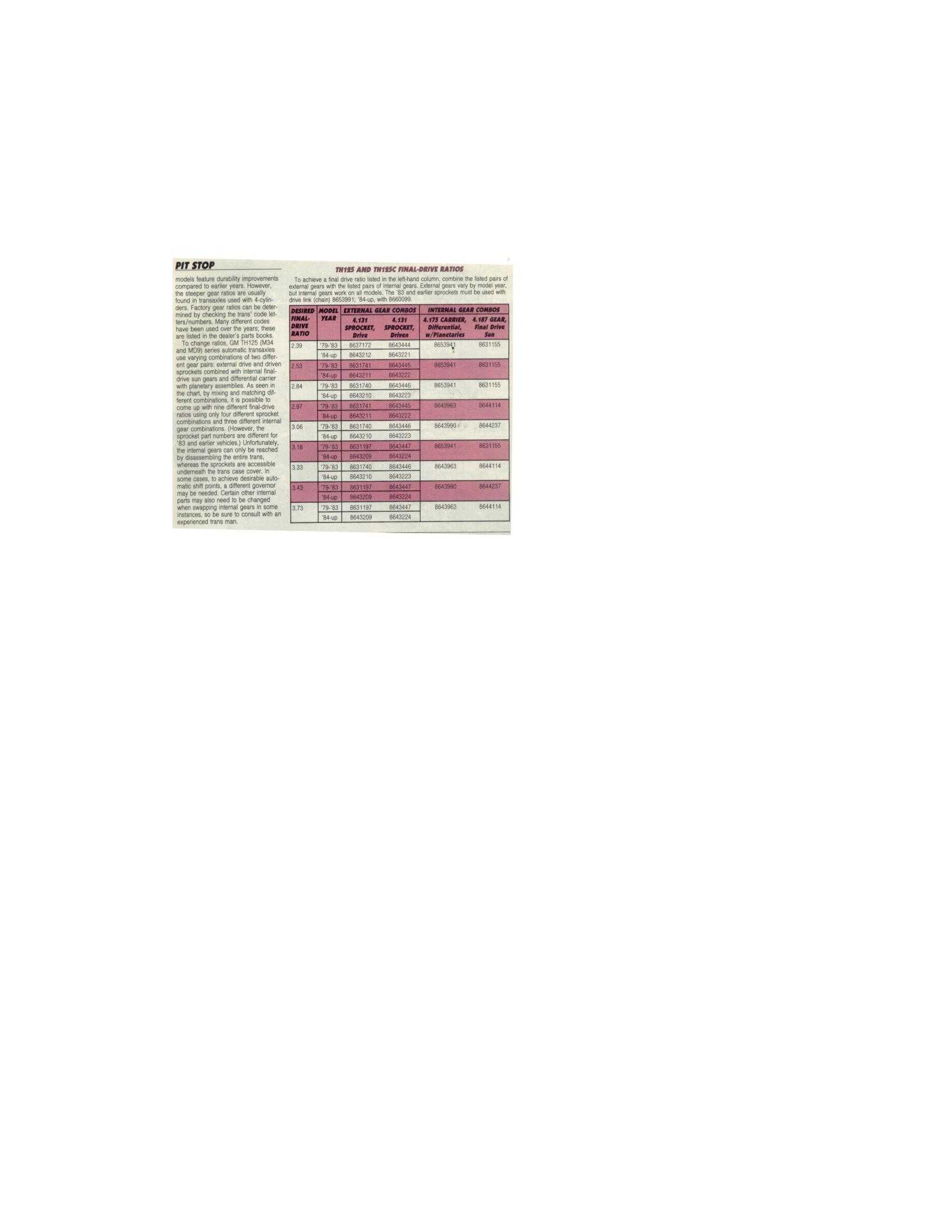

HMM... I wonder if the 3.33 was a late addition in 1986 like the getrag 5spd?? It maybe the fastback GT's had the 3.33 since they were switching over and the GT was a mid-year start.
As for wanting to change the final drive ratio's, Here is a list of gears you can change with their final ratio's

  3. Page 3-3 of this `86 manual also erroneously shows a picture of what appears to be an `85 GT because of its rounded front fascia --- coupled with a "notchback" roof --- rather than an `86 GT, all of which had the then-new "fastback" roof.
In short, I suspect either my original-owner "Pontiac Fiero 1986 Do-It-Yourself" manual has at least three mistakes reported in it, or I have an ultra-rare `86 GT --- likely worth trillions.
If the latter is true, that would be nice, as I could use the extra money.
