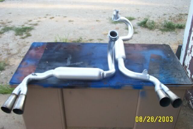

I used the headers that are available through Archie (I also used an Archie kit for the instal). They are "Sanderson Street Rod Headers". Here's a pic:
Also, here is a picture of my exhaust. It is 2 1/2" off of the headers, to 3" single exhaust. 3" high flow cat. converter, and 3" inlet and dual 2 1/2" outlet Camaro/Firebird style Flowmaster muffler.
***I have to mention that I removed the lower section of my trunk so I would have more room to run pipes and mufflers.***
***I also have to mention that its still loud! Might not be alot of help, but maybe you could have a system built with smaller pipes, or a bigger cat. converter (to dampen sound), or maybe a muffler thats not as loud as a Flowmaster***
Hope this is some help!

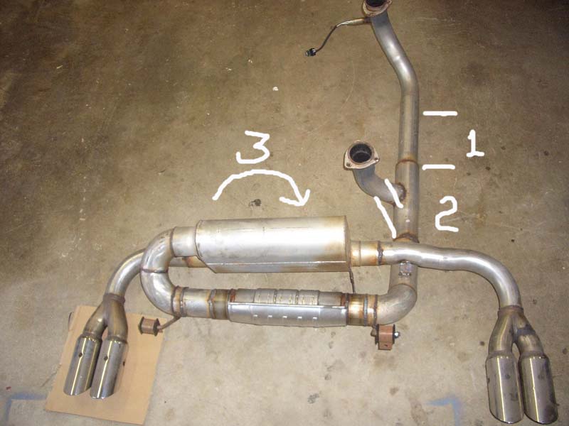

I don't have a good picture of my setup, so I'm using photo supplied by Chris above to illustrate my setup.
Area 1 should contain a high quality 3 inch flex pipe, this will prevent high stress loads on headers when the heat up, or cool down (saves the welds on thin wall headers).
Area 2 should contain a mandrel bend rearward sweep into the 3 inch collector, sweep should be maximum as possible before the turn. This way the exhaust from the rear back will flow better and also not imped exhaust from the front back.
Area 3 (mine's non converter) so flip the muffler 180 degrees so inlet is on the bottom right, outputs at top right and left.
My Flowmaster is heavily modified, mid body was cut, dished in, re-welded with plate, so that it could be packaged without cutting the trunk or cradle.
