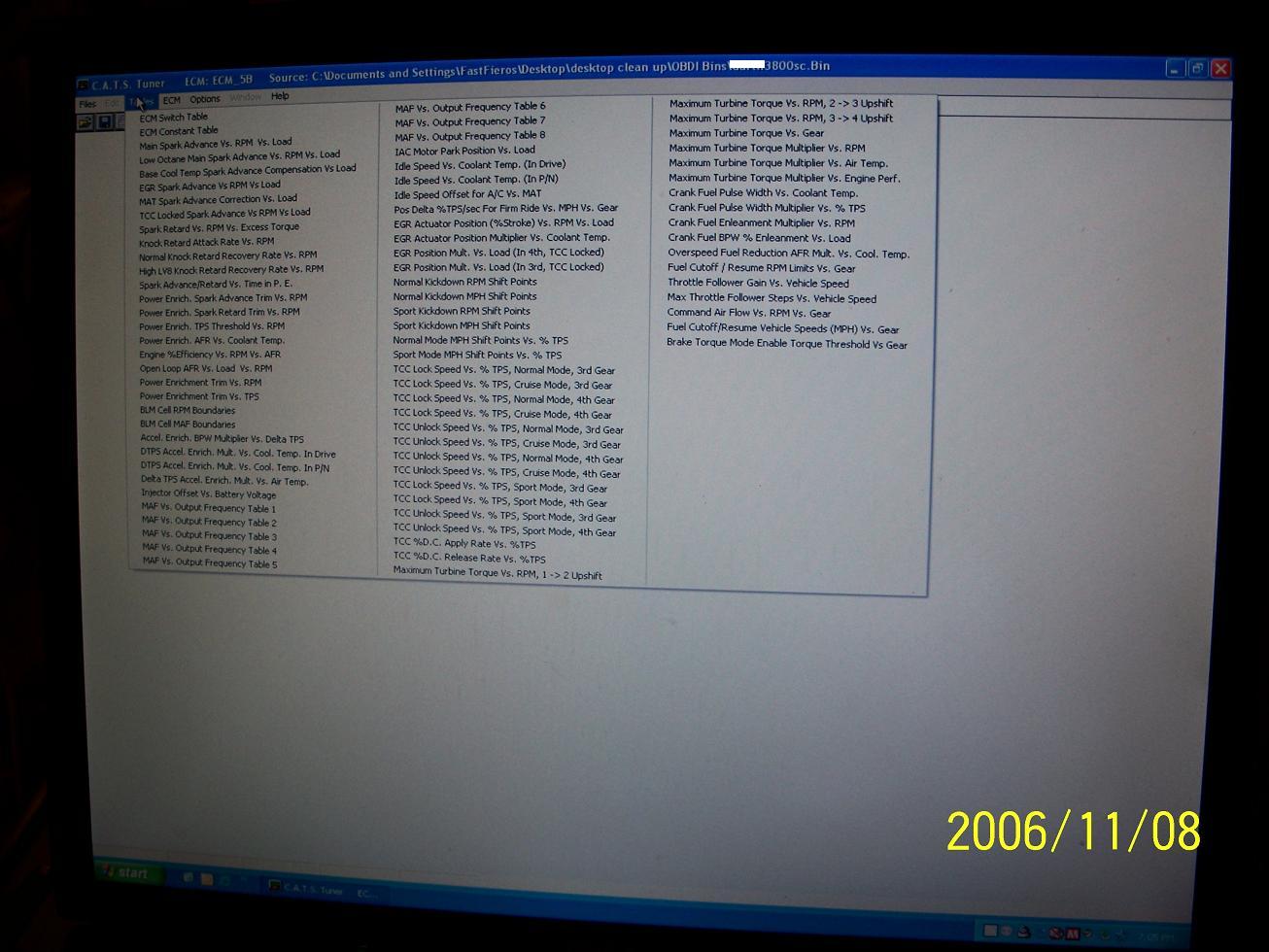

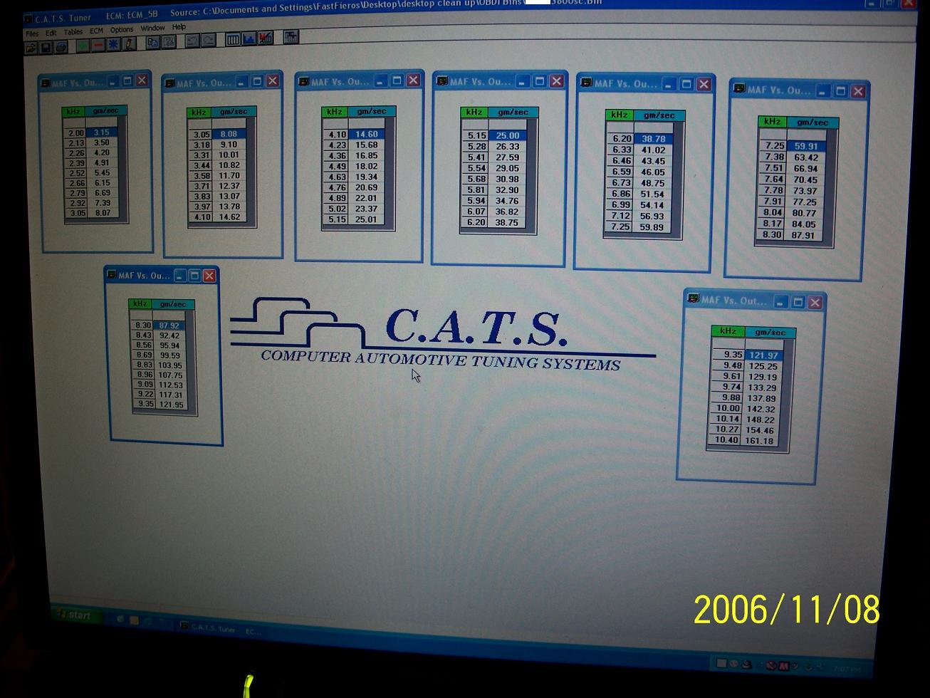

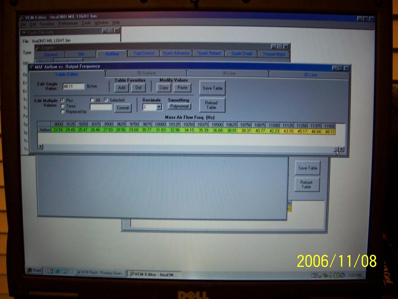

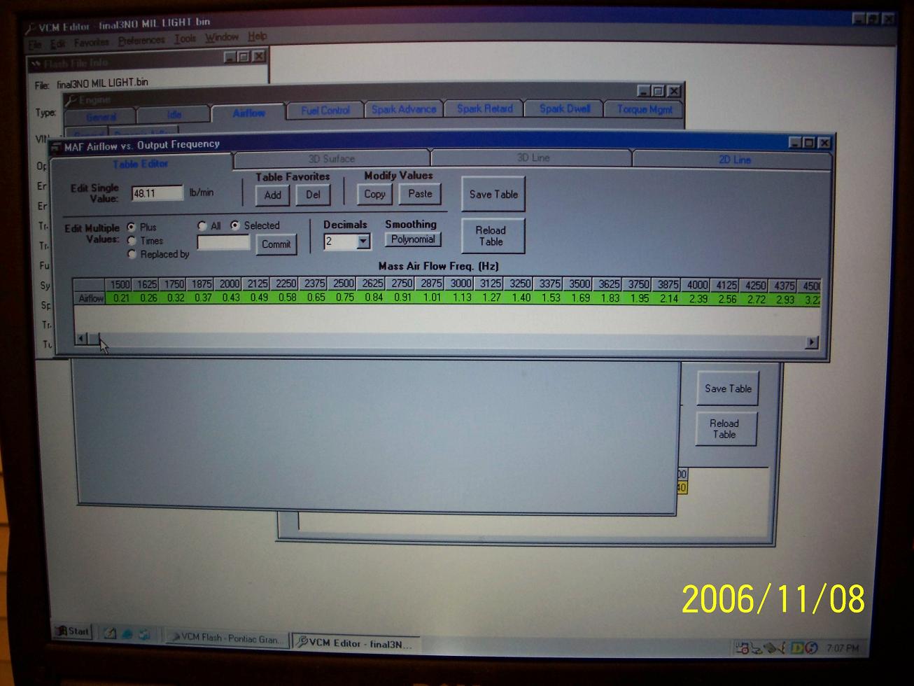

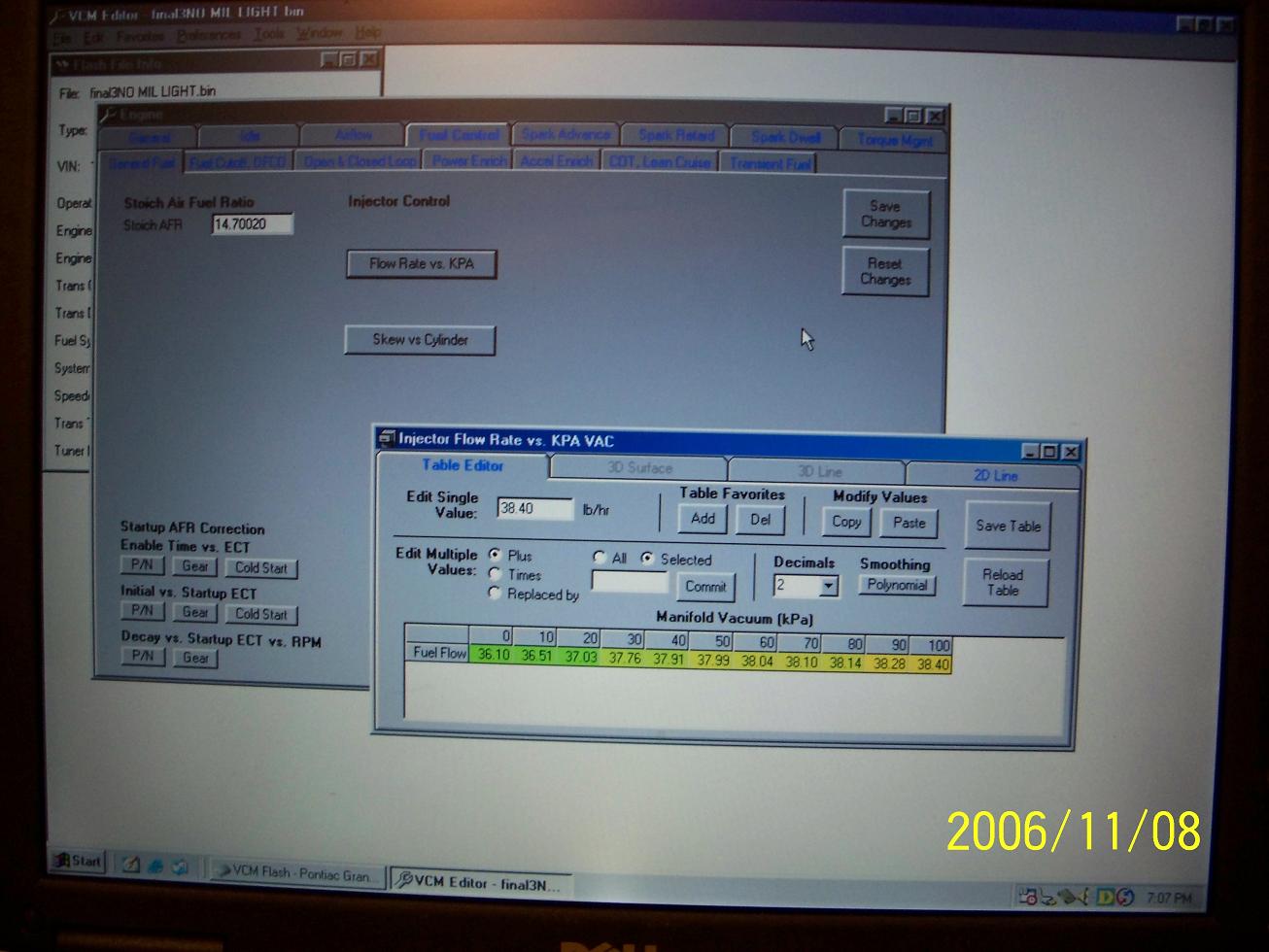

For one important thing... if you are running a 4T65eHD automatic on the 3800sc, you are running OBDII.... you need the PCM to shift the transmission...
While it was commented as BS to the tables in OBDI vs OBDII user interface, you should get yourself TunerCat and the definition file for OBDI, and then get yourself HPTuners..... open the tables up and decide what is 'right' in tuning the IFR to work with a mod'ed 3800sc... I can see if you are completely stock in a 3800sc and you get a OBDI setup to start the engine, and get down the road, then fine. Its not for the 'performance' side of things for the S2 and S3 engines..
I have the table screen shots on this ( ok, I cannot find them however ), as I do have TunerCat, HPTuners, DHP PowrTuner, EFILive, and even two of GM's software tools.
There are 4000 plus parameters in the OBDII PCM. Do we need them all? NO.... We need the important ones that are fuel management, and we need the ones for the automatic transmissions.. The issue is that we as tuners with all these nice software tools do not have access to the whole PCM tables and switches. HP Tuners brags that they give you 200 there about parameter changes. 200 out of 4000? Wow, what are we missing. Well, I know for a fact that DHP version 1 PCM's have parameters adjusted for shifting a 4T65eHD that neither HPT nor even PT allow the consumer to change. How did DHP do it then? They have CalTools and the definition files for the 3800sc's. They can see the 4000 plus parameters, and they do not offer to change all the necessary ones for people. I managed to hack the version 1 PCM, and even duplicate it now if I wanted to. I can reset all the things that they disabled so the BIN was useless to others if you did manage to download it from the PCM.
I could write a book on all this, as I have studied it extensively. It not only takes 100's of hours to learn, but 10's of thousands of dollars. I have in tuning/hacking software and hardware about $20k.... I have programmed about 150 PCM's since I started April of 04... Wow, at $125 times 150 PCM's is $18,750.... I finally break even maybe next year..
Oh, please do not confuse the level of programming I am referring to at 10's of thousands of $$$$$... it is far more than just buying HPTuners and opening your BIN file in the editor... is it really needed ? No, guess not for most people.
Well, that is about all I have to say about what is better or whatever.. it usually comes down to your pocket book in the end... do you want to spend the $$$$ for performance and learning, or just get the thing running and driving...
Ok, I was done but I have just read some more of this thread…
You cannot use the parameters from the OBDII tables to the OBDI tables… Zero… no way… The IFR adjustment is completely different between them.
The TUNE…. The Calibration is the correct word. The fuel management vs transmission management is the 2 goals… It’s a powertrain.. I don’t care if you are running a manual transmission, you need to have a calibration that matches a clutched application. It has come up about ….. My 3800 dies when I push in the clutch… Tim was right on about the IAC… it is the problem. He was right about the VSS, but VSS does just a little more than let the PCM know what speed to display on the speedometer, and control IAC…
OBDI does NOT have a true IFR table. You use the MAF to spoof the injection fuel rate. Well, now the problem is the S1 MAF is rated/programmed at the OS level to 10400 hertz. Oops…. GM changed the sensor on the S2 engine/throttle body to read up to 11,500 hertz, and I now know the code at the OS level is different for the temperature algorithm of the sensor itself…
This all gets to be to technical and becomes a who cares when you cant understand what the PCM is doing for an engine. You needed to tune carburetors for about 10 years and fight those darn things every time the temperature swing 20 degrees from whatever you tuned it at on that given moment. I worked at Haltech Electronics in 1992 to 1994 helping them with the development of EFI on motorcycle engines. Read this nice article if you never happen to see it on my website http://www.fastfieros.com/haltech_efi_relationship.htm
No where in this posting did I say you ‘have’ to run OBDII to be the best at the tune that is right for your S2 or S3 engine. But it sure would be easier for the PCM to run the engine and make adjustments to the weather, altitude, and that darn fuel we have to live with at the pump…
Ooops... I was wrong about the hertz on OBDI.. I have corrected it...
Ok, now I know why I was a little wrong about the hertz... I had forgot the OBDI starts at 2k.... the OBDII starts at 1500 Hz...
I have the screen shots with my camera now.. toooo many laptops around here with all these software tools scrattered out....

If you are using a 4T65-E HD trans, and you want the computer to properly interface with it, then you must run an OBD-2 PCM.
As far as performance is concerned, I haven't found any evidence that suggests OBD-2 is capable of allowing an engine to perform better than an OBD-1 system. I am aware that comparisons have been made as to how many parameters can be adjusted between the two systems and how some of the functions and calculations are made differently between the two systems. But you need to keep in mind that more isn't always better. Consider this fact: There are plenty of sub 9 sec Turbo Buick V6's running around out there on the stock 87 or older ECMs that use a 4kb chip. Yes, these cars are streetable. (late OBD-1's are 64kb and most OBD-2's are 512kb's).
Specifically talking about OBD-1 vs. OBD-2 concerning the 3800 Series II engines, it is all going to boil down to what trans you want to use and what your tuner's experience level is as well as a couple of other minor things. For instance, the only real-time tuning option out there right now for the 3800 will ONLY work with the OBD-1 systems. I expect a real-time tuning solution to be released for the OBD-2 systems within the next couple of years, but understand that it will come in the form of a butchered PCM which will be expensive due to hardware costs. Currently there is a real-time tuning solution available for the OBD-2 based LSx PCMs and the cost of the hardware alone is $489.00 not including the work to install it into your PCM plus the cost of the tuning software. If you are using OBD-1 you can get online with real-time tuning for as cheaply as $175.00.
Now some people are trying to make hey out of certain limitations they say OBD-1 has. Well there are some limitations and here is what they are... First off, the OBD-1 3800 PCM's are OS (operating system) software limited to a 6400rpm rev limiter. Currently, it can be disabled, however. However, as more research is done into the source code for the OBD-1 systems it is likely a fix will be found for the rev limiter limitation. The OS in the OBD-1 systems will also not support a 4T65-E transmission because there is no output control in the software for the 65-E's pressure control solenoid (PCS), nor is there any on-board driver capable of controlling a PCS present in the OBD-1 PCM.
Now concerning the injector calculations and MAF tables, I have never had any problem tuning ANY 3800 Series II SC or Turbocharged engine with an OBD-1 system. You just have to know what you are doing and have some experience with OBD-1 systems. The MAF sensor reading capabilities of the OBD-1 PCMs have a slightly less window (or range) of operation than OBD-2 systems, however, this can easily be overcome by the use of a larger (or recalibrated) MAF sensor and/or use of an aftermarket MAF-tuning device. OBD-2 systems have been shown to reach the limit of their capabilities concerning the stock MAF sensor on modded engines so keep this in mind as well.
One product on the market right now that is showing great results is the MAF Translator Gen II and PRO. These MAF tuning devices intercept the signal from the MAF and alter it before sending it out to the PCM according to settings and wideband O2 sensor inputs to the MAF Translator unit. One very exciting thing it can do is provide your engine with whatever AFR you specify (say a 12.0:1 AFR for example) at WOT and it will automatically do what it needs to do to the MAF signal going to the PCM to attain that preset AFR regardless of conditions. The PRO unit can even operate in speed density mode and work with up to a 5-bar MAP sensor (IIRC).
Now concerning the manual trans stalling issues, I have completely fixed this issue with all of my OBD-1 chips. I found a table in the stock OBD-1 programming that is called "Command Air Flow". Basically what this table does is tell the PCM what the airflow should be to the engine at closed throttle based on RPM and current gear. Correct adjustments to this table have proven to smooth out idle surge and eliminate stalling issues experienced by some people trying to use manual transmissions with these computers. I am 95% sure the OBD-2 systems also have a table similar to this, but I don't think the tuning software that is currently available has this table defined yet, which brings me to my next point...
I own TunerCat and used to own DHP Powrtuner. I have also used HP Tuners. The makers of DHP and HP Tuners cater to people who own vehicles with original equipment engines. This means they don't really cater to people who have engine or transmission swaps and personal experience has proven that they don't like to support such platforms, therefore the software development they have available isn't geared toward swappers; at least not in a primary sense. Tunercat on the other hand has outstanding customer support and even has a piece of software available that allows you to add/change parameters to their OBD-1 tuning programs! This means that if you got ahold of some disassembly code for the OBD-1 3800 you could add any tables you wanted to, to their tuning program. HP Tuners nor DHP officially supports or allows the end user to alter their tuning programs in this way. This means any "additions" you want to make to their tuning program is going to amount to an illegal hack of their copyrighted software. Of course if you want to stare at hundreds and thousands of pages of hex code and make changes to the programming just using a basic 3rd party's hex editor, then that can be a legal option for you.
Bottom line here is OBD-2 isn't necessarily better than OBD-1. I have been tuning factory GM OBD-1 systems since 1998 and OBD-2 systems since 2004. Each system has it's pros and cons, but to say one system is better for engine performance than another is hogwash. Again, there are street-driven turbo regals out there running 9 sec and faster in the 1/4 mile on 80's computers that used 70's technology.
-ryan

Report this Post11-09-2006 01:58 AM Click Here to See the Profile for darkhorizonSend a Private Message to darkhorizonDirect Link to This Post
the whole reason I was posting so much on this was to get a straight answer out of you Ryan. I dont like talking about things that I dont have hands on experience with.
I totally agree that the obd2 tuning packages are not to flexable.
I really want to know if it is possible for the average weekend warrior can do accurate VE and SD tuning with limited software and hardware on obd1. HPtuners makes this quite easy, with any number of upgrades, and power tuner isnt to far behind. I had suspision that the maf sensor was missing some of the resolution availible on the obd2 system also. I agree that there are ways around it, but hey I can say thats an advantage right there.
I still really want to stand by my statment that stock obd2 on a stock l67 offers a better, and or more robust out of the box tune compared to a modified obd1 conversion.

Report this Post11-09-2006 03:52 AM Click Here to See the Profile for Darth FieroClick Here to visit Darth Fiero's HomePageSend a Private Message to Darth FieroDirect Link to This Post
I don't want you to misunderstand my views on OBD-2 systems. They work well for what they are supposed to do. But you need to understand that the programming in the OBD-2 systems is 8 times larger than the OBD-1 systems because there is a lot more emissions and subsystems BS existant in OBD-2 systems than there was in the OBD-1 systems. Perhaps that is why there are many more parameters to adjust in the OBD-2 systems vs. OBD-1.
Concening your comment about out-of-the-box tuning, you are probably correct. For the inexperienced tuner, it would be easier to tune an OBD-2 computer with a 96-up L67 vs. trying to learn how to do it form scratch with an OBD-1 system. However, don't misunderstand; if you have a radical application, no matter what computer system you are using it is going to require quite a lot of time to tune in just right. I have learned a lot about the OBD-1 3800 PCMs, probably more than most people. I have a copy of the source code and I am constantly adding tables and tunable parameters to my tuning software so I can make more changes to the chip program. Would most people need all of these extra tables I have added? Probably not. But I am just pushing the envelope with this system to see how far it can go and what it can do. What's really nice is when you have an emulator and can sit there and make changes in real time that take effect immediately. Talk about instant gratification!
Now concerning all of this talk about mail-order chips and what not. Let me tell you something. ANY mail-order tune/chip probably isn't going to be perfect on the first try. However, simple tunes like removing trouble codes and changing a few settings shouldn't give experienced tuners any trouble. I'm sad to say there are pleanty of people who have gotten mail-order OBD-2 PCMs from various vendors and aren't happy with them, and these were pretty straight-forward, lightly modded applications. I know a few, personally. I could understand if the application was much more radical, since I do mail order chips (and OBD-2 PCMs) and know how hard it is to get a tune right, espeically when you can't tune on the car in-person. But even then, it isn't impossible. A little scan data goes a long way, which is why I pretty much make it a requirement for all of my customers running mildly to highly modified applications. The key is getting the right scan data during the problem areas of engine operation so you can see what is going on, or going wrong. Something to keep in mind is the more mods and the more radical of mods done to the engine, the more attention that is going to need to be given to the tuning. Most vendors don't like to spend a lot of time on any one customer. You would think for the money they charge for a custom program, they would. But I'm not one of those guys.
