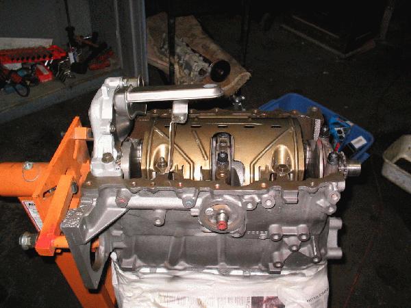

Report this Post08-17-2003 10:55 AM Click Here to See the Profile for brysonSend a Private Message to brysonDirect Link to This Post

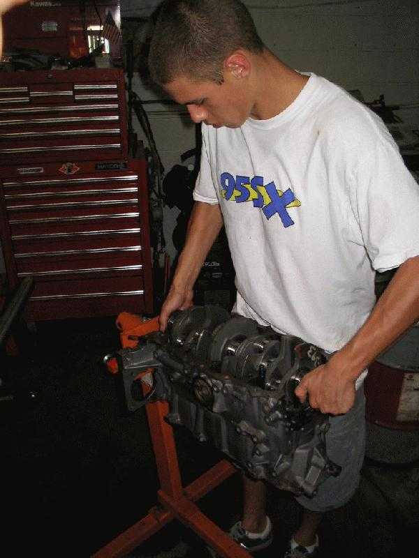

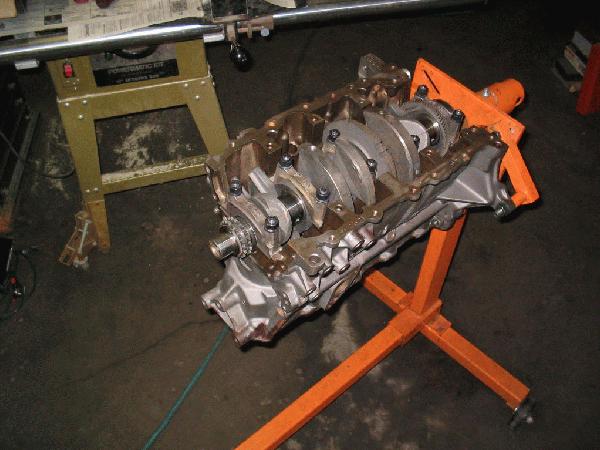

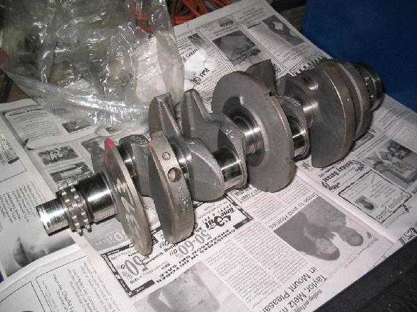

Hey everyone, I've been collecting parts and whatnot for a long time now, so it's time to start putting things together. I have some pictures of my progress (what little there was) from yesterday, and I'll take pictures when I work today. Here is the bare block:
the crank:
into the block:
88 Fiero GT Quad4 Turbo...It has begun

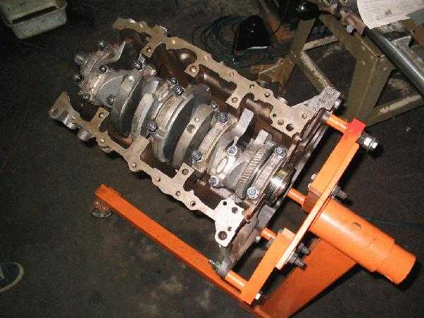

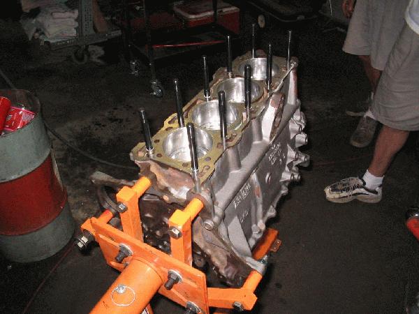

Report this Post08-17-2003 11:00 AM Click Here to See the Profile for brysonSend a Private Message to brysonDirect Link to This Post
Everything bolted down:
According to ARP, you have to cycle through the torque sequence 5 times!! I started them all at 40, and went up 5 ft-lbs each time. VERY time consuming, but it will all be worth it. I will post pictures of the turbo, intercoolers, ECU, and whatever else I can find that might look cool. Well, I'm off to do a little more. I'll list all the mods later.

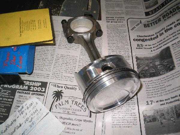

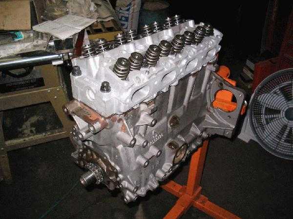

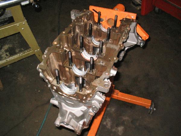

Well, I only had to go through the torque sequence 3 times with the main cap studs, but 5 with the rod bolts and 3 with the head studs. Anyway, more pictures are in order! My pistons (From the angle the rods look really small and the pistons really big, but they are proportional I swear!):
The rods and pistons where they belong

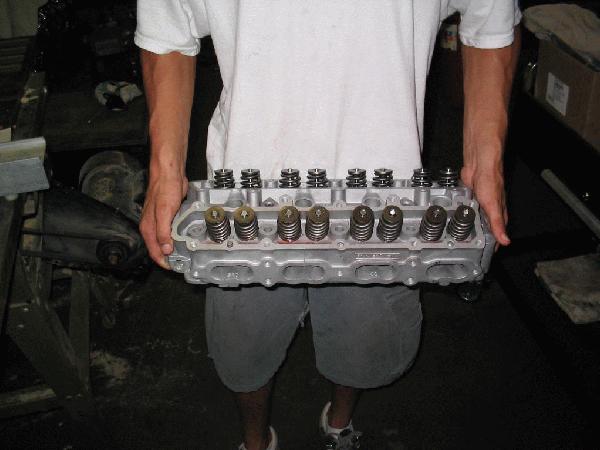

The head (ported exhaust -- quick job):

Report this Post08-17-2003 10:56 PM Click Here to See the Profile for brysonSend a Private Message to brysonDirect Link to This Post
bryson
737 posts
Member since Sep 2002
Anyone who has EVER put the O-rings in an O-ringed block understands how much of a pain this was to learn how to do. By the second or third ring we got it going pretty well:
Head studs:
The head all torqued down:
That's as far as we got today, I hope I can do a little tomorrow after school -- I get out at 9:50 until my other classes start. I'll keep everyone posted!!

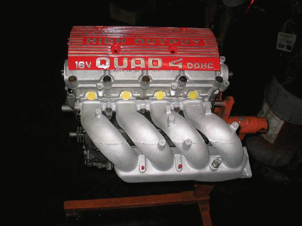

I'll list the parts in a second, but I need to vent about my day first -- I apologize. Well, today was frustrating to say the least. I went to put the spark plugs in just to keep crap from falling into the cylinders, and the last plug I went to put in has crossthreaded threads. This is a problem, becuase the head is already on the block and everything is torqued down right. I figure I'll tap it out with wheel bearing grease, vaccuum it out as best as possible, and hope for the best. Next, I decided to try the cam towers. Well four of the holes were stripped, so I figured I would helicoil them. I was kind of in a bad mood, becuase I had been out all day and hadn't gotten a thing done. The helicoils (of course) didn't work, and its 8:45. Good night. I was going home becuase if I worked anymore on the engine I would probably kick it to death or something. Anyway, I was walking to my car trying to keep upbeat becuase thats just one of my things I try to do, and someone stole my radio!! My friggin radio!! A $300 VW GTI! Who does that?! Ahh oh well. Yeah they took my change trey too, with my lug nut key! Anyway, I've cooled off a good bit. I guess things could be worse. They didnt break my window, and they didnt tear up my dash (except the main plastic piece which they broke in half).
Sorry for the rant, everyone. A pizza in the oven should be a nice cure-all. Anyway, CaddyRob, the list off the top of my head goes like this:
ARP Head studs
ARP Main cap studs
ARP Rod bolts
Rods polished and shotpeened
Ross Racing 8.5:1 pistons
Total Seal rings
Si stainless steel valves
LS1 valve springs
Custom grind cams by Engle: .430" lift and 232* @ .050" (maybe larger, but I don't remember and I know they are at least that large)
Exhaust side of 086 head ported - gasket matched the roof
T3/T04E turbo: 60 trim compressor wheel, .60 A/R ratio compressor housing; Stage 3 turbine wheel, .63 A/R ratio turbine housing; coolant and oil cooled
twin intercoolers from two 88 Ford Turbocoupes, modified endtanks and boost tubes
custom I/C piping
HKS Sequential BOV
ducts from side scoops directly to I/C
decklid scoop to vent engine air
Electromotive TEC3 stand alone engine managment system
850cc injectors
Custom header
3" exhaust, (dual mufflers?)
--If I forgot anything, I will post it later.

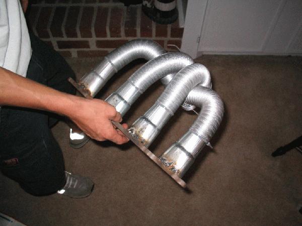

Report this Post08-20-2003 11:48 PM Click Here to See the Profile for brysonSend a Private Message to brysonDirect Link to This Post

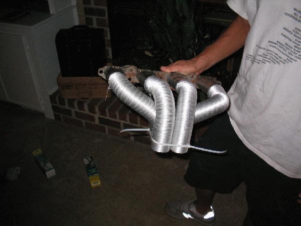

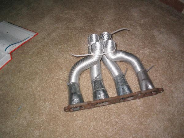

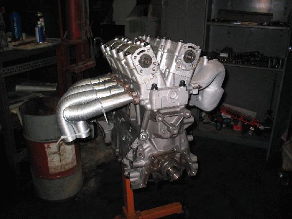

Well, I mocked up a header tonight. It's nothing special, but I think it will do the job quite well once I get it done nice. Here are a few pictures:
Also, standard, if you happen to read this, what is the clearance between your exhaust port and the trunk wall? Thanks,
--Bryson

Any idea how will that flex-tubing hold up to being a header? I've heard that it's not that heat/stress friendly?
I don't think he's going to use flex tubing

Hey! Fierobsessed: I did think about using the cast manifold, but I don't know where I can find a cast flange of some sort to weld onto it. I hope I would have room, but the turbo may need to face more downward becuase I am running a somewhat large T3/T04E. Also, the head for the HO quad4 that has a casting number that ends in 086 is the best head out there. Ported 456 (I think that is the correct casting number, the other may be 753) heads are starting to reach what the 086 flows. I don't know if you're very worried about it now, but I figured I'd throw it in. Any more information on how to use the stock cast manifold would be great! Also, it's funny you throw in the DSM engine; my friend has an Eagle Talon TSi with a big 16g turbo and my other friend has a 2g GSX with almost the same turbo as me, and we all kind of compete with each other (although nobody admits it )Thanks,

Report this Post08-21-2003 12:26 PM Click Here to See the Profile for StandardClick Here to visit Standard's HomePageSend a Private Message to StandardDirect Link to This Post
086 is the best head, with the 753 being next best.
I have quite a bit of clearance between my manifold and trunk wall. Not sure of the exact amount...
Most people on the Q4 list use the LO cast manifold, and cut off the runners so they can weld onto it.

We have a LO manifold on the way, but if the cast iron would work as well, we may use it. If we make headers, we also have to make a bracket for the turbo, but that's not a big deal. Cast iron would be stronger, but the possibilties for different designs are endless so I could meet many space and airflow requirements. I'll keep everyone posted with what goes on, but I'm guessing that today I'll probably just put the cam towers on (and maybe the oil pump, baffle, and pan). Thanks,

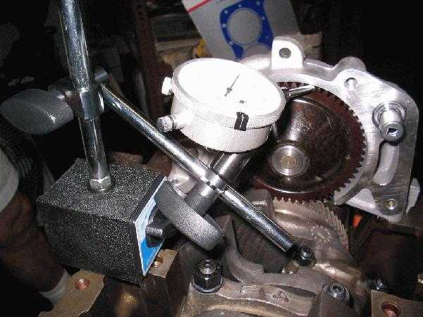

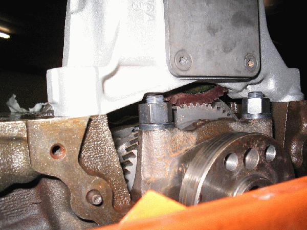

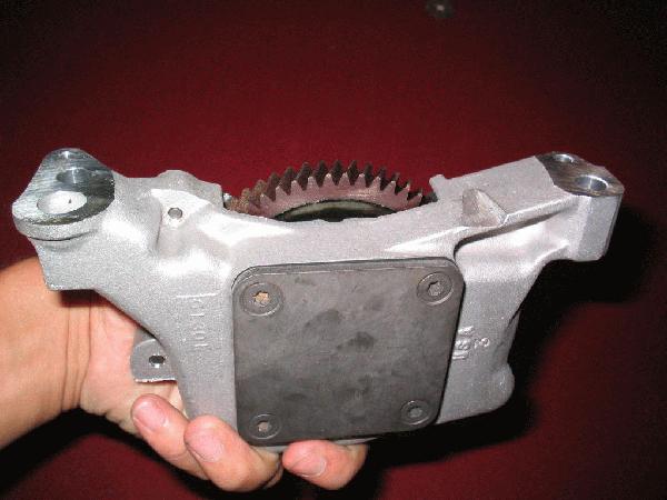

Well, we've been slow for a few days as I got started with school, but I'm working whenever I can. The oil pump didn't fit on the block becuase of the main cap studs, so I had to notch the pump housing:
The shim had to be cut as well, becuase it also interfered. For anyone interested, here is a picture of the dial indicator set up to measure backlash between the oil pump gear and the gear on the crank:
That's all I got done today, but hopefully I can do a little tomorrow after school. Oh, by the way, I got the cams in, but the pictures got lost, so I will try to find them.

Didn't post last nigth because I didn't get home until 11:30 from the shop, but here'e basically what we got done:
Take it easy
Man, Quad 4's just look SOOOOOOOO BADASS with that silly beauty cover removed... Like an F1 engine from says gone by... or some other kind of old school pure race engine.

Originally posted by Xantavar:
Nice buildup. Was the 90 HO in your sig the donor for the buildup?
Sure was! Maybe I need to specify in my sig that that is a donor car and that the formula is a parts car. The Olds was SUCH a nice car, I hated to pull the engine out! It came out in only a couple days becuase there was NO rust, no stripped bolts, almost no problems! If you know anyone who might be interested, have them contact me. I'm selling the thing for like $400 becuase I hate to part out a car that nice.

Will, I love the way it looks too! I didn't want to cough up the extra money for the Electromotive coils and stuff, so I am bypassing the module and using the stock coils in the IDI cover. Later on I plan to switch to remote coils and run spark plug wires, Leaving the cam towers open to see!! The fact that it has the cam towers instead of one huge valve cover makes it look so exotic! Now I'm all excited and I have to go to class and wait until I can work on it. Arg...worse things have happened I guess. Thanks everyone for your interest! It makes it easier to do the work
