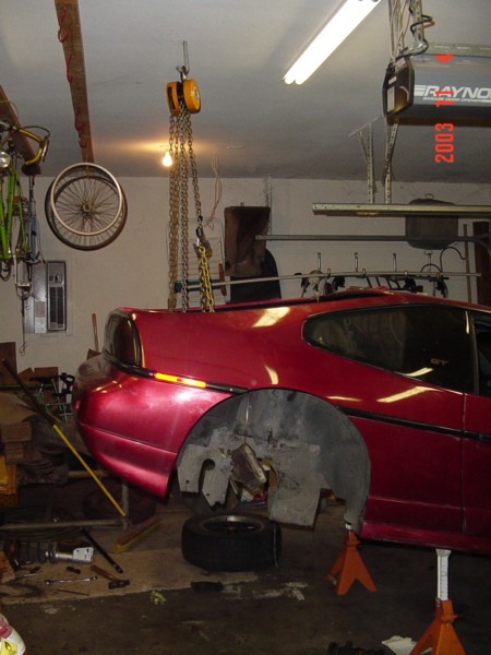

I' ve got 2" X 12" ceiling joists so I do it this way. I have a piece of 2" X 2" X 1/4" tubing laid across 4 ceiling joists with a 5/8" hook for the chainfall.
You can pick the car with a chain with a couple of hooks in the holes in the crossmember that goes across the top of trunk.
This also has the advantage vs. an engine hoist in that there is nothing to interfere with getting the dolly out from under the car.

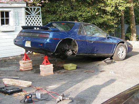

Two floor jacks and a dolly:

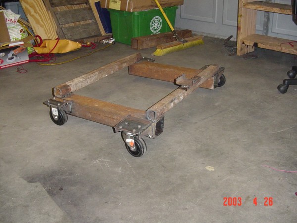

My version of a dolly:

Sorry but no way would i get under that !!!!!!!!!!!!!!!!!!! Floor jacks can and do tip over pretty ez, not to mention Ive had them rupture a seal and collapse in a second. It needs to have nice solid stands under it or supported from above by chains. I know your going to say youve done that a dozen times with no problem, but it only takes once to take you out permanently.
Whoever said I got under it like that? I most certainly never did. That would be stupid. I just jack it up and roll the engine out.
JazzMan
Hey JazzMan what r the dimensions of your dolly? I need to build one even though I still dont have a garage.
JazzMan
Posts: 18612
Total ratings: 653
Report this Post06-10-2004 11:13 PM Click Here to See the Profile for JazzManSend a Private Message to JazzManDirect Link to This Post
I don't remember off hand, though the length of the angles between the main members appears to be 27 1/2". I just measured the space between the rails on my cradle and had the shop cut me some scrap pieces that I then welded together. The '88 cradle has a nice flat bottom that makes this easy to do. An earlier year cradle will require some more pieces to mate the dolly up to it.
