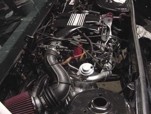

1SLO2M6 has spent many late nights re-assembling his car.. he and I worked out a valve problem and get her started last night... IT'S MEAN!!
112*, 448intake, 512 exhaust.. it seriously sounds like a harley.. -potato - potato- we haven't put the wheels on it to drive it to see if their is any vacuum for the braking system.. that'll happen once the suspension is completed.
can't wait to get the Power tuner on it and have her strapped down to the dyno!

he and I both ground and filed and banged.. and ripped perfectly good gaskets.. oh well it's just a tree... paper gaskets are crap. the TB will be a larger unit but not a stock holley one. we have a 64mm focus unit that we are going to figure out. we have also toyed with the idea of cutting the top of the pelenum and mounting it on the center of the pelenum with a hood scoop (like mine) for more air at 60% throttle and up... we kinda chickened out but now that it runs we'll get back on task... stupid fast stock block or blown up... either or it's worth the trouble! just casue so many claim the 2.8s are fragile crap... this will be the 4th one i've messaged balls to the wall and hopefully the 4th one to not grenade. we'll see.

gtsonly.. that cam thats in it now.. it's running 19# injectors with a BONE stock bottom end and factory ECM and E-prom (for now) we'll dyno it like it is then tweak it to the edge.
stay tuned for the cammin beast 2.8.

You'll have enough vacuum for the brakes. I just put a little bigger cam in my race car (.519 intake, .526, exhaust, 106* lobe seperation) and the brakes work fine. Doesn't idle worth a damn, though. Time to start computer tweaking...

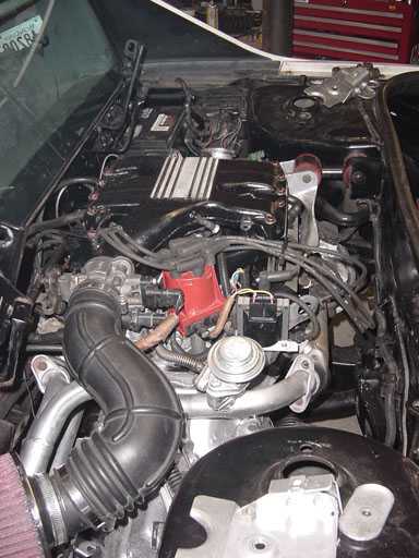

needed more spark to light the hella air it's gettin now... Crane PS91 coil.. (or Mustang 5.0 coil..) same thing.. 60,000 volts either way. notice the intake bolt change! and mysterious lack of vacuum hoses.

stock engine management now.. once the wheels go on and the exhaust is reworked the www.dynotuner.net Power Tuner will be tossed on to cut some of the fuel and to try to make it idle at anything less than the current 1800+
