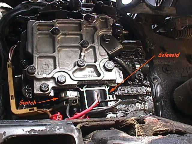

Just finished, It took an hour and a half to do the job. I believe it's a bit easier in a 2.5 than the 2.8, less obstacles to the end cover. Unless you need to change filters there is no need to drain the tranny, I lost less than a pint. I had just recently changed mine.

Report this Post05-10-2001 01:50 PM Click Here to See the Profile for WolfhoundClick Here to visit Wolfhound's HomePageSend a Private Message to WolfhoundDirect Link to This Post

WOW!! Thanks for the links and the image. It is sure to help. Guess, I know what my project is tomorrow.
