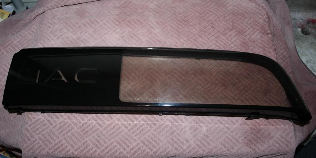

Did you spray the clear urethane after you unmasked the letters or before?

Did you spray the clear urethane after you unmasked the letters or before? |
I unmasked the letters first and then sprayed the clear over the lettering. It buffs out crystal clear so you never know there is clearcoat on there. Plus, I didn't want to feel any indentation where the letters are....just one smooth tail light. The only area that remained masked was the clear portion of the taillight. The reason was if anything ever happened to the clearcoat in that area, it would be difficult to sand off without damaging the lenses. This way with the lenses bare, you can buff out any scratches from the plastic without worrying about clearcoat.
