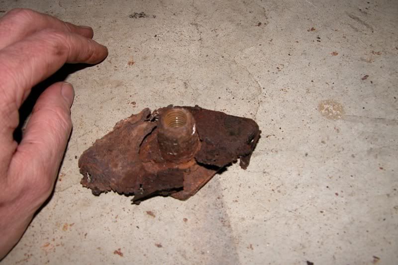

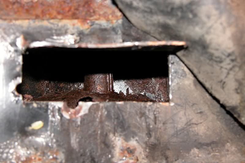

Todd, this is for your use in demonstrating how to cut into the frame to free those damn cradle bolts:
For those who have not had the fun of cutting into the frame to loosen the top of a cradle bolt, here is what the bastard looks like when it is out. I had to cut to get to each rear nut.
and here is how the thin metal in the frame holds the nut down -pretty flimsy stuff:

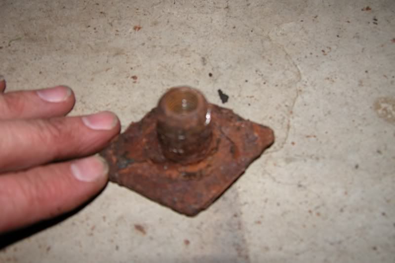

I had that problem on my Formula, I was able to remove the nuts without cutting the frame. I broke both rear bolts, then punched the nuts up into the frame and pulled them out the back. Then welded new nuts onto the diamond shaped plate and fished them back into place through the frame again. ------------------ www.FieroDomain.com "If any car is both the parade and the rain, it is the Fiero"

| quote | Originally posted by Xanth:
How did you break the bolts?
Xanth
JAN 04, 10:43 PM
| quote | Originally posted by Saxman:
How did you break the bolts? |
I should have mentioned, they broke when I tried to turn them. The nuts didn't actually break free in the cradle.[This message has been edited by Xanth (edited 01-04-2008).]
