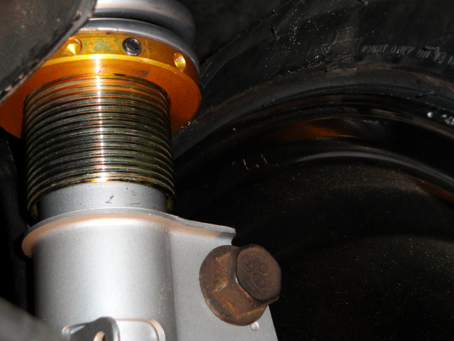

FinnishFireball AUG 20, 02:18 AM
Is this part of the stock shock removable?
