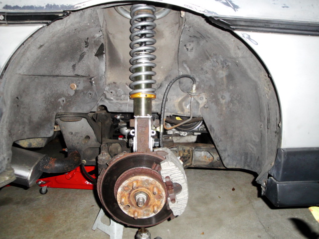

Here's how mine turned out
350# QA1 springs 12"
5" threaded sleeve
KYB shocks
HELD upper spring locators
Check out my build!
http://www.fiero.nl/forum/Forum3/HTML/000100.html

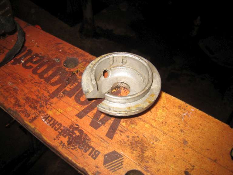

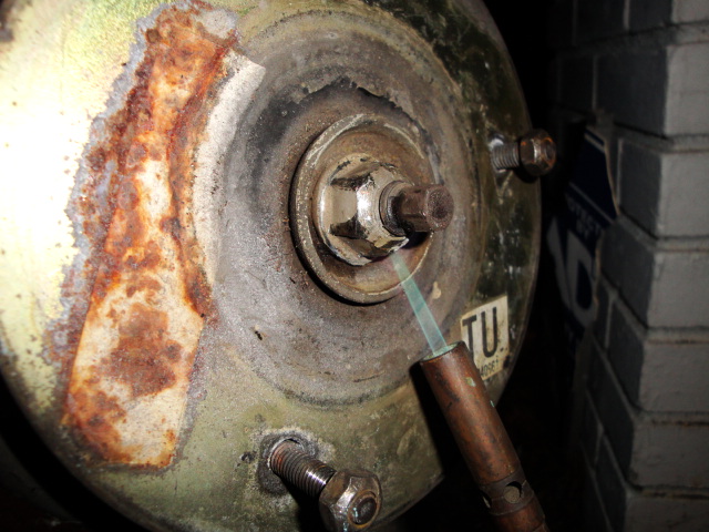

This is why you shouldn't use conical spring seats like this:
in such a way that the full weight of the car is supported by the strut mount bushing.
It's only intended to tolerate damping forces.
Look at the strut mount I took from my car with that conical spring seat setup:
It was ready to shear right through!
