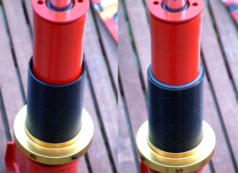

doublec4 JAN 28, 11:47 AM
For those of you who have done this,
When trying to make adjustments to the ride height, what keeps the threaded sleeve from rotating around strut body when trying to turn the collar?
Fie Ro JAN 28, 03:21 PM
With the car jacked up and the spring unloaded it should be easy to keep the sleeve in place...
But imho, it is better when its sealed to the strut..
Originally posted by Fie Ro:
With the sleeves installed I filled the gap at the top with sealant to keep water and debris out
- it also keeps the sleeve from turning
