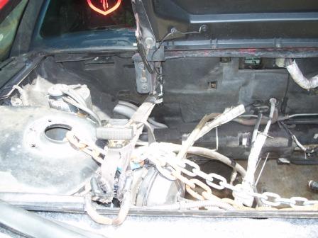

I just did both sides on my 87 GT with a 3800sc installed. Since the 3800 is in there I had to take off the stock parts take hold the decklid up. I put autozone part number 95053 on my car and it seems that every time I raise the decklid its putting way too much force on the vent brackets. Did I do something wrong? Or is this normal?
