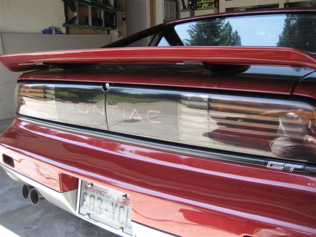

Well, you can't remove the black since it is poured in during the manufacture. You can paint the inside of the lens if you want to tint them but you can't remove the black portion just to paint the lens. Now if you wanted to do custom lettering like I did for my IMSA, you can remove the black and re-stencil the letters in black paint:
vrossiter MAR 13, 01:08 AM
So, you remove all the black out of the lens and then restencil the lettering, or do you just remove the lower portion and stencil the 'IMSA'? Have you put up a specific thread about this? How hard would it be to do only 3 letters below the PONTIAC with the split in the tailight? That is awsome, by the way!
