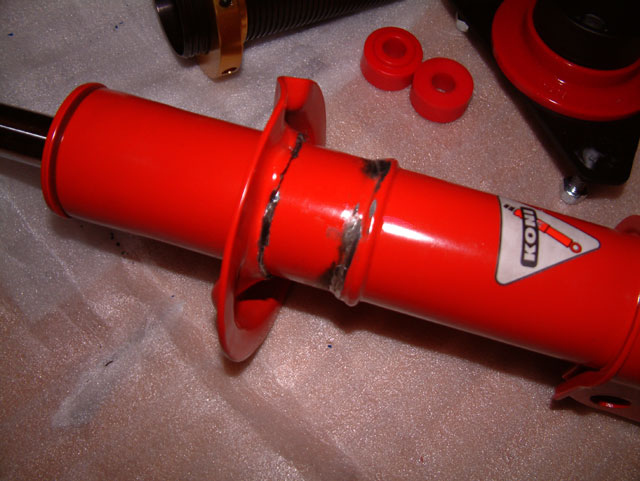

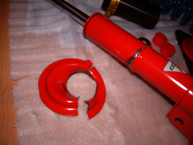

Didnt post the build itself but this may be usefull info when using Koni shocks. The perch is easily cut off with a grinding wheel:
Then you will find it will not slide off because the top of the Koni strut tapers a bit outwards:
 No problem. But this also means the inner diameter of the new sleeve is bigger than the diameter of the lower strut, so :
 My advice is not to cut too much off this ring because it helps centering the sleeve..

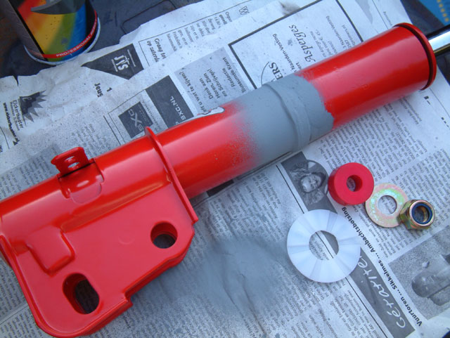

With the sleeves installed I filled the gap at the top with sealant to keep water and debris out
 Hope this helps..
