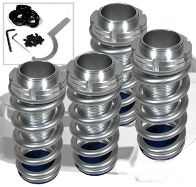

Is the length of the sleeves as critical for 12" springs as they might be when using shorter springs? I've got two 12" 325 lb springs here I'd like to try, and I've been holding off until I tracked down some suitable coilover sleeves.
So would ones like these do the deed, although I have no idea how long the sleeves are? Less than $42 including shipping. They're certainly inexpensive enough, especially considering there are enough sleeves to do two Fieros.
eBay item # 330381077459 ...
[This message has been edited by Patrick (edited 01-17-2010).]
couldahadaV8 JAN 17, 11:58 AM
That looks more or less like the kit I bought. It will work fine with 12" springs. You will find that the spring seat is around 2" from the bottom, so that length of threaded sleeve is good.
