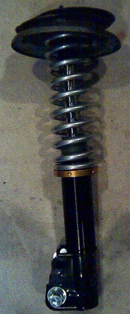

I bought my coilover parts from A-1 Racing Products
http://shop.a1racing.com/
I would definately use the 7" sleeve with a 12" spring. I bought the springs from Summit Racing
7" threaded sleeve: COK12455
$18.40 each
Coilover nut: COK12460
$12.87 each
Springs: QA1 12" progressive rate, 175-350 lb, part # 12-175-350
$49.95 each
Before:
After:
The above picture shows the 300 lb 10" spring I used first,it was far too stiff. I swapped it out with the 12" progressive rate spring.
