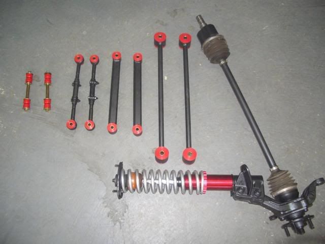

buds
OCT 03, 03:55 PM
Built mine a while ago thanks to this thread.
 ------------------ 1988 N* GT
