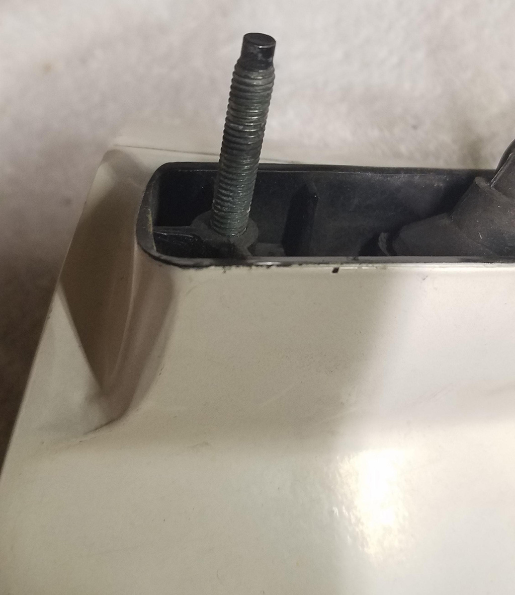

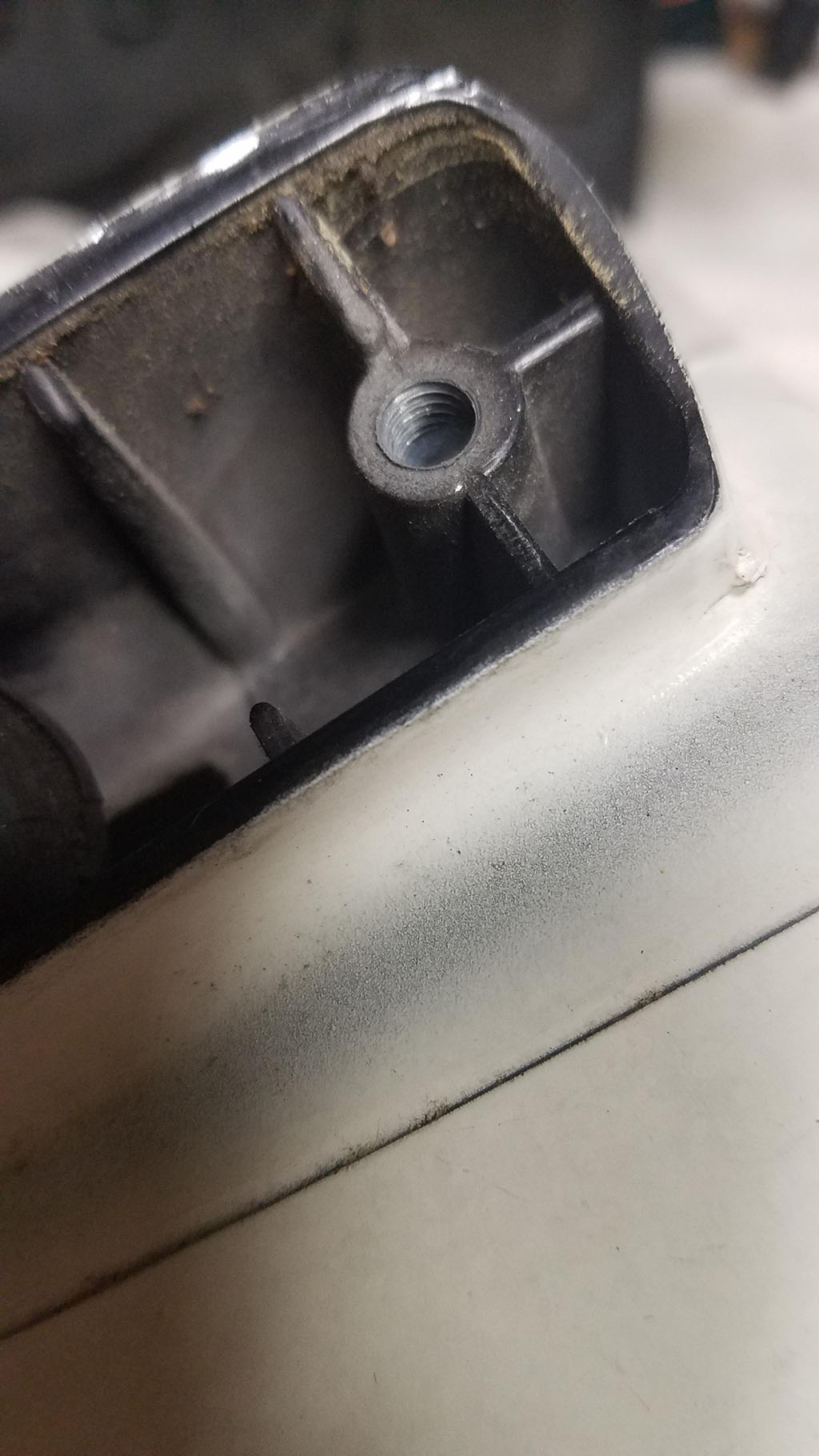

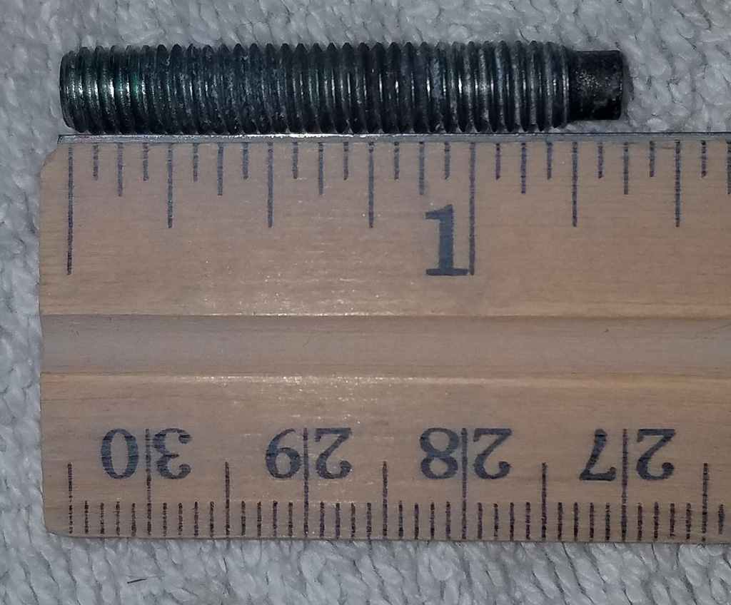

IMSA GT
MAR 09, 07:21 PM
| quote | Originally posted by SamanthaM:
Well, after looking at a picture online, it seems the studs are not on the passenger mirror.... :-( So, is it possible to just fix this one or do I need to try and find a replacement? |
I just went out and removed the stud from my mirror. I assume your mirror is simply missing the bolts....or are they broken off? Here is what they should look like:
I need to post a thread in General about this. I believe they are 6mm but I don't know the thread spacing.
SamanthaM
MAR 13, 01:37 PM
I need to post a thread in General about this. I believe they are 6mm but I don't know the thread spacing. |
They are missing on mine. Thank you so much, this is extremely helpful! I will head to the hardware store today or tomorrow and see if I can get two new ones!
