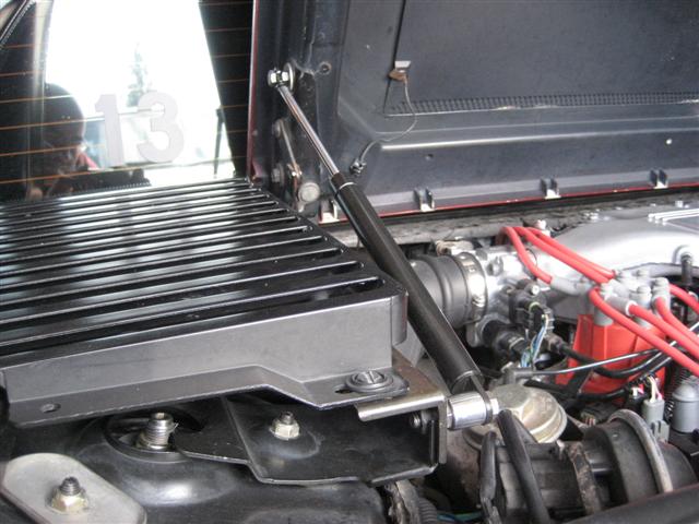

This is really one of the more informative writeups that we have at our disposal. Thanks to Chrismclubm, Dennis LaGrua, and Brian99 for the breakdown of the strut numbers. I personally used the Strong Arm Lift Support unit #4428 that I found at my local Schuck's. The writeup by Chrismclubm was spot on as far as how to do this fairly easy install. I have been using an adjustable rod for years now. Now, I have a shiney new lift strut. It has improved my life substantially. Life's possibilities are now endless.
I needed to take a pick of how I did this. I also thought that having a nut on the deck support would keep up the structural integrity. The way that I came up with also lets the strut rotate on the bolts so as not to cause the strut to bind.

My lift setup is similar but I preferred to retain the holding force of the rear bolt on the deck lid bracket.
I purchased a long bolt the same size of the one removed. Cut the threaded portion off and used this as a stud that screwed into the deck lid rear bracket hole. Then added a nut to secure the deck hinge bracket firmly to the deck. Then placed a washer, the strut end, another washer and finally a lock nut on the end of the stud and sized it accordingly.
On the other side I drilled a hole in the vent bracket and placed a bolt right through from the inside. Used a nut to hold this to the bracket (making it act as a stud), then added the washer, strut, another washer and lock nut on that end too. If this is not self explanatory I can post pics on request.

I used it to fashion the strut on my notchback, it fastens to the decklid the same, but I made a bracket out of angle aluminum and mounted it on the underside of the vent support.
