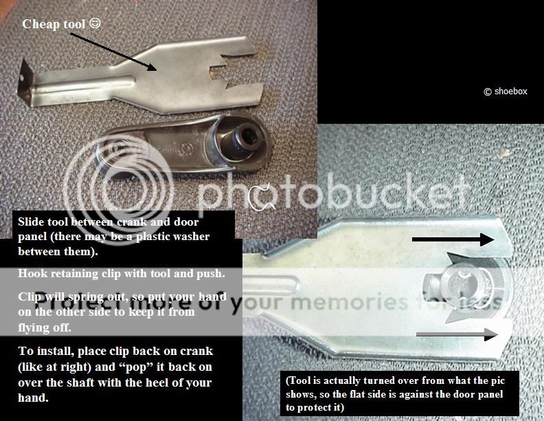

You can buy a tool for removing the manual window handles fairly cheaply... AND it also works great for removing the "christmas tree" puch pins that hold the inner dool panel in place.

Thanks to fierohoho, this saved my sanity this afternoon  | | | quote | | Originally posted by fierohoho: To remove a manual window handle you need to make a small hook out of a piece of wire or a paper clip, then just reach behind the handle as shown and hook the "c" clip and pull it off, you should then be able to wiggle the handle loose. |

Stupid question how do you put that back on?

You could always go to a local auto parts store or harbor freight store and get this cheap tool.
