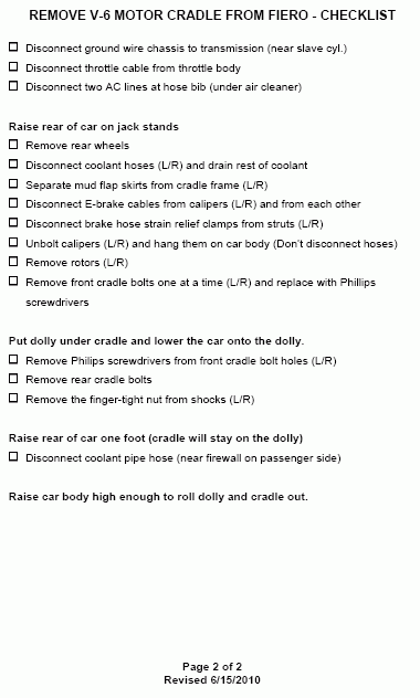

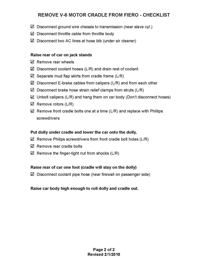

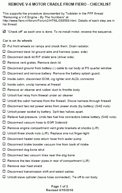

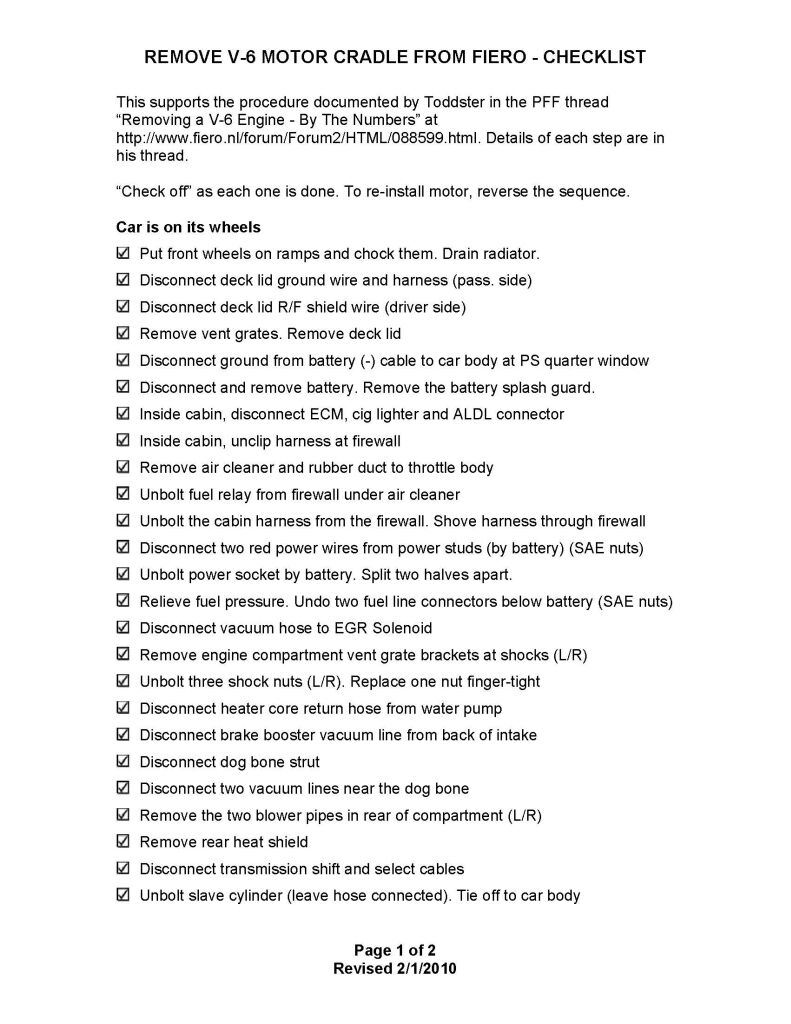

I am on my second go-round in pullling the engine. Toddster's write-up is excellent, but having done it before I didn't need the detailed instructions. All I wanted was a checklist to make sure I didn't miss a step.
I made these:
I have them as PDF files, so if you'd like one let me know (use PM) and I can email it to you. If you see something I need to fix let me know.
edit: I fixed a couple of mistakes and added a step - things that I discovered while using the list. edit: 2/1/10 I added one more step and named it revc. edit: 6/15/10 rev d.[This message has been edited by fyrebird68 (edited 06-15-2010).]
I made these:
I have them as PDF files, so if you'd like one let me know and I can email it to you. If you see something I need to fix let me know.
well done! This is handy for those of us with some experience

When removing the A/C compressor, I thought it was impossible (or near impossible) to get to those two compressor-to-bracket bolts? I thought the whole compressor/bracket assembly was removed at the same time?
I say "near impossible" because I had to loosen one of them to pivot my compressor, to loosen the belt - but it was a huge PITA to get to.

My AC was not charged, so I didn't remove the AC compressor. I just unhooked the two hoses under the air filter. If you want to maintain the integrity of the AC system, you have to tough it out.

On the A/C part, now that I read the posted pdf, there are a couple of routes you can go if you have a charged system and want to keep it that way. I would suggest this for keeping the a/c intact: Drop the exhaust and remove the assembly from the car. 2 bolts with spring tensioners at Y pipe, requires a 2' extension for the socket to make it easy. soak the bolts with pb blaster from the top first. then the hangers at the frame rails rear, With the exhaust out of there, there is plenty of room to get at all the compressor bolts. remove the clutch connector and the 1 or 2 pressure switch (depends on compressor type) plugs on the rear, then remove the bolts and tuck the compressor up to the firewall. the heat sheild brackets on the firewall are very handy for tying the compressor off and out of the way.
Also as a personal pref, if dropping the cradle I always drop the exhaust system and put it out of the way. it may be unneeded, but it's only 4 bolts, and allows much more access to the start wiring and a/c compressor.
