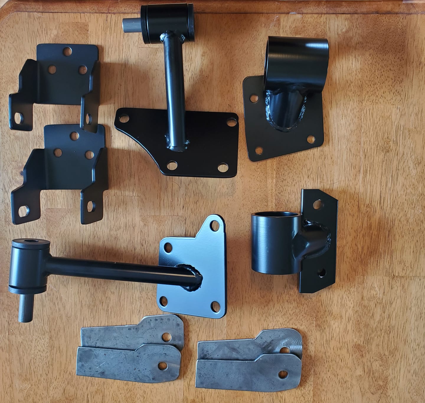

What you get: Upper head and trans mount 2 framerail brackets Firewall side mount Trunk side mount 84-87 gets a trunk & firewall side cradle mount bracket 88' get U brackets that must be tied into your cradle (unless you send your cradle in to be modified) Mounts come powdercoated black. Optional colors are available.
Bushing durometer 62A street (softest) 70A medium 88A hard 94A extreme (super hardcore)
Ordering: Engine k20 or K24 Trans k24 or k20 Midplate yes/no Additional U brackets yes/no Optional powdercoat color request add $100 and 2 week leed time for single coat powder. Bushing durometer 84-87 or 88 fiero
Current list 1. R.White k24, u70 additional U brackets. PAID 2. D. Webster pending 3. D. Williams PAID 4. M.Martin PAID 5. Slot held for my use

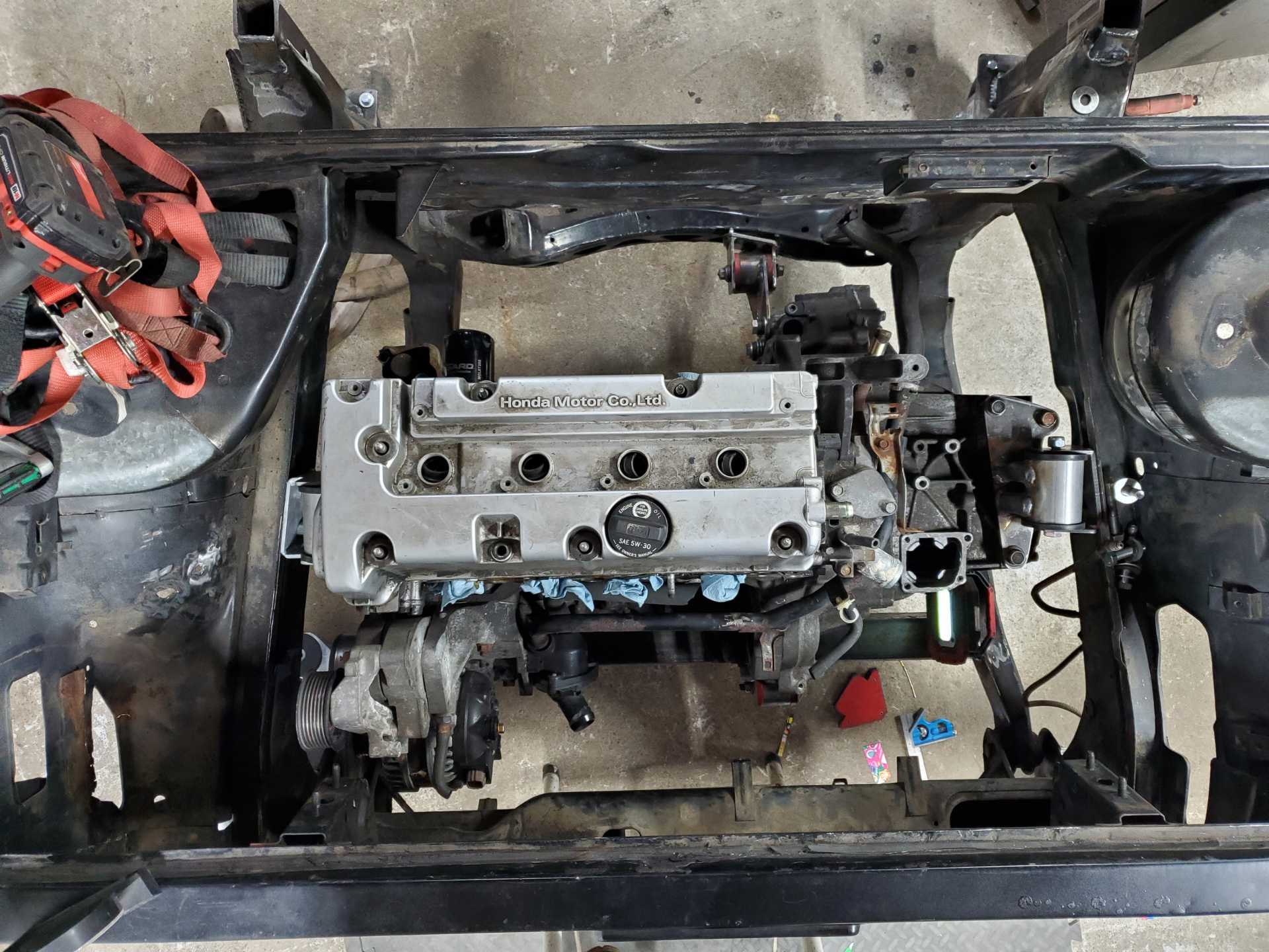

■■■ you MUST modify your engine cradle!!! My k24 mounts are based around a modified 88 cradle pictured below. You'll either need to send me your cradle for modification or do it on your end. I can supply additional U brackets to fit the bushings and then you tie them into your cradle I offer a modified cradle on exchange only. I have 2, 84-87 cradles ready to be exchanged directly as of 4/13/21.$165 to mod the cradle. Add $250 to have it sandblasted and powdercoated. I am still trying to figure out all the different combinations between Honda and Fiero. I'll do my best to make mounts for all the combinations. I need your input and feedback! Mounts are subject to change as I constantly strive to add more combinations and perfect the designs.

Honda k20 w/ ep3 5 speed mounts 84-87 Fiero
 [This message has been edited by BV MotorSports (edited 04-13-2021).]

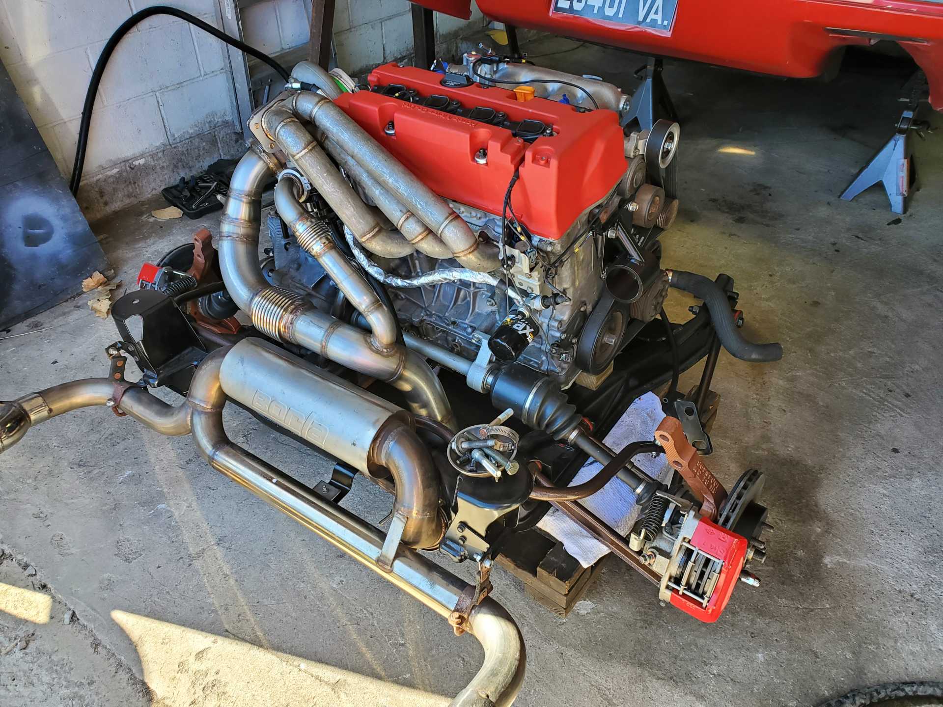

1988 fiero w/ TSX ver.1 k24 & 6 speed mounts have been redesigned, see below.
 [This message has been edited by BV MotorSports (edited 07-03-2021).]

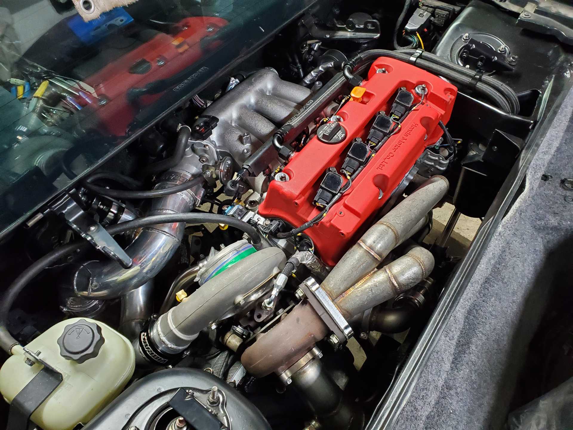

Installed

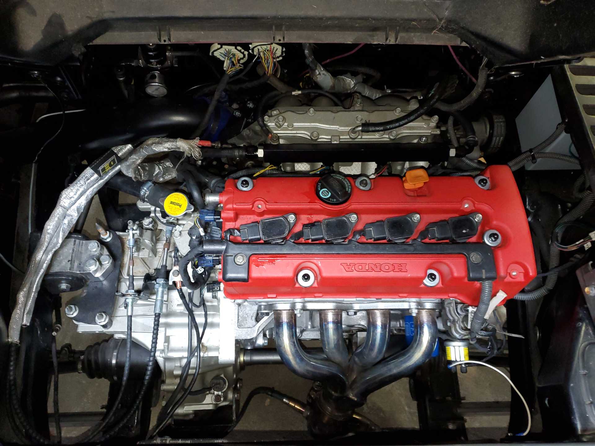

k20 installed 87 Fiero

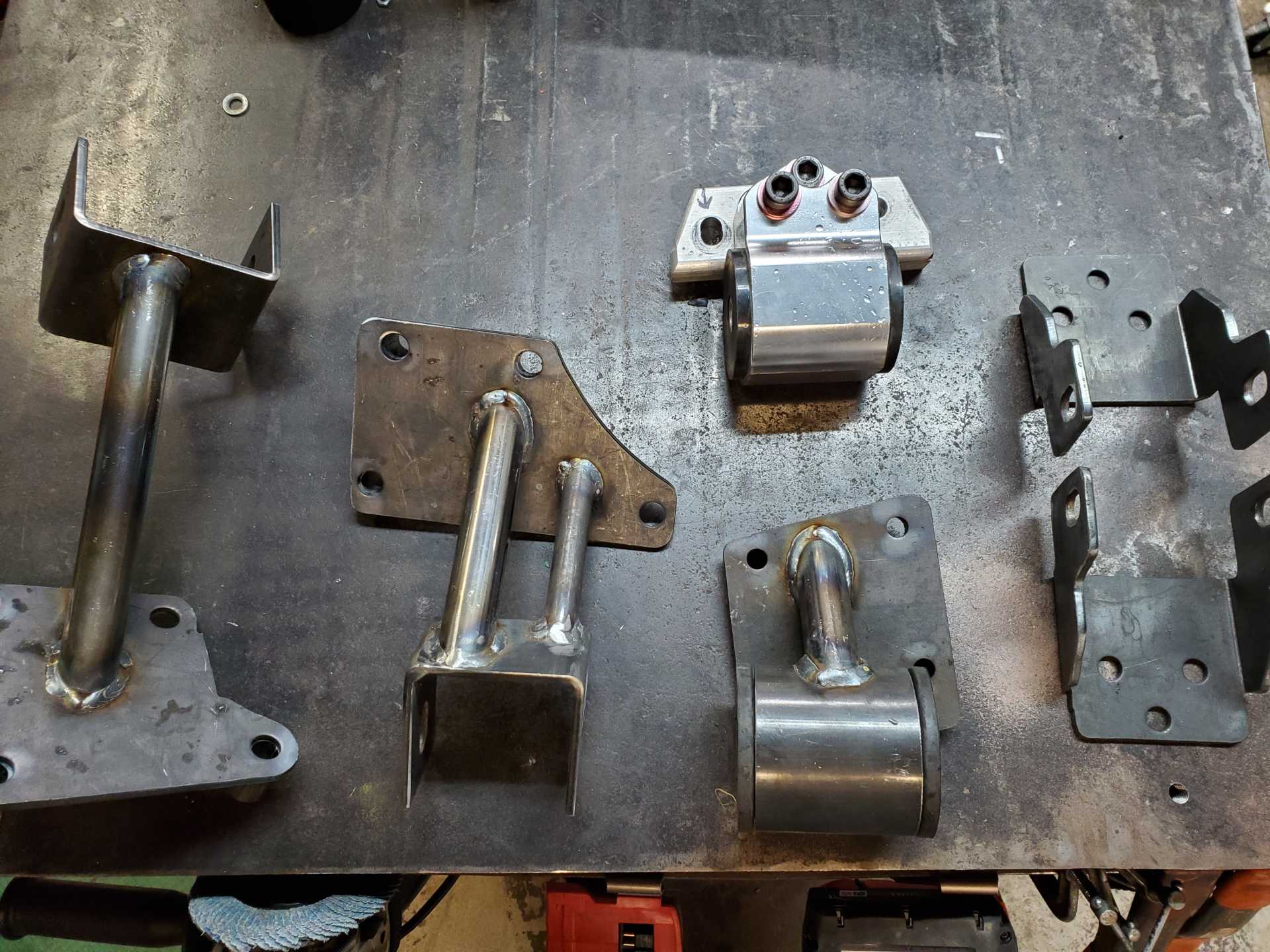

With how nice the k20 mounts turned out, I redesigned the k24 mounts to a similar style. 1st set of kFiero ver.2 k24 mounts are ready to ship! I just need to grab the bushings and pins for the large barrels. The raw finish plates are the "drops" the customer will have to shape, trim and weld to their cradle for the front and rear mounts.
