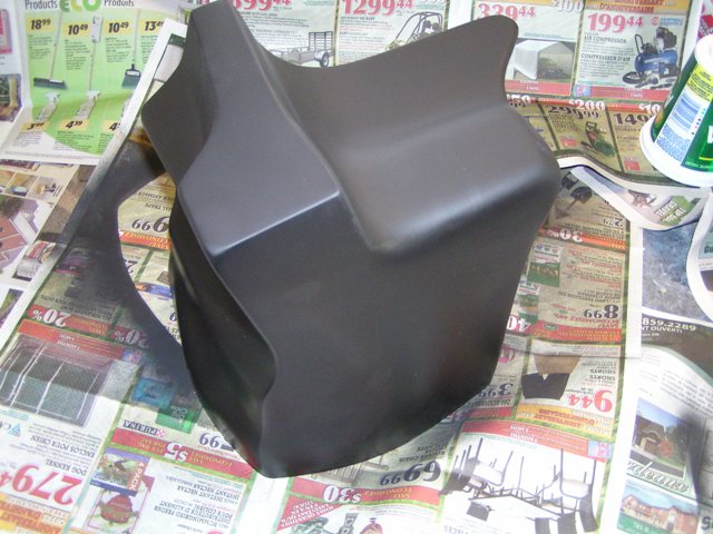

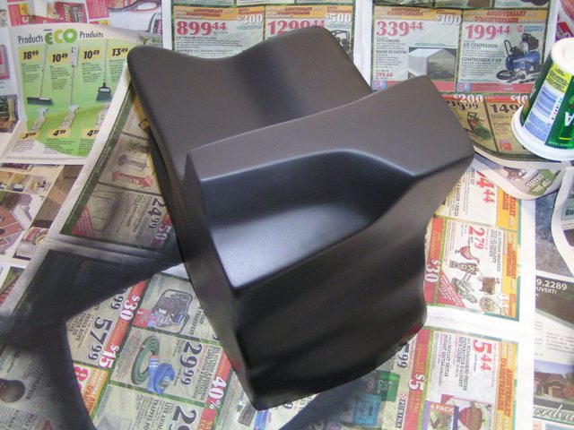

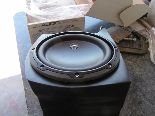

Sorry it took some time, but I now have some pictures! Here is our prototype:

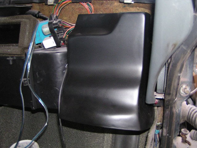

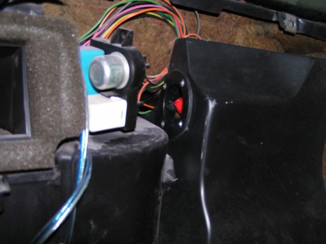

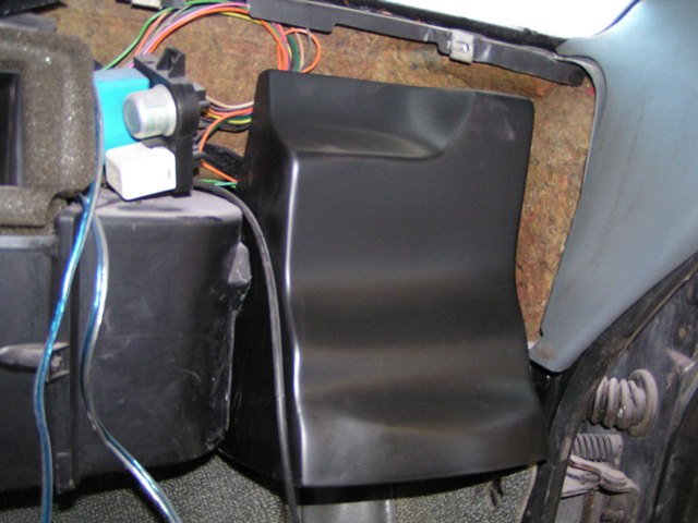

And here is the fitting (The fitting under the dash is the same as the red one though):

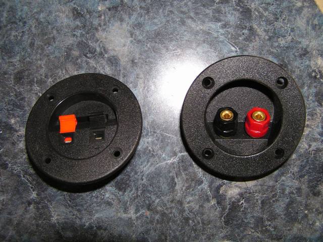

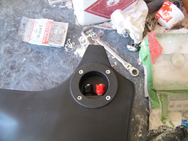

I've found the perfect spot to link the wires to pass them inside of the enclosure. I had the choice between those two connectors, one (On the left) is like a trigger push and the other one (On the right) is like a nut:
For this one, I've put the "Nut" like one:

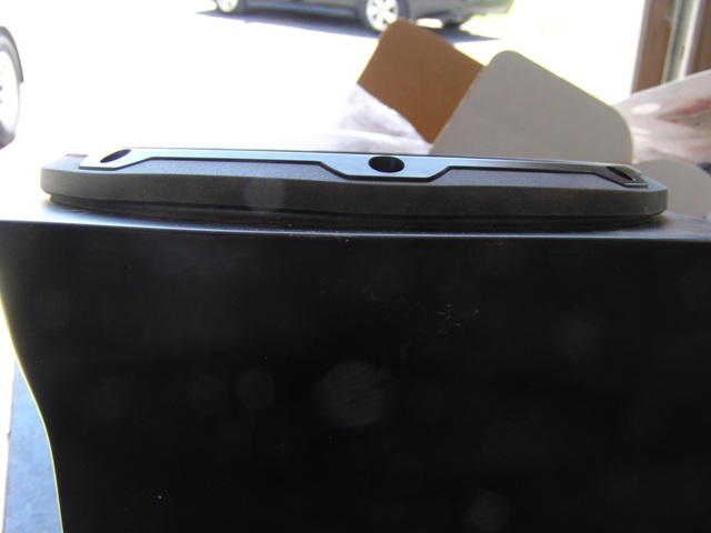

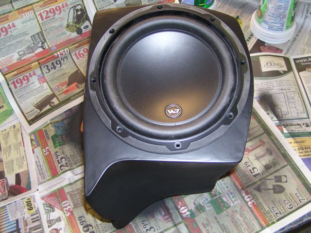

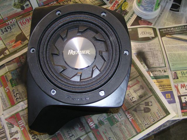

Here is both of the speekers installed in the enclosure:

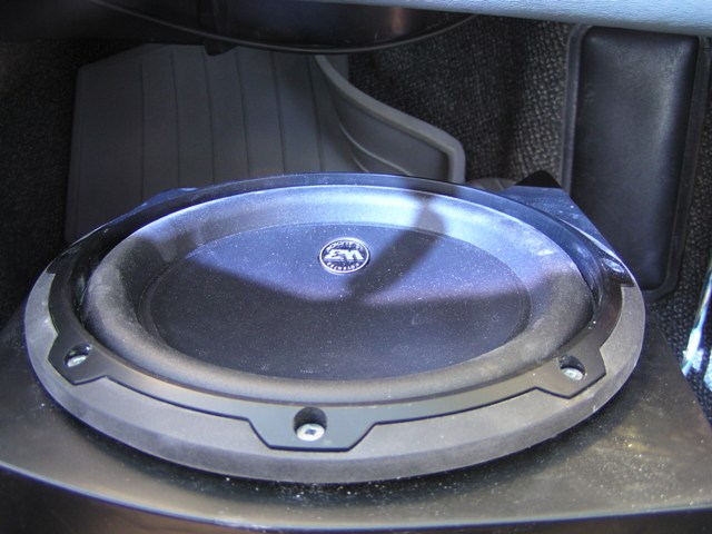

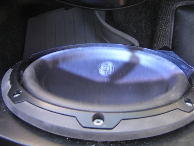

Now, Obviously we had to tried one of them! (Actually, we tried both of them and the enclosure surely sounds great!) Here are some picture of the JL Audio subwoofer:

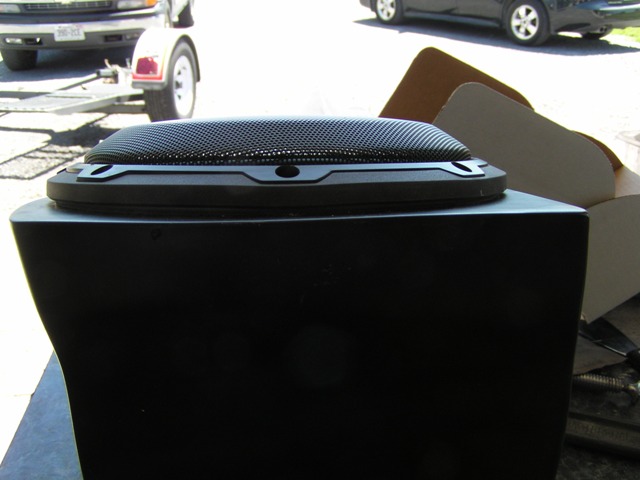

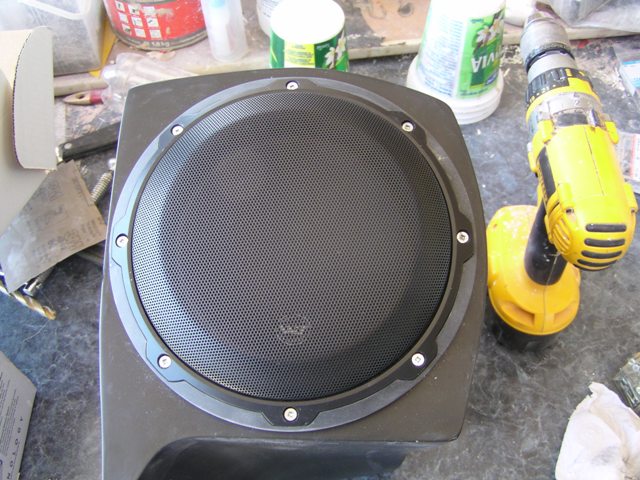

Now with the protection grill option:
And finally! Plugged into the car, just getting ready for use:
And now, I know a picture can't do nothing to make you feel the massive bass pounding on your chest, but maybe it would make you guys want to here such sound quality in a Fiero, the subwoofer in action!:
I've been totally amazed by this enclosure, we reached more than 0.33 cubic feet (Though, there will be a variation of air volume from a enclosure to the other). The JL Audio needed 0.3 cubic feet and the Pioneer could go from 0.15 to 0.5 cubic feet but the optimum is at 0.4 cubic feet. We pretty much meet our goal!
I can't describe the feeling I had when this subwoofer was playing. It really brings the bass the Fiero desperatelly needs and all that with an 8" subwoofer! Not just any 8", an 8" that fits under the dash! Now there will me much more space behind the seats without compromising the sound quality!
Though, there is still some work to get done, we need to design brackets to make it fit under that dash. There will be more to come!
