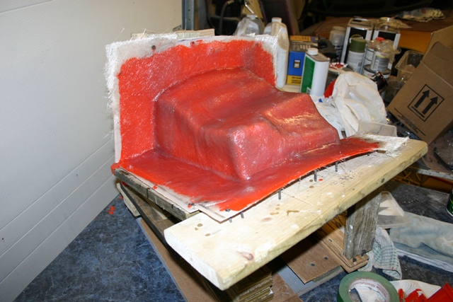

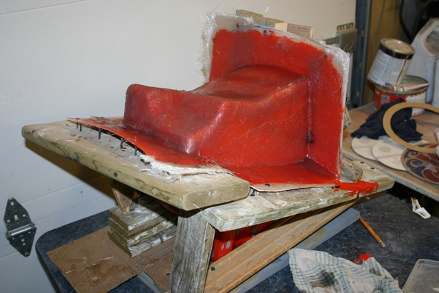

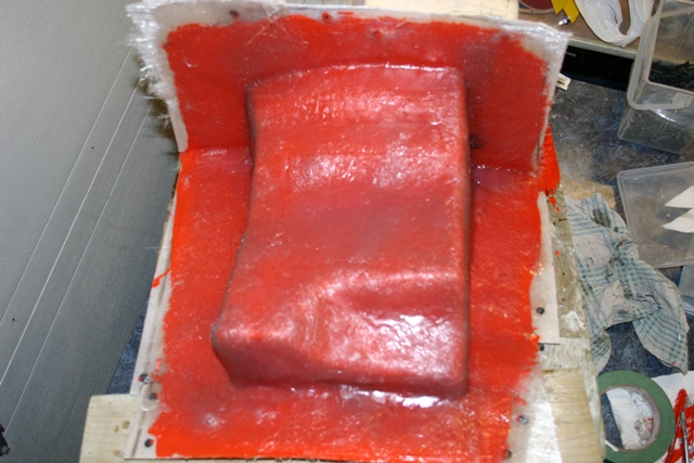

Black Pegasus DEC 20, 09:57 PM
Hi guys!
I have some updates:
-The enclosure has been waxed and polished and oh my god it's as shiny and smooth as a bowling ball!
-I've worked on an assembly to make my first mold of te enclosure. Due to it's wierd shape, it will have to be a 3 part mold.
-I've now started my vacations, so I will try to make alot of work on my car AND on the enclosure.
I will get some pics soon!

Black Pegasus DEC 21, 10:42 PM
I did not measure the enclosure air volume yet, it will need to wait until the first "final" enclosure is done.
Other updates:
-The "assembly" has been waxed
-2 layers of Gelcoat has been aplied
-The first layer of fiberglass has been aplied too
The next layer will have to wait tomorow. The pictures too!

Black Pegasus DEC 22, 04:58 PM
Update:
-The second layer of fiberglass is done
I just have to wait that the fiberglass cure to "un-mold" the project.
As for your idea of making a bigger box like in the picture, but the subwoofer still face downward, I think this might work to get the extra air volume. I will finish the enclosure I am working on right now, see if I can re-pay the money I've invested in the project. Then, I'll try to figure out an alternative for the JL Audio 8w7 when I will have time. Now I need to concentrate my efforts on this and my car if I want to get both done for the Fiero season! :P
Here are some photos:
