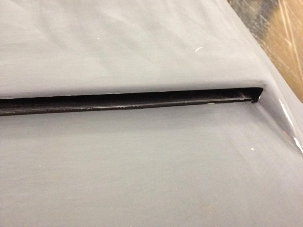

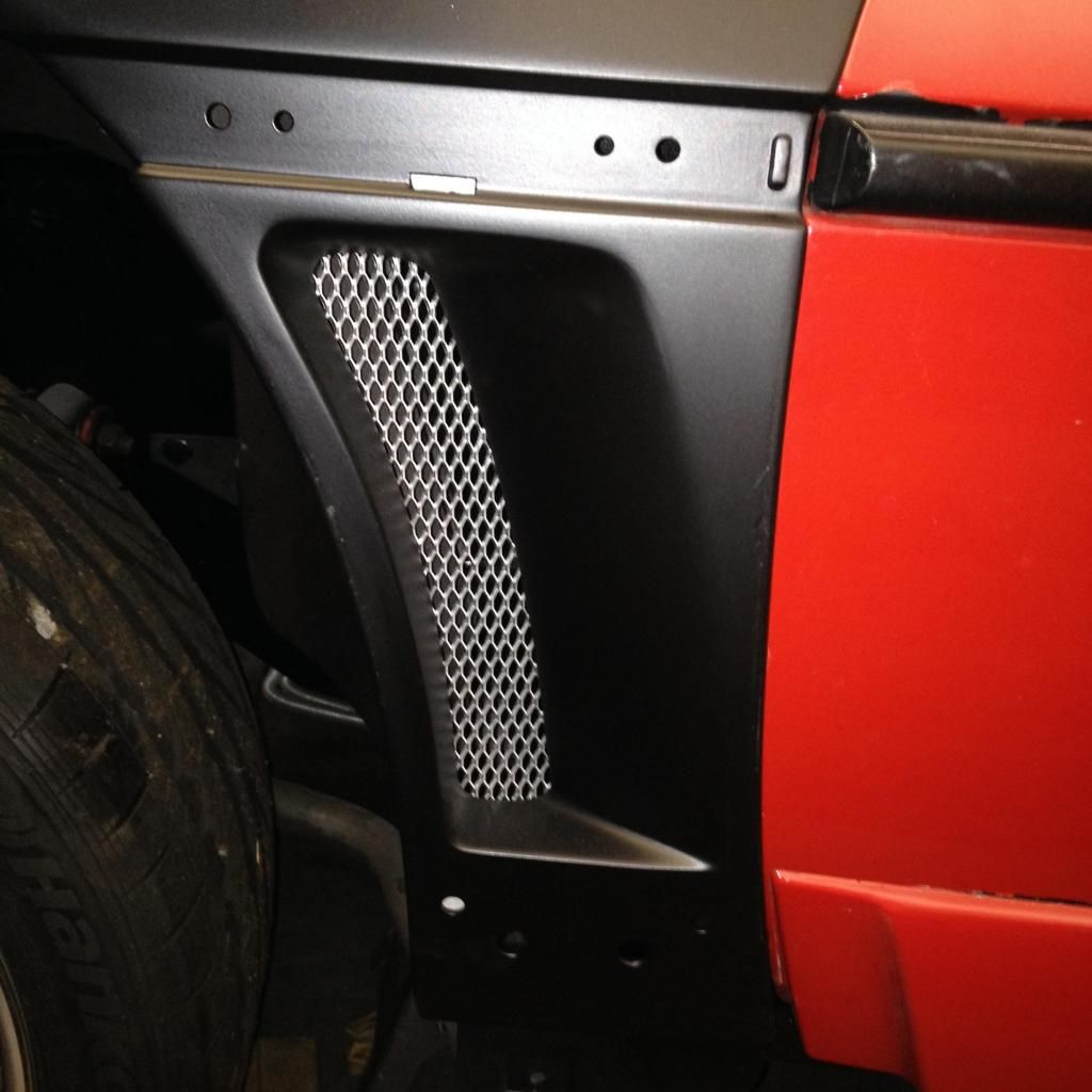

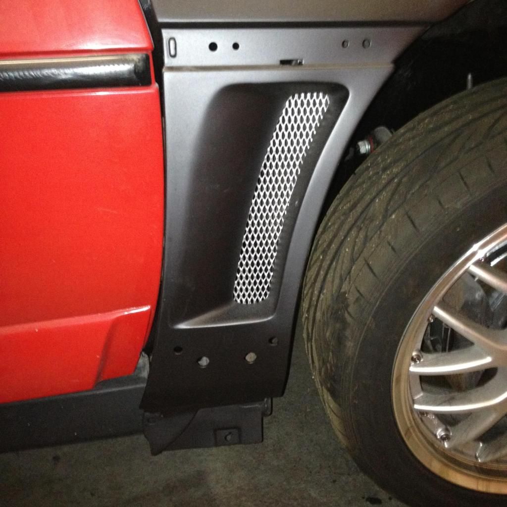

Some progress pictures of Pauls parts on my car...
Fender vents bonded in from behind

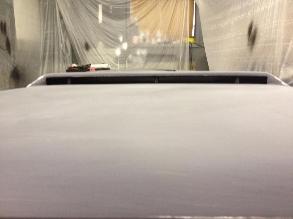

Rear deck
I used three riv-nuts inside, this is part of my grill mounting system from below. I put some reinforced hose over the riv-nuts to act as a cushion to support the middle of the vent. Didn't want any cracking from slamming the trunk closed.

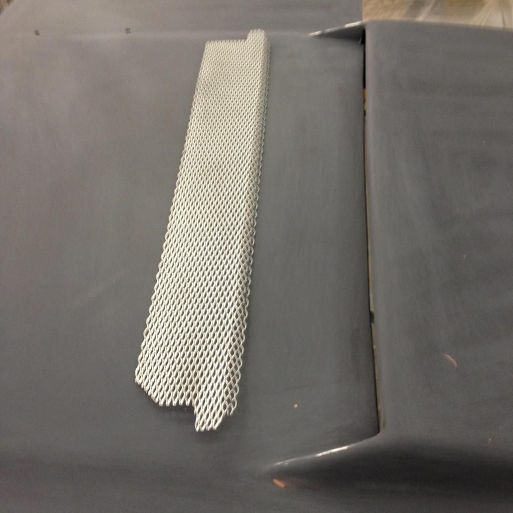

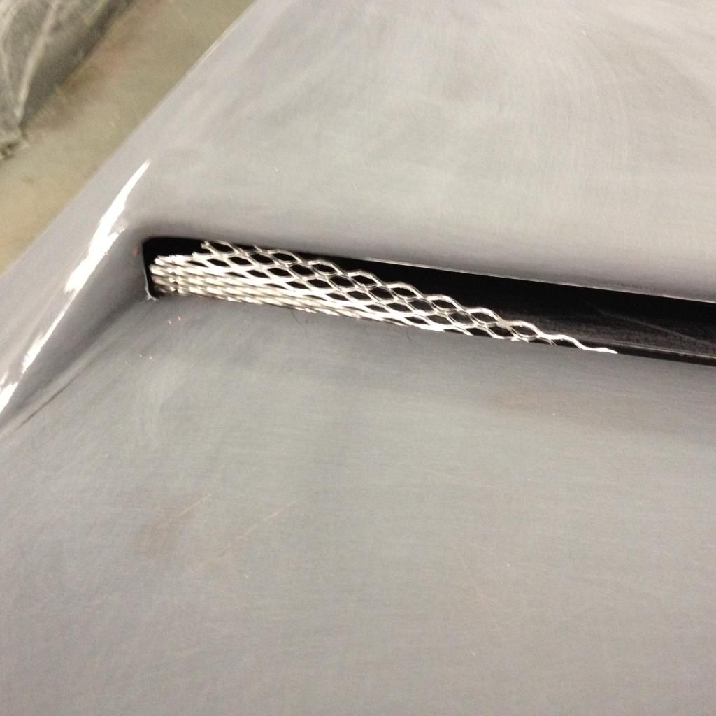

This thin, long slice is for my mesh to slide in place from below. allows for painting w/o making a mess of the mesh
Mesh vent filler, rough-cut. I will powder-coat it black
How it installs. I do not like to keep fitting it in becuase it scratched the primmer. Once it is powder-coated, it will not have any sharp edges
Top edge of the mesh fits into a channel that I glassed-in tot eh under side of the scoop. It make a nice secure, snug fit.

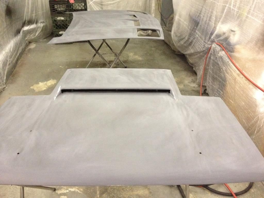

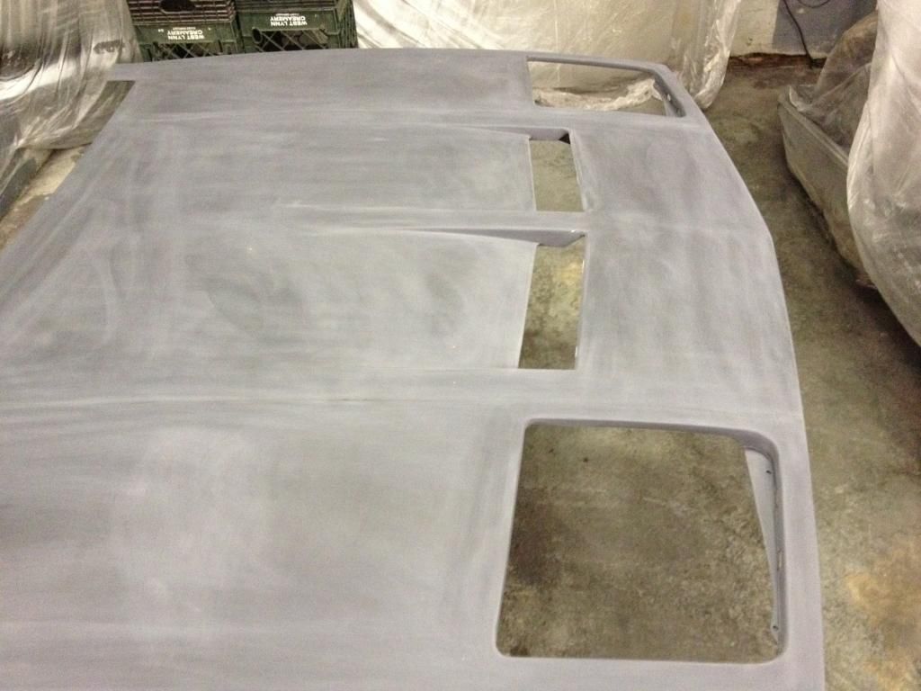

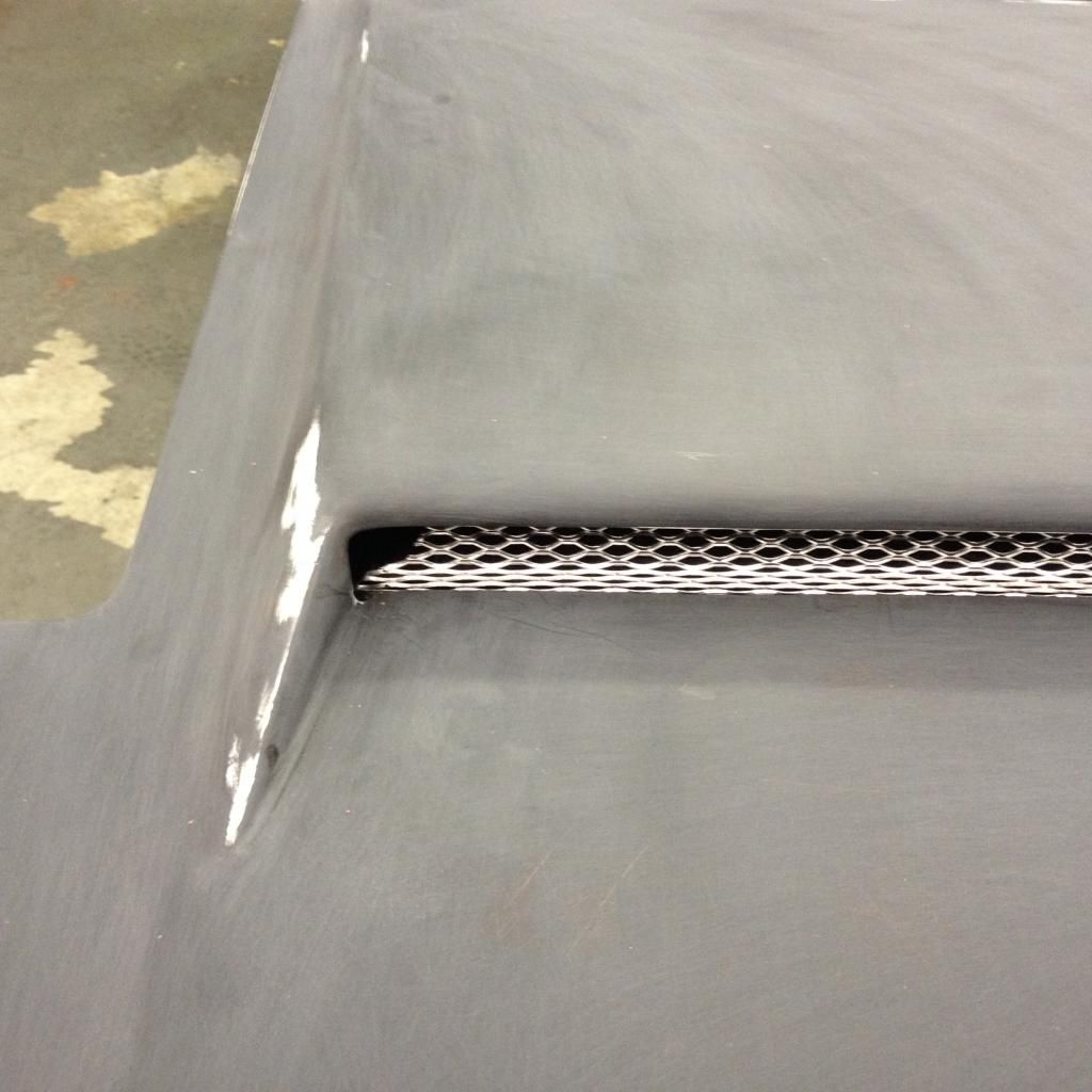

Front hood, I made the opening bigger
mesh parts I fabricated
These I made to kinda snap-in from below. They fit tight and kinda spring-fit into place. I am not sure if I will use fastners to hold them in...

Still making the hood & fender vents? I want the dual hood vents version. Can't zoom on the images on the site, and the descriptions don't make a lot of sense to me. Bond from behind? Help!

The fender vents that bond on from behind mean you have to cut the proper hole in the fender, & bond them on the back & finish out the front. Directions are on the site.
