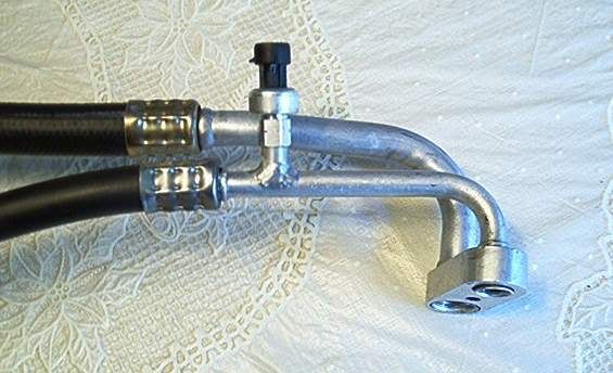

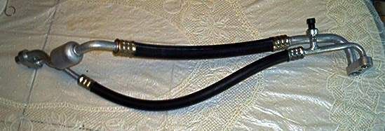

I like the idea of the hose mounted switch port. I had to buy the port nipple and aluminum braze it to the high side line as below. I know what you are saying about tooling up to make these. Just the hose crimp die set alone cost $175.00, then add the refrigerant hose, hose fittings and the hose ferrules. The first dozen or so hoses sold and you break even! Just for info. I am not selling these as I have zero time to make them for anyone else.
and yes I know that the refrigerant pressure sensor should have been on the other end but when I built the harness the connector just dropped down on that side, so I built the hose accordingly.

I have found one more variable...
Some of the AC compressors have the same diameter discharge and suction ports. The fittings I have on hand have nubs that are the same diameter that fit into those ports.
Now we are finding that some of the compressors have a larger diameter port on the suction side. I tried to find a suitable substitute but have yet to see anything that would work. All of the manifolds I found, that had the larger nub for the suction side, routed the lines toward the passenger side and ours need to go toward the driver side. However I have also found that if you're careful, you can get the washer seal for the larger port and it will just be loose around the smaller nub. When you bolt it onto the compressor center it up and it will still seal. If you don't want to do that, you'll need a compressor with both ports the same diameter.
