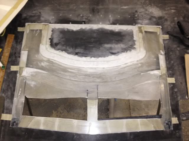

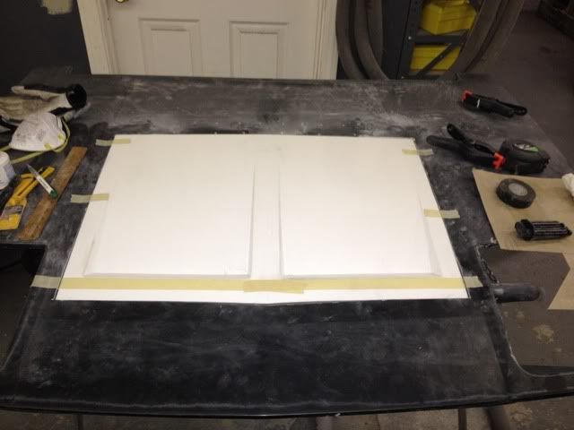

This pic shows the top fitment w/ the vent in place. Tape was use as a guide for centering...

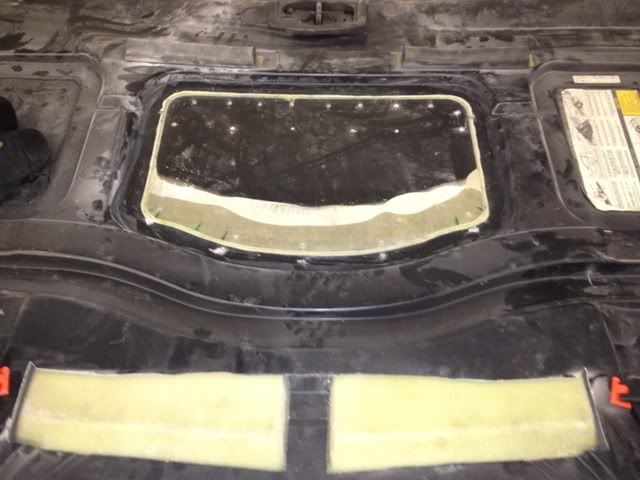

This is a pic from above w/o the vent in place. You can see where I bonded in a pice I cut from the top skin to fill in the opening above the trunk and some small support tabs. You can also see where I had to file down some of the reinforcement under-structure to make the vent fit flush w/o force...

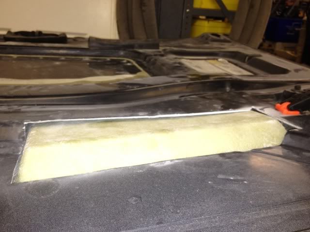

This pic is of the bottom w/ the vent in place. You can also see the piece I added to fill the trunk hole...

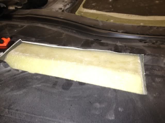

These are some close-up of the bottom-side vent, where I have a large gap that will need to be addressed (somehow)...

I'm thinking you should cut all the way back to the trunk seal, & cut the center hump out completely.

That would leave an even larger gap on the left and right "sides" of the vent back by the trunk seal that I would then have to deal with...

i'll take some pics, or upload the ones I have, of what I did, but bottom line, you need a lot of filler and maybe some glass to fill the gaps. I used some of the cutout top panel to fill in areas so I would not have to use too much filler (SMC). In the corners I had to make little pockets using fiberglass. I fixed them to the hood/scoop, and then filled over them with SMC and the SMC putty. It took a lot of work, more than the top, to make it look right, and in the end I realized that the only one who would ever see it was me when the hood was open. So, in this case, I got "close enough".
