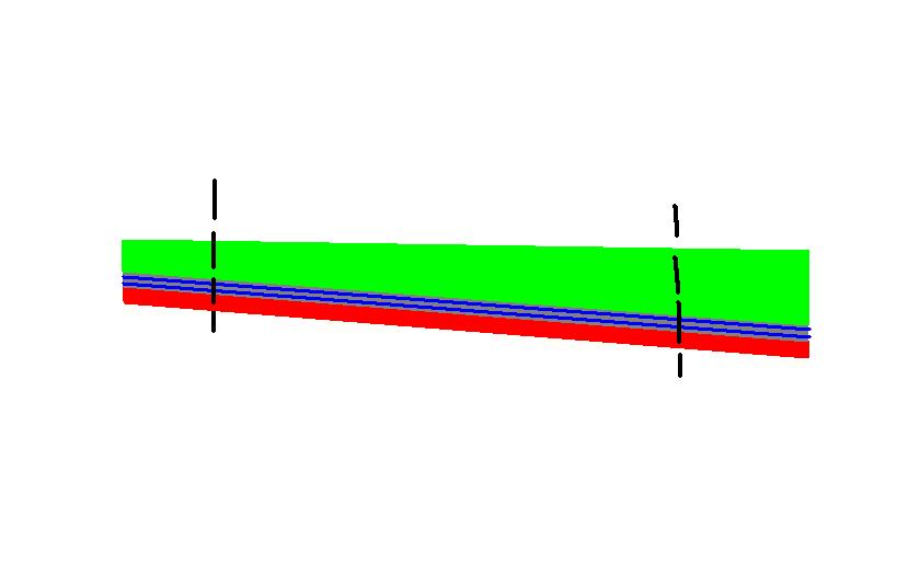

The problem is not with the water itself, it's more of a poblem with the extra material added. Here is a picture to show you: (I made it fast on Paint at midnight just for a visual support)
This is the example of the bottom of the enclosure cut in half (Where there is the hole) if you would watch from the passenger door to the enclosure. Because we needed more spacing to put the shallow one. Here is the ledgend:
Blue = Layers of fiberglass
gray = Fiberglass resin
Red = Gelcoat
Yellow = Filling Putty (Used for body work)
Black = Where the sub hole will be
Green = The space unable to be counted if we test the volume
(Note: The final product will be only made out of Fiberglass, Fiberglass resin and Gelcoat, these are waterproof and are not affected by water)
Basically, we made a first rough shape with fiberglass and gelcoat, a rigid base. When it was time for the modification (To take more place out of the underdash) in this case it was to be able to put the sub too. We needed to tilt the sub box to make it fit so we added extra putty for the support where the enclosure will screw on.

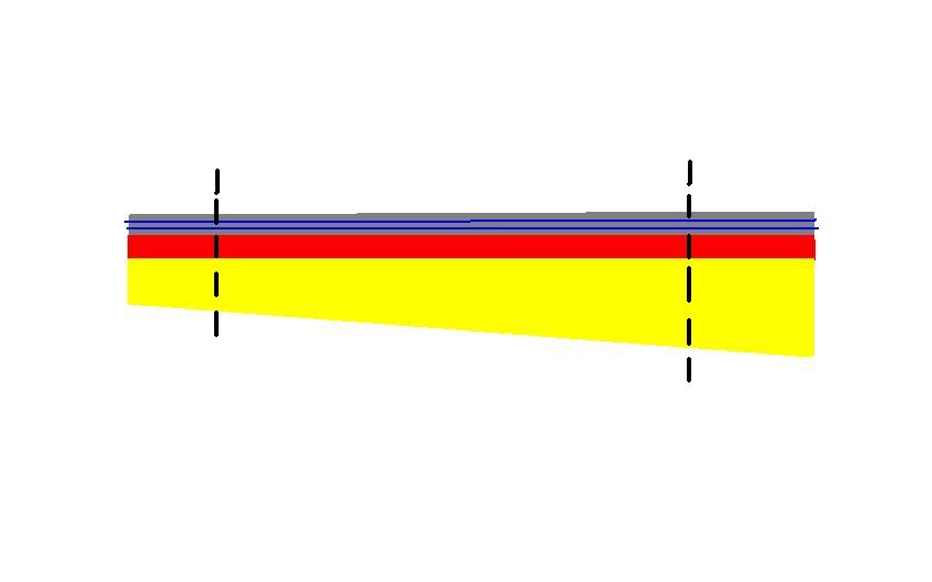

By adding this putty, if you put water, or rice in it, it will show the volume of the inside of the enclosure (In the diagram, it would be the upper gray portion represented by the fiberglass resin). This means that all the extra putty we put would be ignored, useless. In the final product, there won't be putty so the enclosure should like more like this picture:
The green part is all the extra space we made and can not be counted right now because of the material taking the space.
As you can see, there is alot of things modified, and we can't put all the sub in the water because it will show the exterior volume (The bottom yellow part of the first picture). Yes it will be the exact same exterior volume but the interior will change because you need to add the thickness of the material (fiberglass, resin and gelcoat) Therefore in both ways it won't give a proper volume reading.

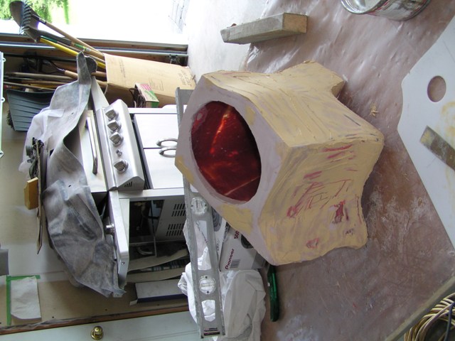

It's not only the bottom that had been modified, here is a photo of the enclosure:
In this case, the red is the gelcoat, the pink is all the major putty we put on and the yellow is the finishing putty.
I don't know if you guys understand, if it's explin properly. It's pretty hard to explain. If you don't get it, just tell me and I'll give it a second try to try to help you!
