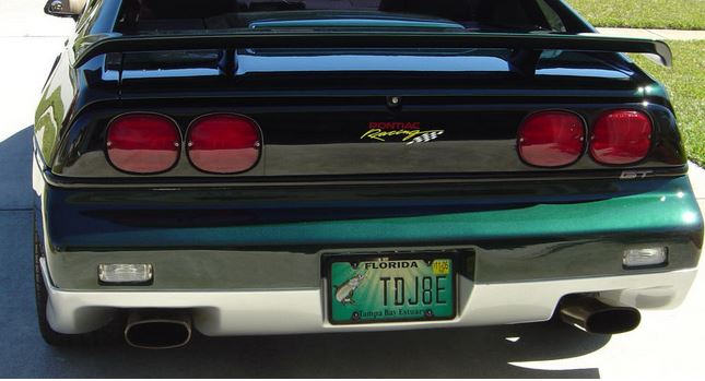

Well we have had many an online discussion about these over the years and the guy that had the molds finally resurfaced. The mystery has been solved and the guy reproducing these is Jim Cleary of St Petersberg FL. As to how he acquired the molds, I didn't ask but I did receive shipment tracking info and they should arrive here next week. According to Jim he didn't make many more panels as he didn't believe that there was a market for them. I guess that if you are a poor mans C4 Corvette fan, this is the ticket. If you add the C4 lenses, lens screws , lens gaskets , the Pilot B.U. lights that fit into the recess where the reflectors are; the total cost is around $350 Then the panel is painted black (or the color of your car) and some fitting is then required. Hopefully it will look like this when finished.
 Here the panel is installed and shown with the Pilot Navigator back up lights in the rear facia[This message has been edited by Dennis LaGrua (edited 01-25-2020).]

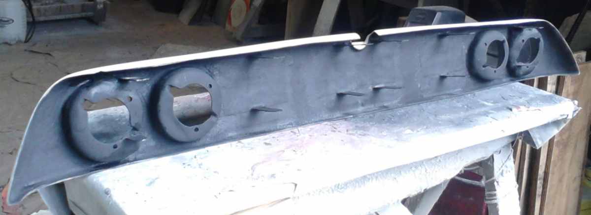

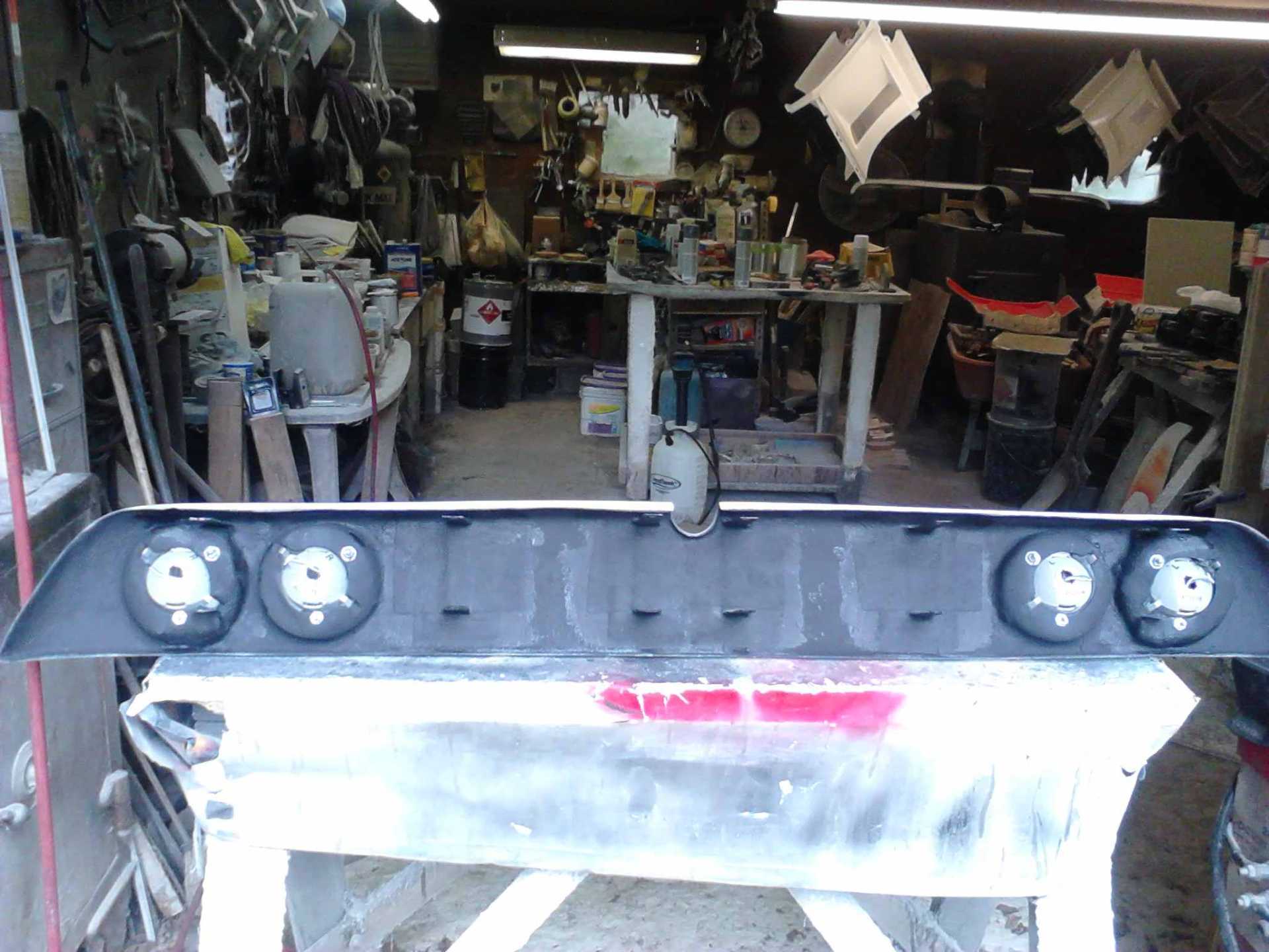

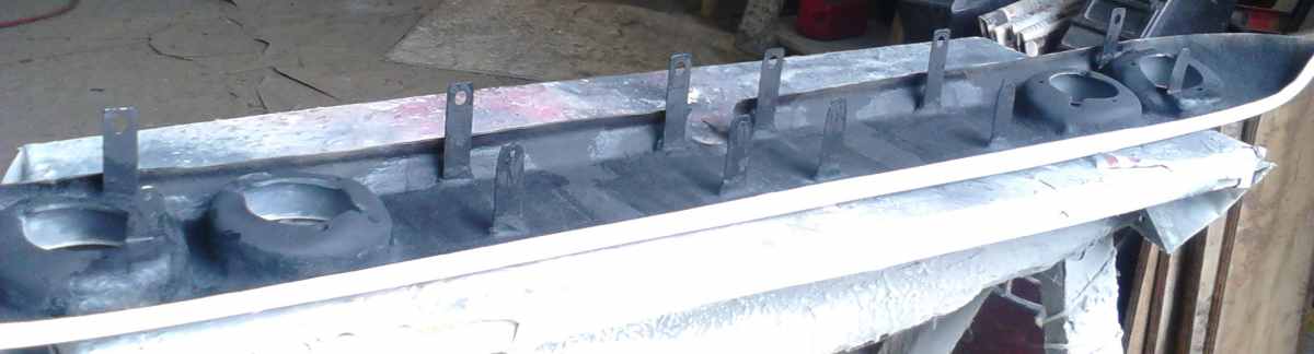

Here's one method I used on a custom panel (round light version).
What you see are aluminum brackets bent to shape/size to reproduce the attachment points of the factory housings. Uses the factory mounting bolts.
The brackets are then glassed onto the backside of the panel in "strategic" places to line up with the bolt holes in the body. Takes a lot of measuring, but makes the panel attach the same as the factory lights.
Just another take on mounting possibilities.

Formula
FEB 14, 09:32 AM
| quote | Originally posted by Sage:
HAGO!  |
That's exactly what is needed! (is that panel for sale?)
