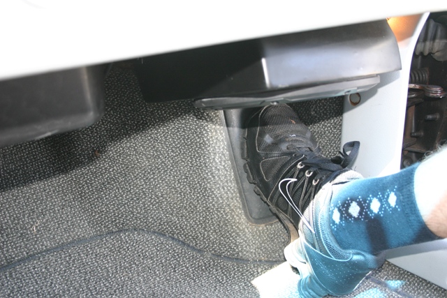

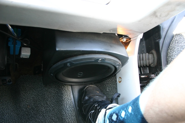

It's a tricky question. In theory, yes someone can still use the footrest, but the feet isn't flat on it unless you have very small feets. Here are some pictures with my feet. Note: I wear 8.5 shoes, for all the 3 pictures, I did not moved my foot, it's just different picture angles.
So this is why I'm strongly recommending this for the JL Audio:
