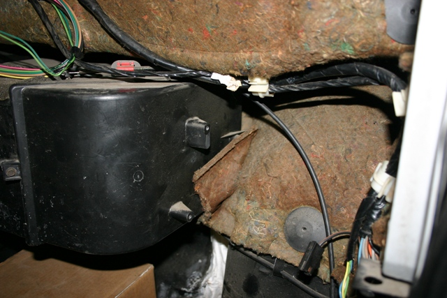

Note: 84 Fieros with A/C will need some modifications to the plastic vents cover beside the enclosure since the chime module is screwed into it instead of being hold by a bracket. The cover will need to be cut and patched to aloud the enclosure to fit under the dash. (A picture would help to explain, but don't worry, I will explain everything properly and with pictures, make a walk through and specific instructions that will be given with the enclosure.)

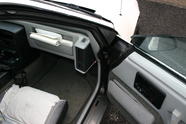

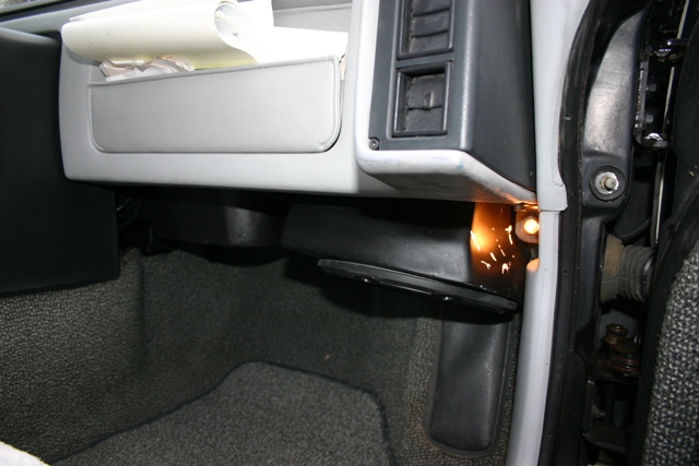

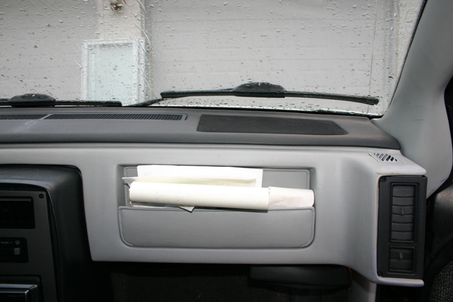

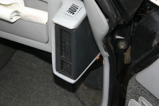

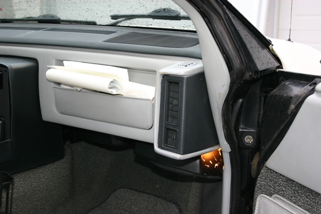

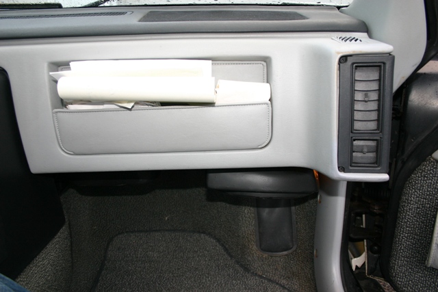

I have some picture for you guys.
The first one is the 84 duck work that needs modification, I'm referring at the 2 "pins" that needs to be shaved off. If you have an 84, keep in mind that you need to do that.

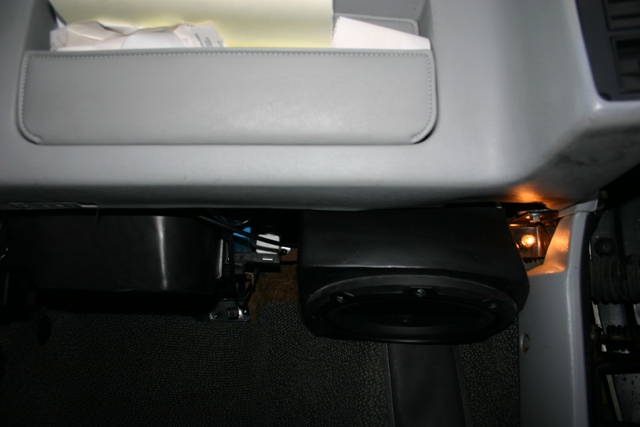

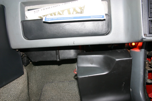

Now I will show you the different clearance with and without the air conditioning. The enclosure mounted is without A/C and the one which is sitting on the car floor is with A/C. You guys can see the difference of the clearance with the duck work. (The first picture has been taken at the belt level while sitting in the car.)
And now, upon request, some pictures of how it looks mounted in the car. You CAN NOT see the enclosure from the outside of the car.
I was standing outside the car when I took those pictures:
When kneeing outside the car, you start to see it:
When crouching:
From the inside of the car, it can easily be seen THOUGH, it keeps a low profile look, not attracting much attention since its similar and close to the duck work and has a similar black color. The first one is like when you look down at it, the second one is as if you look straight out of the windshield.
I hope this answers to a lot of questions.
Nvm. I think I may have answered my own question. So the enclosure uses the maximum room available, the top picture has a smaller HVAC duct, and that's why it looks like there is space not taken advantage of, correct?
Black Pegasus AUG 14, 02:43 PM
This is exactly correct! With A/C and without A/C do NOT have the same duct work. For the amount of time invested in one design, i don't want to invest into making 1 kind of enclosure for A/C, one without, one for 84s, one for... etc. I preffer only one universal enclosure that requires only minor modifications in different applications.
