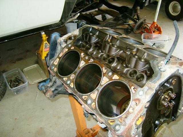

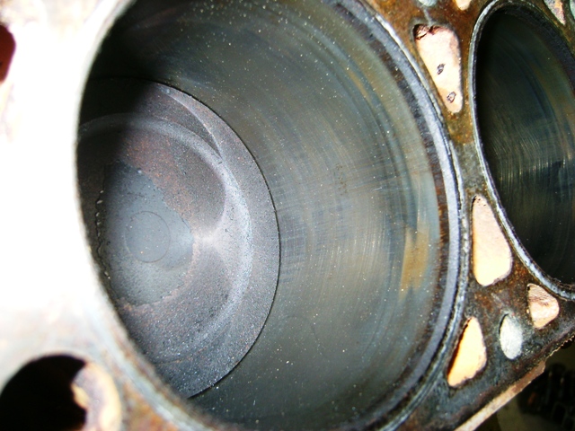

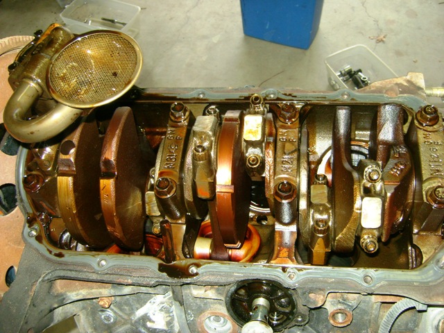

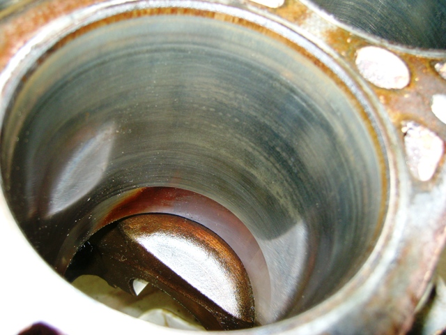

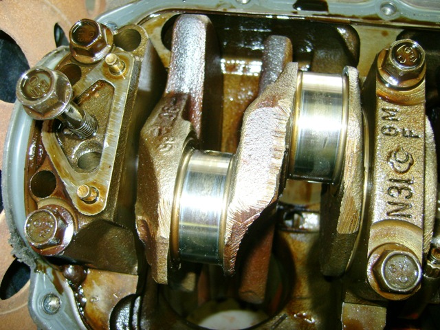

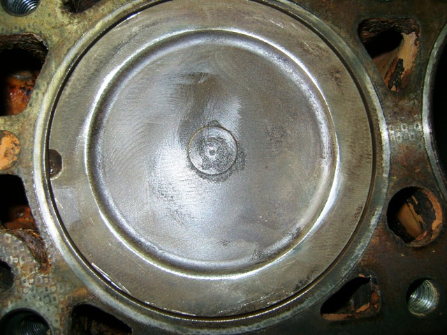

Dropped off the block for honing ,new cam bearings and hot tanking. All cylinders were still standard bore. Crankshaft was measured out as standard and will just get a good cleaning and micro polish in the bearing surfaces.
Ordered two Dorman #571-003 expandable freeze plugs to plug the crank and cam sensor in the block. Ordered one Oil-Tite # 65221. This is a M20-1.50 oil plug to thread into the hole in the pan where the oil lever sensor used to reside. I will have parts here tomorrow to await the return of the block and crankshaft.

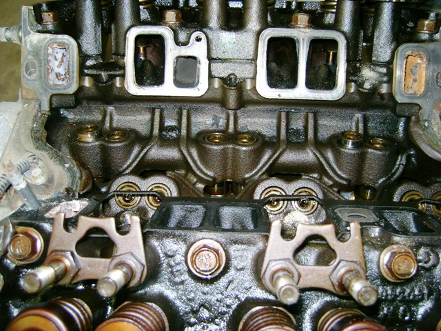

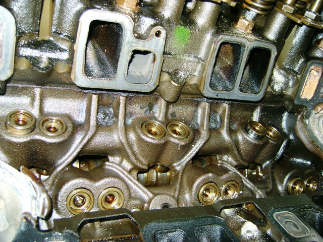

I got the starter Jig from RD in the mail today. Looks easy enough to do. I also purchased the brass oil pressure switch adapter and a new distributor O ring. Valve stem seals cam from RockAuto.
I got a Valve spring compressor at A-Zone this morning so I can install the new seals. Might do the seals tomorrow after I am finished with a few small chores to do first.
