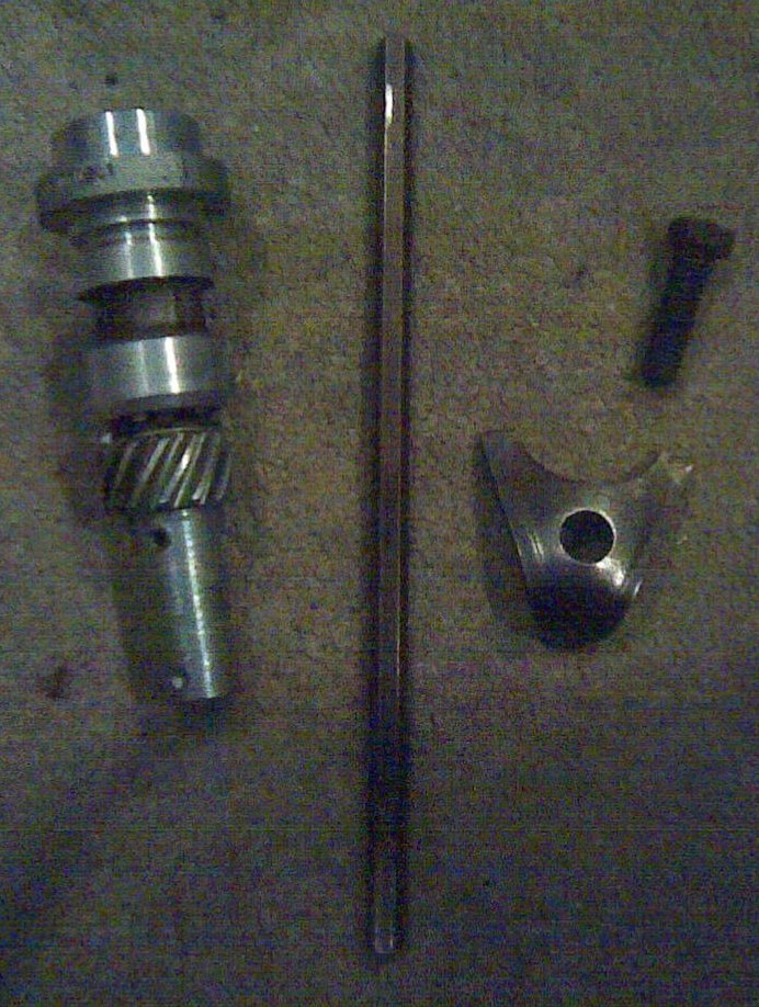

Here's what the dummy distributor looks like, I got this one out of a 94 Olds Cutlass Supreme 3.1

RWDPLZ DEC 13, 10:48 AM
Originally posted by scott0999:
you can get them off any 60v6 that had DIS (2.8/3.1/3100/3400/3500 ect)
The cylinder numbers aren't labeled correctly on that engine?
