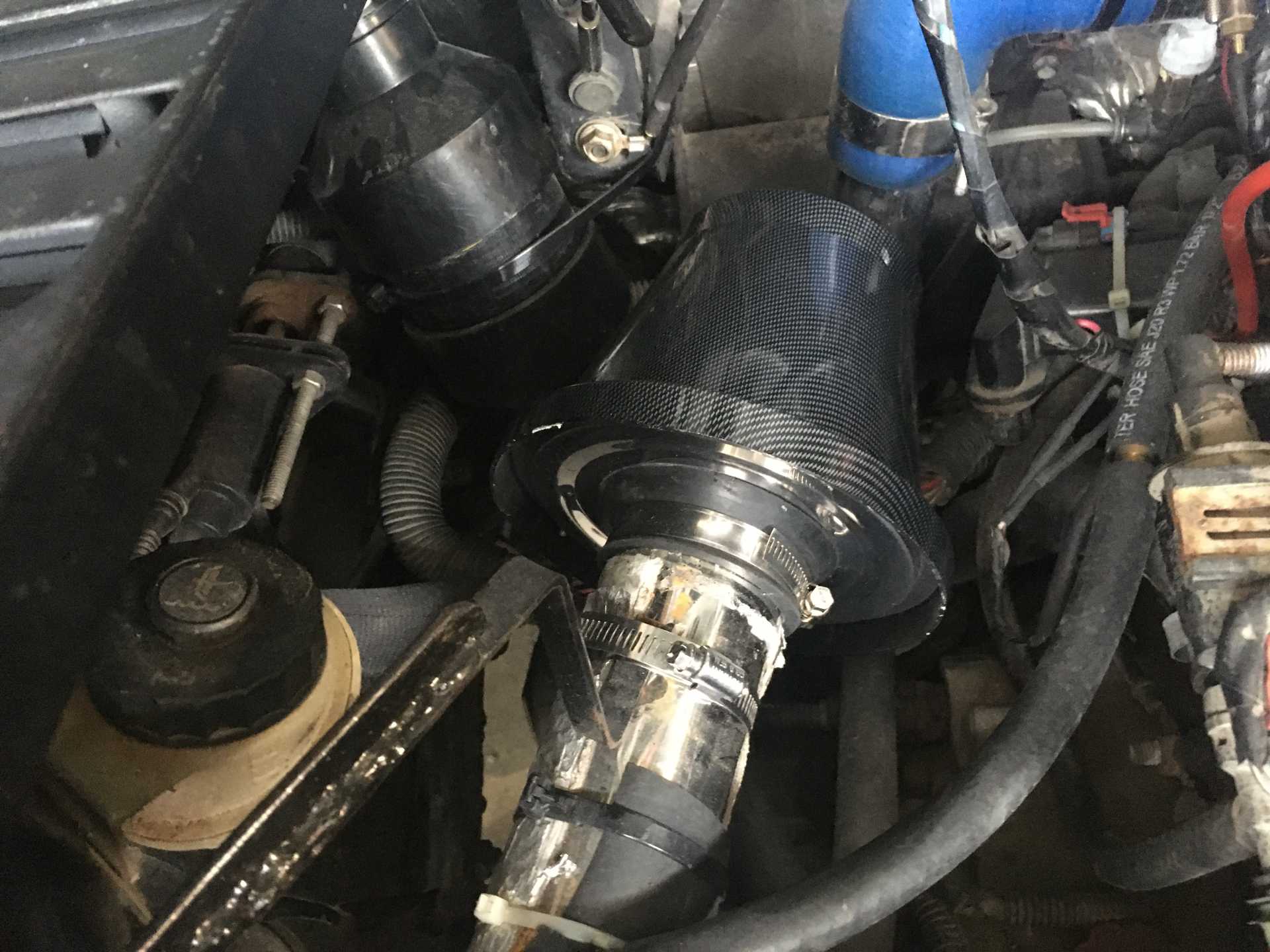

I haven't done much of anything to the Fiero lately. I was busy with two slot car tracks, and then it was camping out west in Banff Alberta for almost 5 weeks. While I was building the second track, I had to move the Fiero out of it's shed to get more space and it got rained on- a lot. I took it for a ride after the track was done and did not realize that the air filter was sopping wet and this happened:
The paper filter was so wet the turbo sucked and shredded a bunch of it in to the charge piping. Where it found it's way to the heat exchanger and almost
plugged it solid. Above 3000 RPM the engine would lose all of it's power. Amazing that it even got out of the driveway when you think about it.
I carefully cleaned it all out and got the charge piping back together. There was also a cracked fitting on the water side of the heat exchanger that I had to fix. While I was at that I moved where the resorvoir feeds the pump to keep the pump impeller wet on startup.
I have driven it a bit and there does not seem to be any damage to the turbo. I ordered a cone flanged air filter from frozenboost.com and it has protective wire mesh on both sides of the filter so I don't think I will see a repeat of this problem.

wftb SEP 28, 04:01 PM
The new air filter:

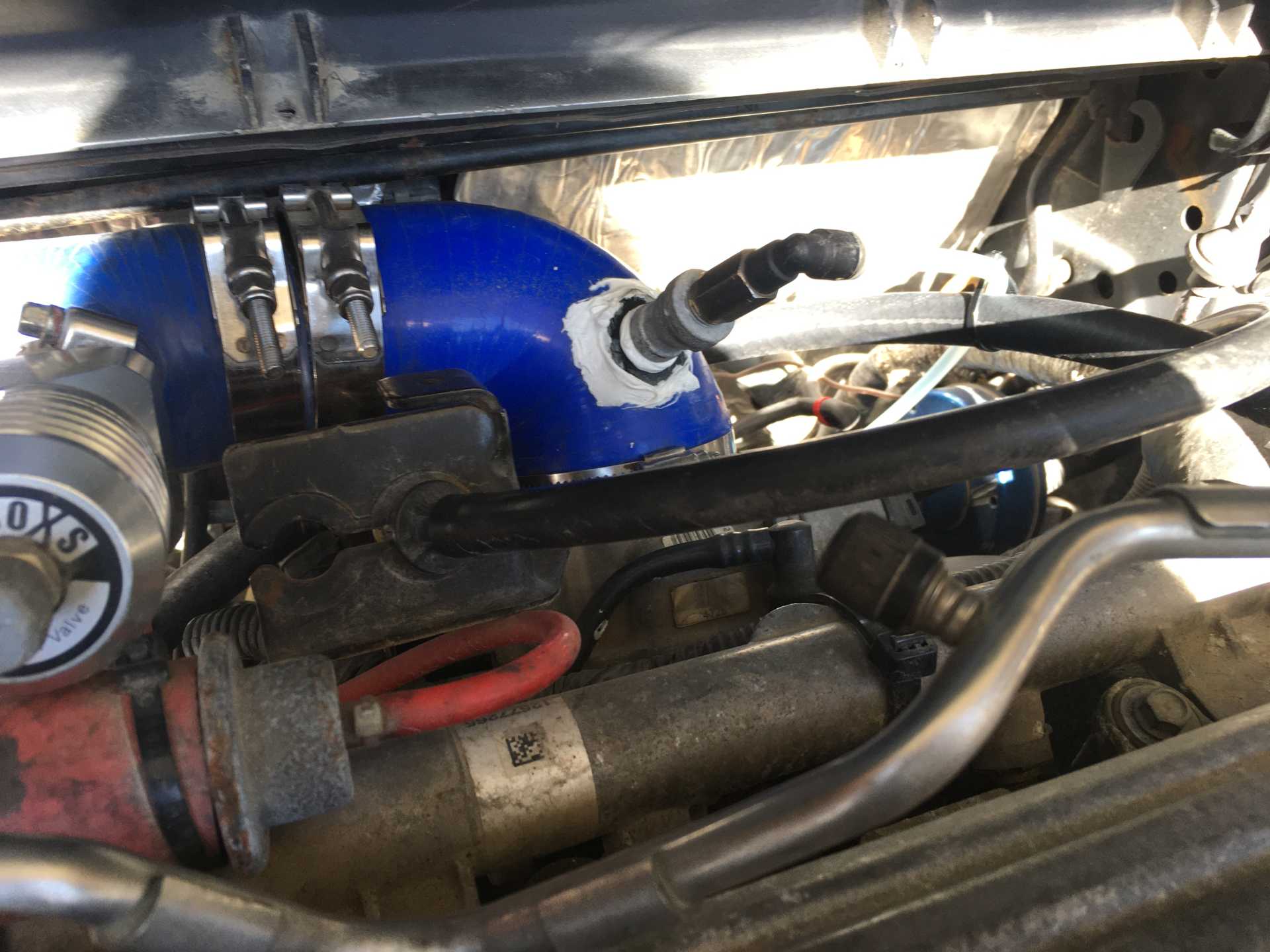

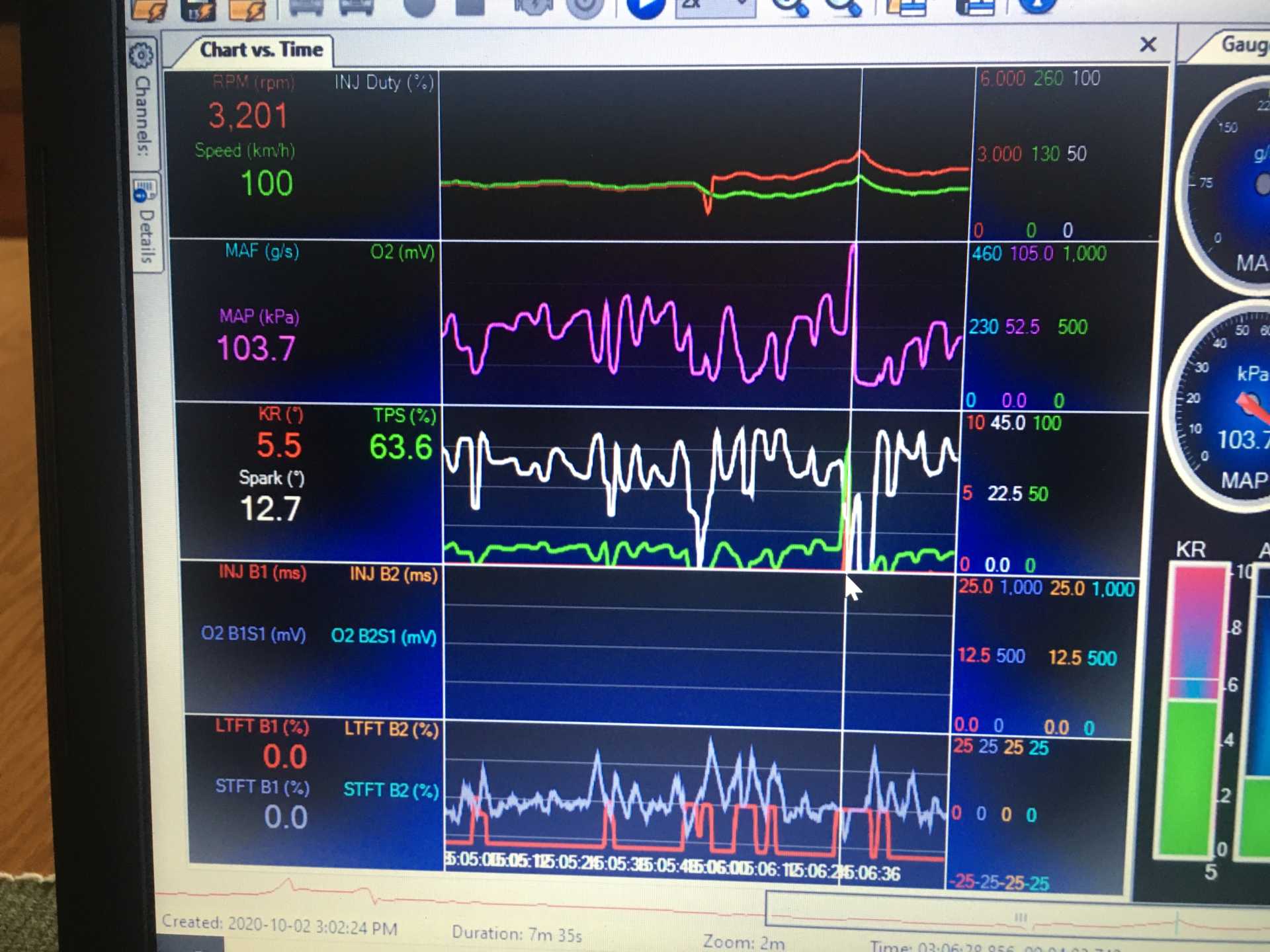

With all the recent changes I took some scans and did not like what I saw
So I removed timing in the areas that were affected. That helped a lot but still had 3 to 5 degrees of KR where I usually did not see any. I did a scan with the water meth shut off and that did not make it much worse, just changed the profile of the KR spikes. So I figured the water meth was not doing much of anything. I used to have the nozzle on the elbow just before the throttle body but that fitting leaked so I moved it to an existing fitting about 10 inches before the TB. I moved the nozzle back to the elbow.
It is the same fitting that leaked but all cleaned up and with a lot of sealent. And that did the trick. The only KR I am getting now are small random spikes of .2 to 1 that are showing up without reason once in a while. I have suspected false knock for a while and this confirms it. But the scans are looking good now. A bit of false knock is not going to hurt anything.

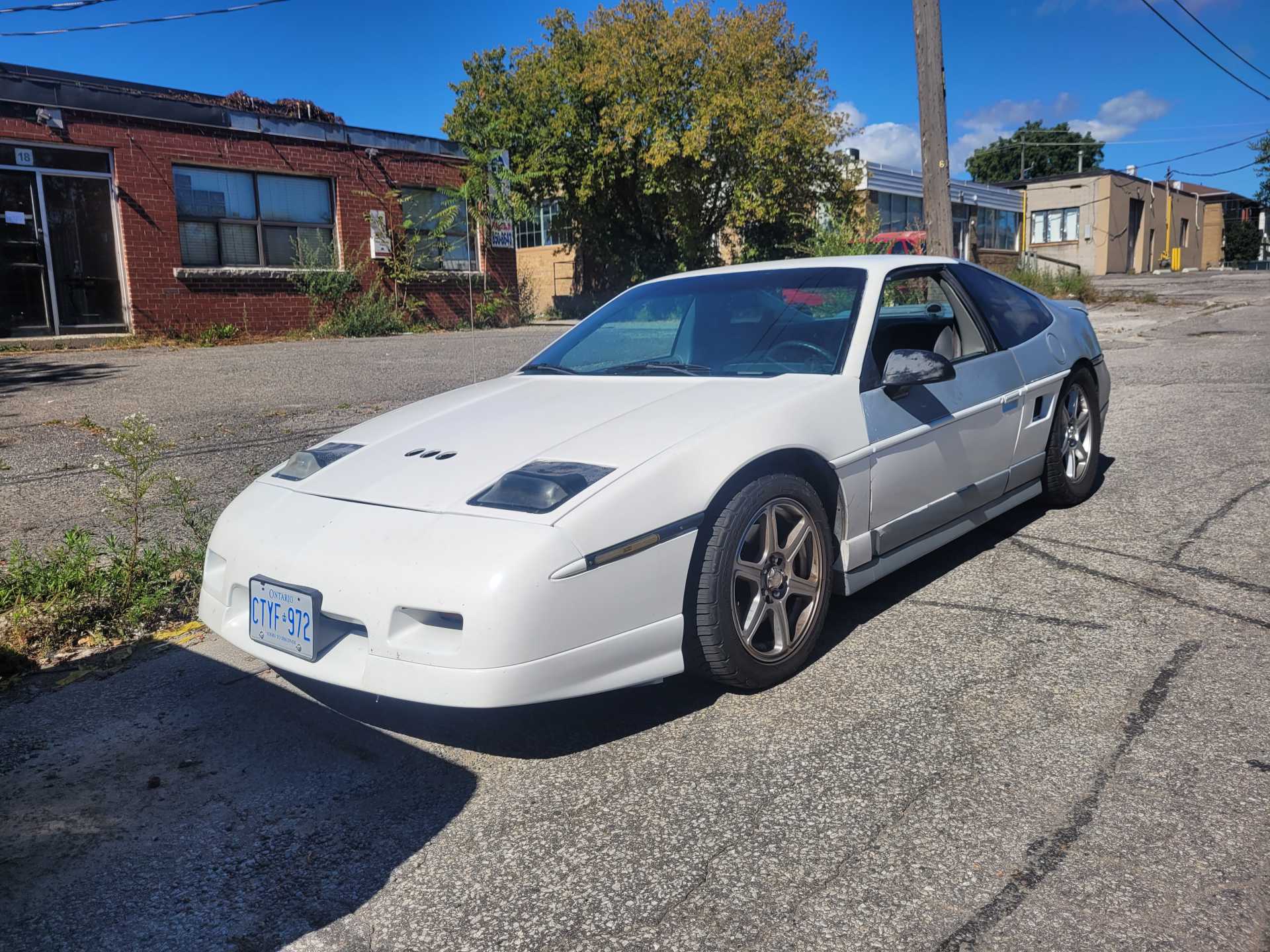

I sold this car the other day. Not getting the paint job done in a reasonable amount of time kind of did me in. And after owning and playing with the car for 22 years I want to work on a different car for a change. My 91 civic wagon needs an AC compressor and that will be this winter's project. I have probably spent 20K on this Fiero over the time I have owned it including the original purchase price but that is only about 910.00 per year. As far as a hobby goes, I spend more than that on a season of golfing. Good luck to the new owner, hopefully he gets as much enjoyment out of it as I did.
86 GT built 2.2 ecotec turbo
rear SLA suspension
QA1 coilovers on tube arms
