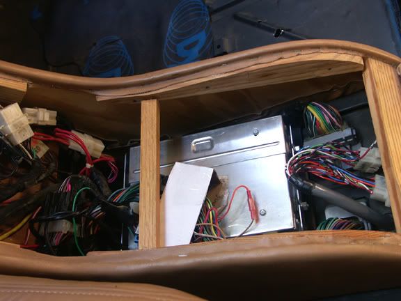

Started my 86 V6 up yesterday after completing the 1227730 ECM upgrade in this thread. Once the fuel pressure was up, it started easily and idled at the target 1100 rpm and sounds wonderful! Throttle response is better than ever before - This is a must-have upgrade for every V6 Fiero out there! I made a harness adapter rather than re-pin my loom (gave me options later on) - So a kit IS possible. The Knock sensor, digital EGR and evap canister valve control wires were all put together into a new loom, shielded and taped like all the others in the car - just looked neater that way..
Most thanks go to Darth (Ryan) from Sinister performance who programmed the memcal perfectly. I have many images but cannot, for the life of me, figure out HOW to post them here! (Which is hard to believe for a 30+ year engineer)

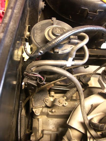

New EGV384 EGR in place on handmade adapter plate.
1227730 ECM with Wiring loom adapter - note Bypass connector for timing.
New Evap Canister Solenoid with vacuum re-route.
