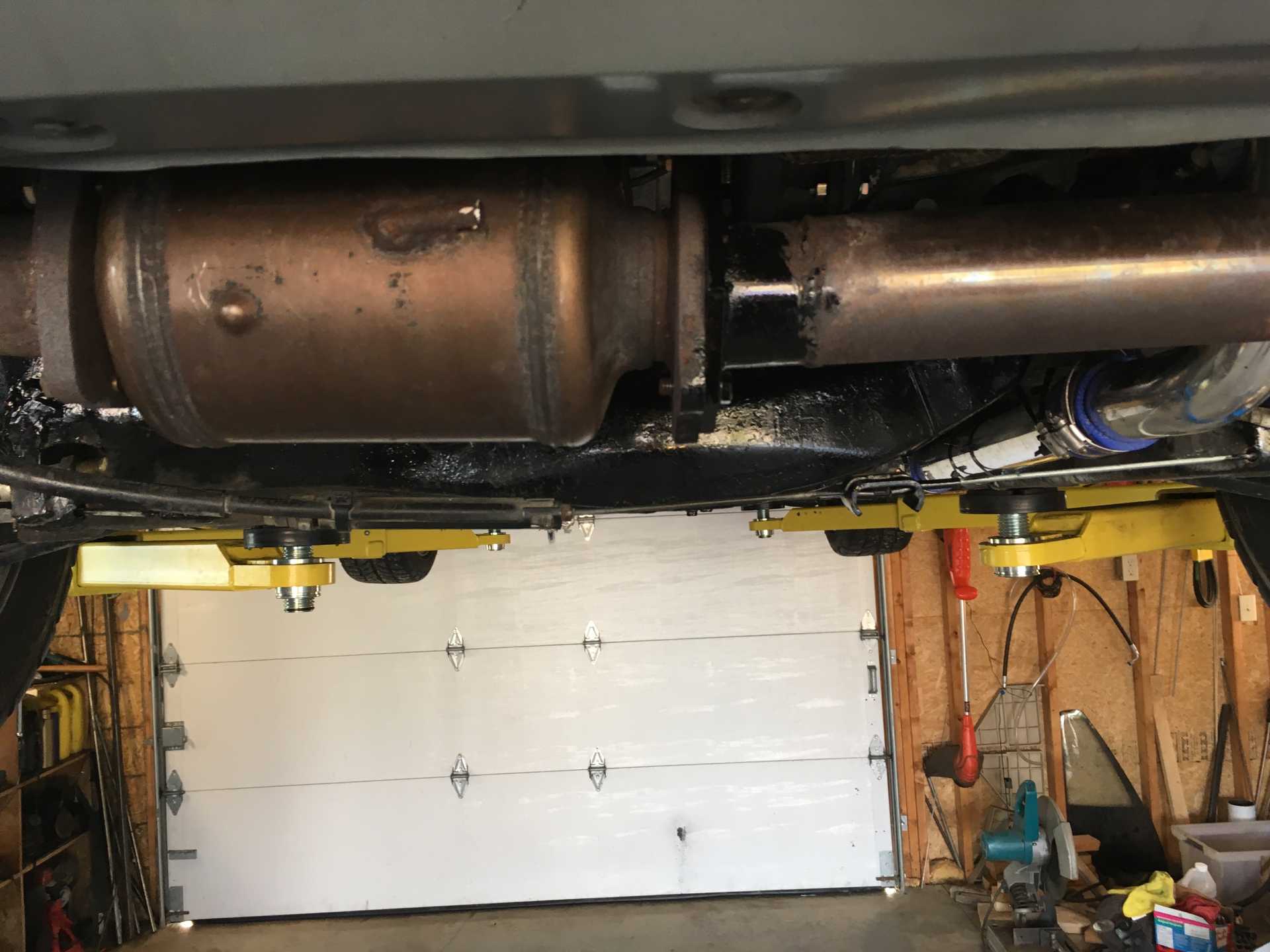

wftb DEC 26, 01:13 PM

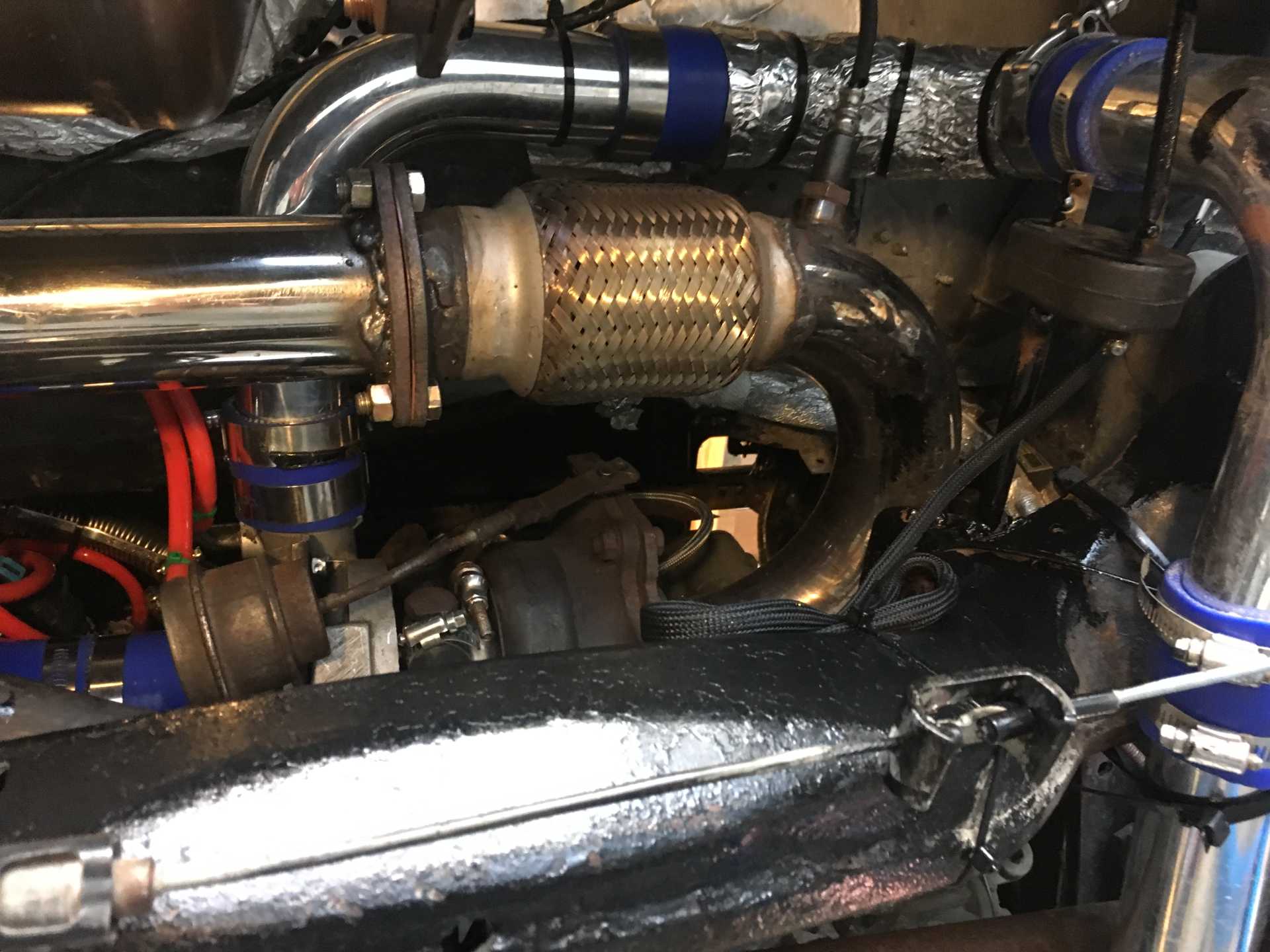

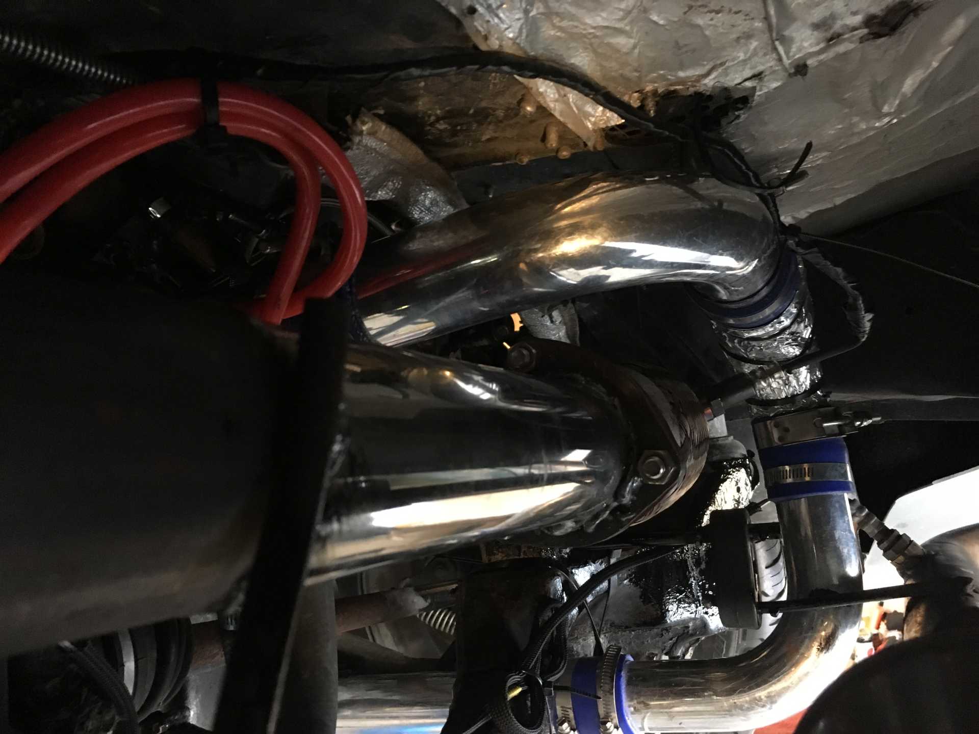

Took these pics just before I put the car in the shed for the winter. All the snow has melted again but the sand and salt and mud is everywhere so no point in driving it. You can see that everything is tucked up above the frame, and how it is a bit crowded around the turbo area. The charge piping runs above the exhaust pipng for a short distance but there is good seperation. Overall there are a lot less places where the charge piping can pick up heat. The area where the heat exchanger is about the coolest spot anywhere near the engine. This is all the work I will do on the car until some time in March probably, when the snow melts again and I can get it out of it's shed.

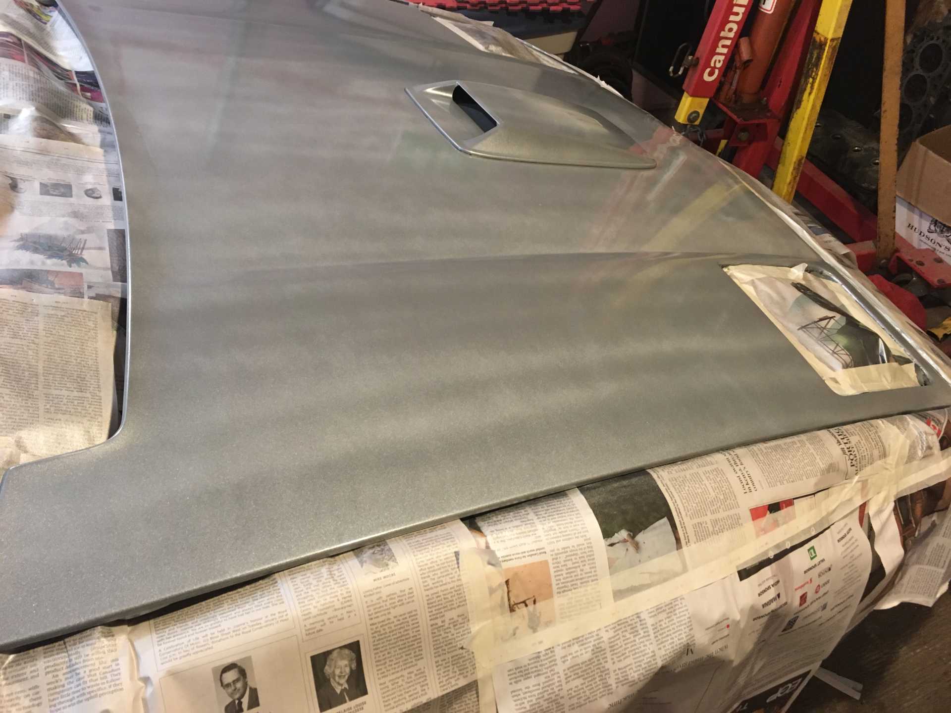

This is my present paint job, done about 7 years ago. It was done with Rustoleum Universal brand rattle cans. It is getting long in the tooth and takes a lot of waxing and buffing to make it look good. I learned a key thing about this paint when I painted a 91 civic wagon: you get a nice gloss and a smoother finish if you paint with the temperature lower than 60F. I had the shed heated to over 70F and that made it impossible to keep a wet edge going as I sprayed. The edge would dry too quick and developed stripes of gloss and semigloss textures. I fixed this by wetsanding and then waxing the finish. And that was a lot of work. I know I can do a better and faster job now. I do not think the colour I have on now is available, at least not at my 2 local suppliers. But gloss white is available, I have always liked white Fiero's so I may go that route. I have time to kill over the winter so this will be a good project.

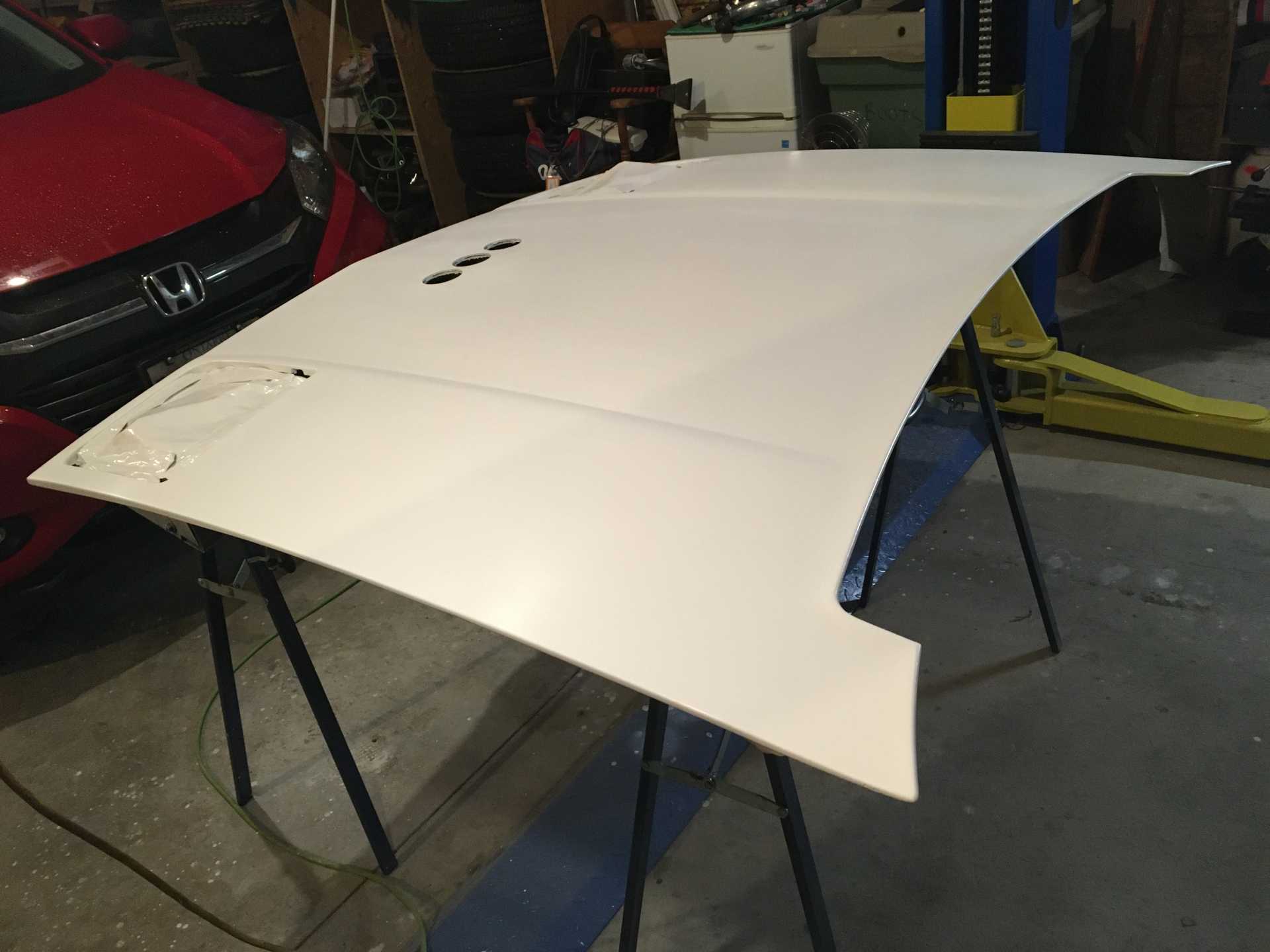

wftb FEB 04, 05:51 PM
Slowly getting the hood painted. I took most of the old paint off, tried a different gloss white that didn't work out and took it back down to where it was . This was the second light coat of Rustoleum universal . I had to do two more coats and now it looks pretty good but I managed to get two small runs in it, up near the windshield wipers. The up turn makes the perfect place for runs to form. I am hoptng to be able to touch up the runs, I do not want to paint the hood again because it would mean sanding it down again. I have found the hood is the hardest part of the car to paint, with a rattle can anyway. All the other parts of the car(except the roof) can be painted in small chunks, making it much easier.

wftb FEB 24, 06:05 PM
It is starting to look like I am going to have to give up on using these white spray bombs. I cant seem to get a nice even gloss and the nozzle keeps dripping paint on to the hood surface. They worked really well when I painted the civic wagon but now it is impossible to not make a mess. Not sure what I am going to do now, may just have to try to paint the hood grey and quit while I am ahead. I have 3 full cans of the grey leftover from the first paintjob so unless I want to spend a bunch of money on spray painting equipment that is my only option right now.
Will FEB 26, 12:56 PM
If you tilt the hood up so the painted surface is vertical, you'll both get a better view of your coverage and avoid nozzle drips.
wftb FEB 26, 06:21 PM
These cans are supposed to spray any direction without dripping. But they are terrible at anything but straight up and down. But your suggestion is what I have in mind for one last try at using the white colour. I took a can out to the Fiero shed and painted a 3' by 3' part of a side wall and got a nice finish and no dripping. I am going to hang it up vertical in the garage and give it another try.

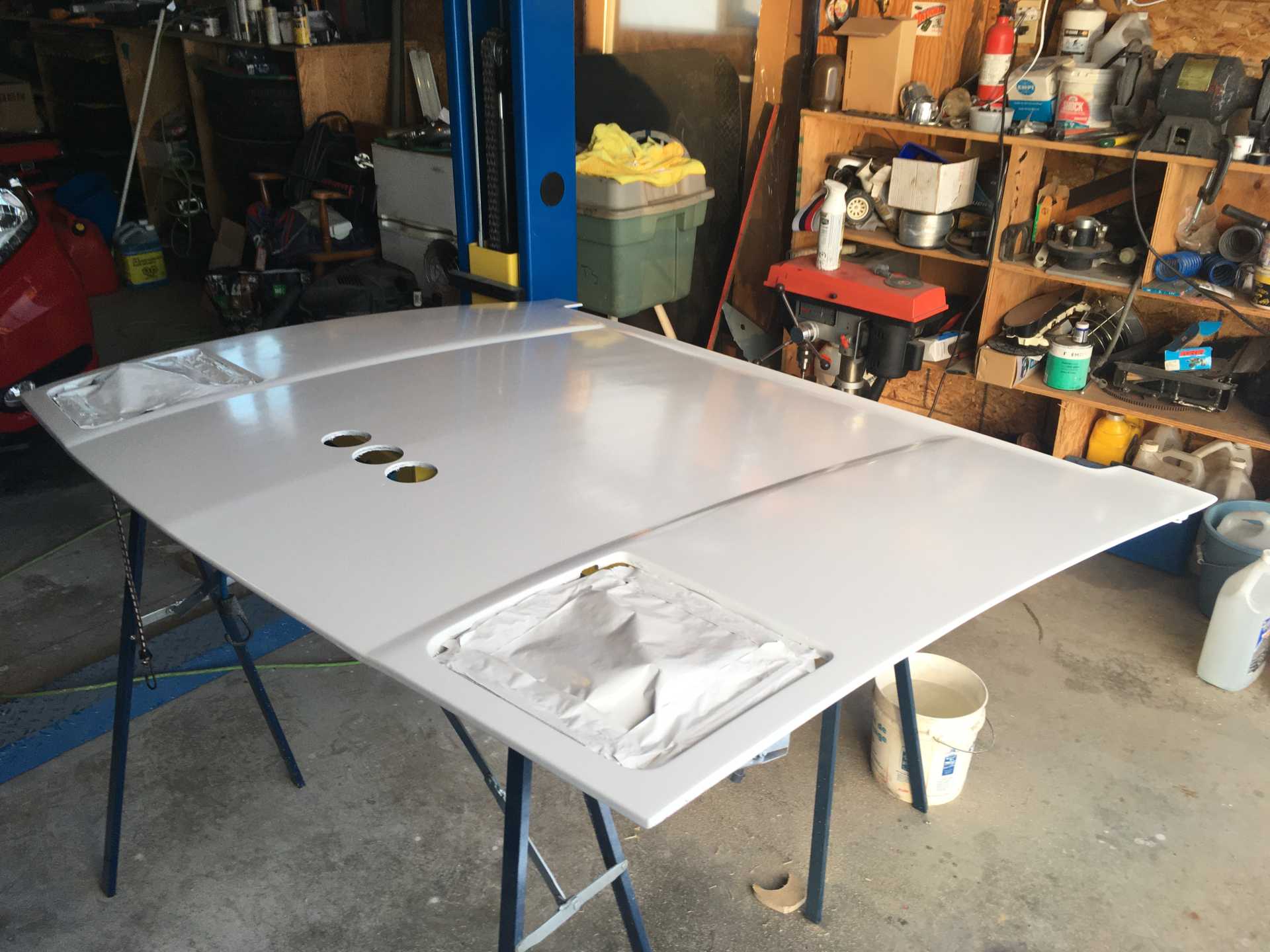

wftb FEB 29, 05:57 PM
So I hung the hood up sideways and vertical and gave it another coat of paint . Came out much better but not perfect. No drips this time and I should be able to buff out the imperfections so I am going to call the hood done.

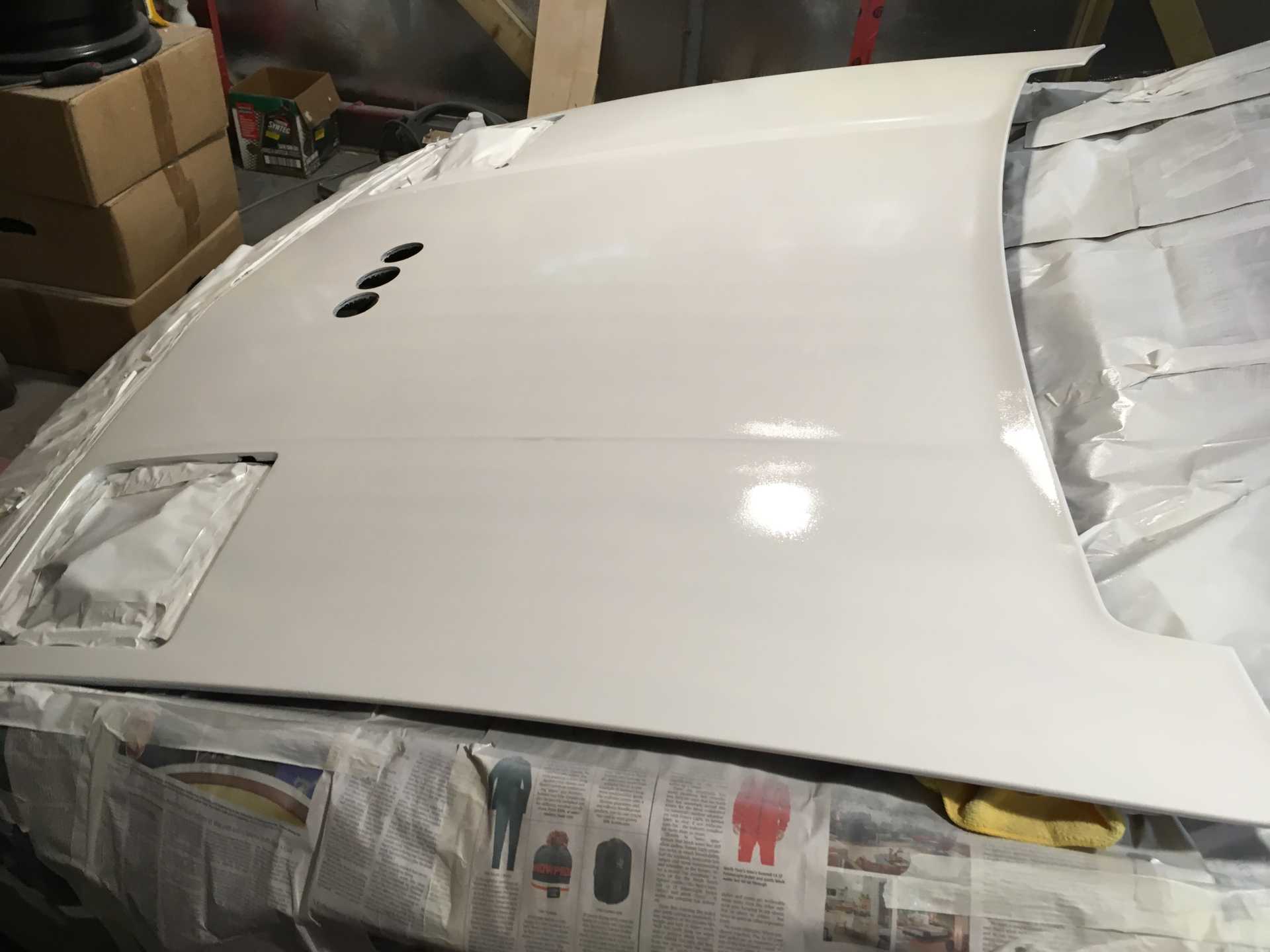

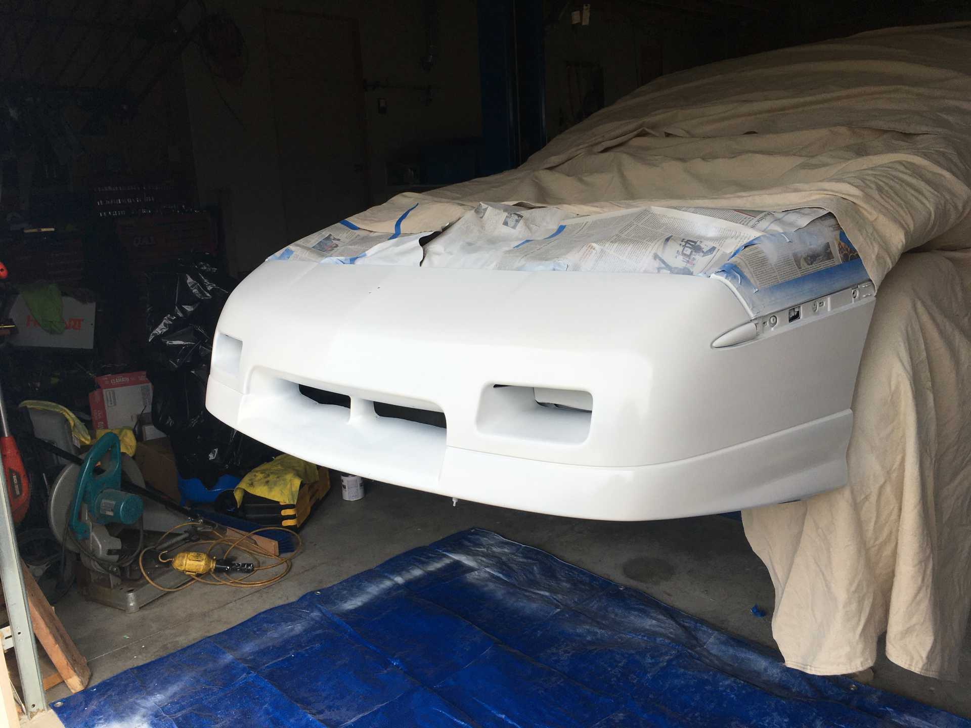

wftb MAR 19, 09:54 AM
Painted the nose with the spray bombs and got no dripping and I got it to gloss up nicely. There are a few minor imperfections but you have to really look to find them. The front hood ended up getting wet sanded because I couldn’t buff out the rough parts of it. I may give it another coat since I know I was the victim of some defective spray bombs.
I bought a new compressor to be able to use my hvlp spray gun but after reading reviews of the paint I was going to use I decided to stick with the spray bombs for now. I am putting three coats on everywhere so if I want to wet sand I can with out burning through.
