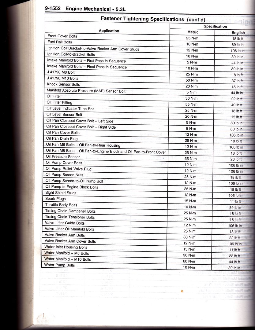

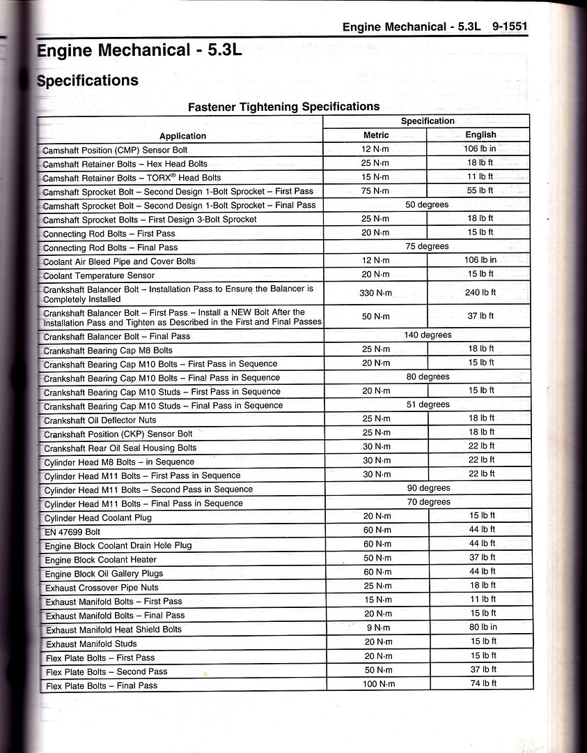

Someone asked me for the torque specs for the LS4, so here they are:
