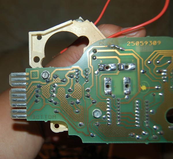

I'm just about ready to do this swap myself and it's LONG overdue. When I rebuilt the 3.4 motor I swapped into my car, I deleted the cold start injector system, thinking "Hey, I live in FLORIDA, what the heck do I need a *cold* start injector for anyway." Turns out they didn't mean "cold" like I thought. It's apparently when the coolant temp is below operating temp.... After having hard stating issues for so long, (having to crank the engine over 3-4 times to get it to start), I'm looking forward to the 7730 fuel enrichment at start up and hopefully curing some of the rich running I've had in open loop with this 3.4 until the car warms up, (after it finally starts...) I'm staying with the OEM cruise control, as I've already replaced all my IP and Aux gages with SpeedHut gages and tapped the 4000PPM signal off the OEM buffer circuit board, leaving the 2000PPM signal to the OEM cruise module intact.
 "Mulletproofmonk" is building me a nice "adapter harness" and Ryan is reprogramming the memcal. I'm hoping I'll have everything here and installed in a week or two.
