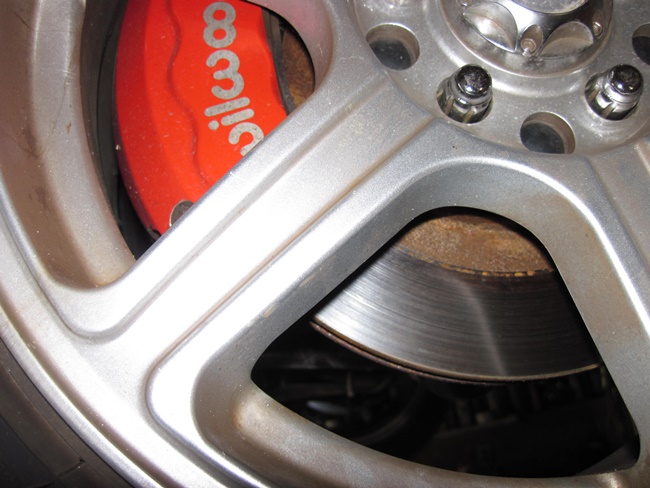

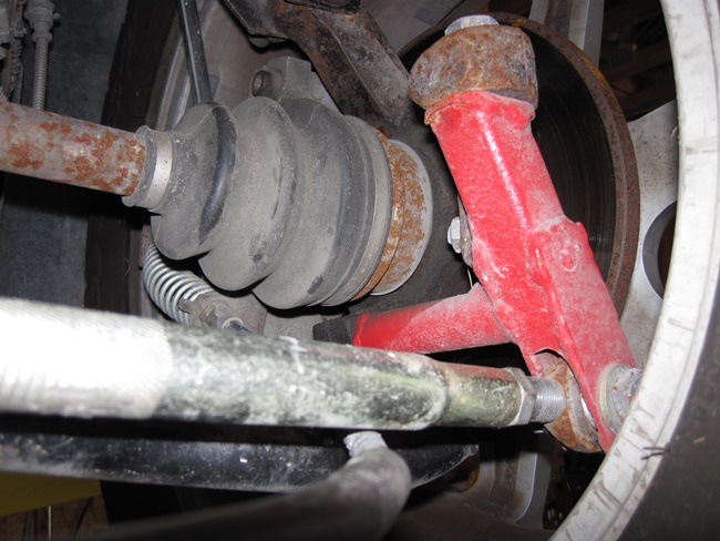

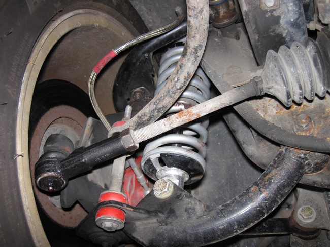

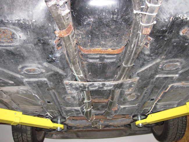

While I had the car up on the hoist, I took a bunch of pictures of the underside showing some of the stuff I have done and showing stuff I want to improve upon. Bumpsteer bracket after lots of use still like new:

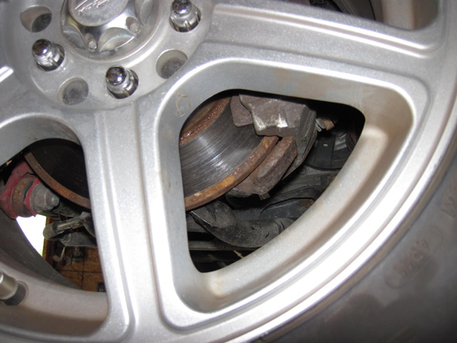

 Stock rear brakes still working fine after 3 years on the car. I am happy with the way they work, even for track days. If you look carefully, you can see that the entire disc is not being swept by the pads, making the effective size of the rotor about 1/2" diameter less:
 The front rotor is being swept right to the outer edge by the Willwood caliper:

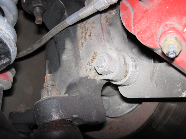

 I use Lebarron front rotors instead of the usual rear rotor. This requires shimming of the bracket. I used a stack of grade 8 washers and have not had any problems. Making some better standoffs is one of those jobs I have never got around to. The front Lebarron rotors are lighter because they do not have the built in drums.

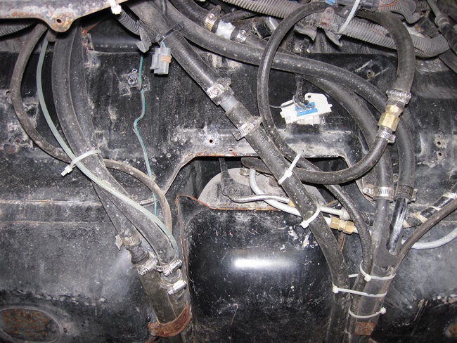

 The nuts are for security, the spindles are threaded. A turbo car carries a lot of plumbing:

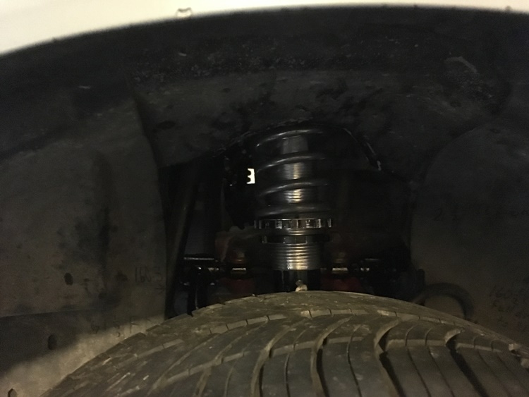

 A better Idea how tight QA1 2.5"ID coilovers fit.

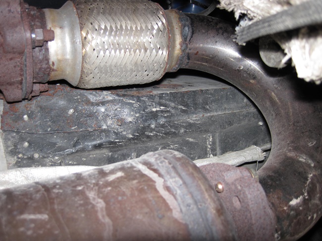

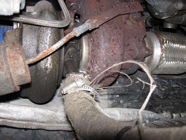

 Turbo is only visible from underneath
 Solstice cat,no muffler needed.

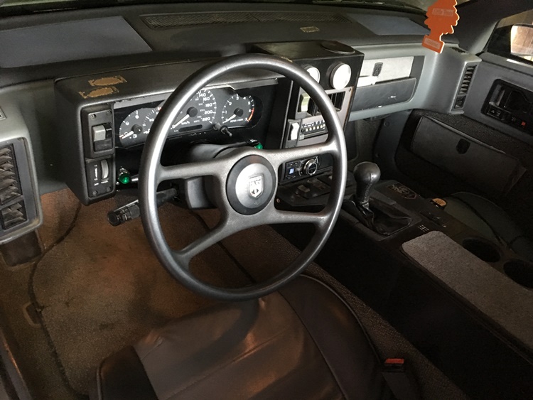

Those gages look really good in your console.

Thanks, from a 2004 cavalier. It looks better in pictures, the upper plastic mount does not fit very well and is a bit hacked up. Looking to find something better soon. Everything works except the gas guage, need to drop the tank again to try and fix that. The float is stuck against the plastic baffle in the tank. So I use the trip odometer to decide when it is time for a fill up.

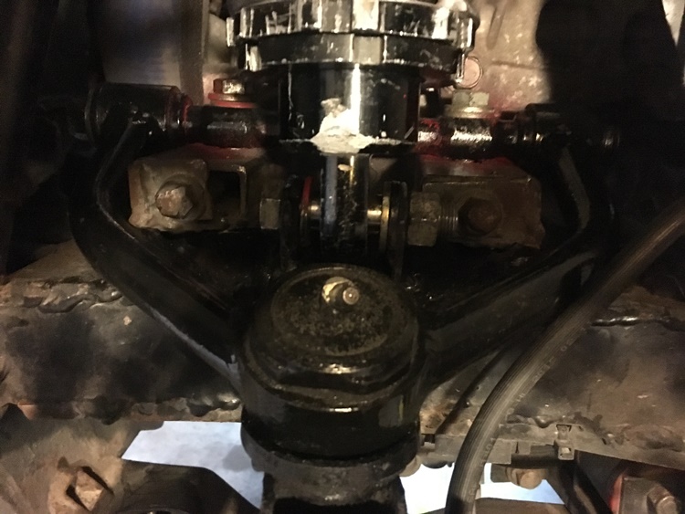

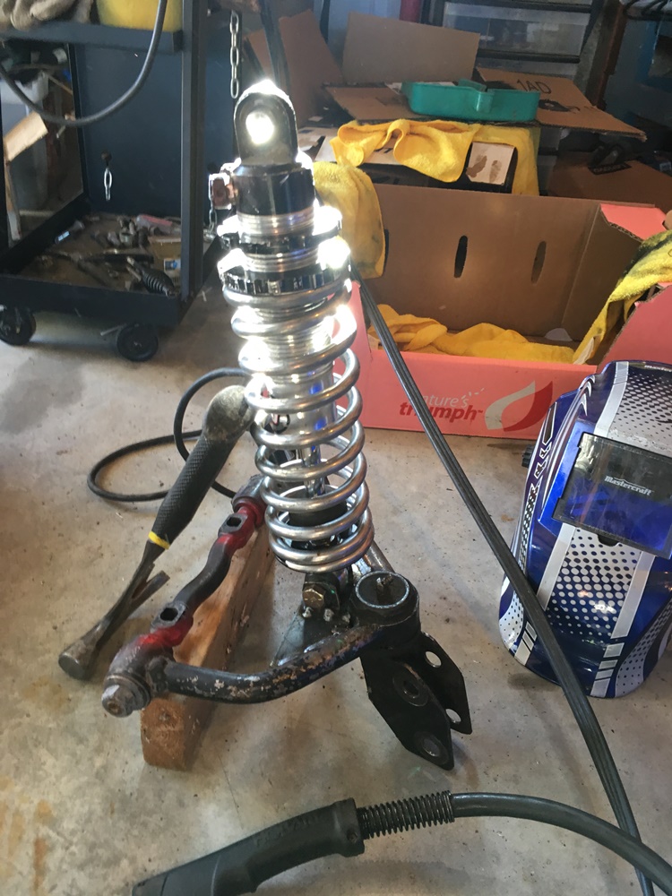

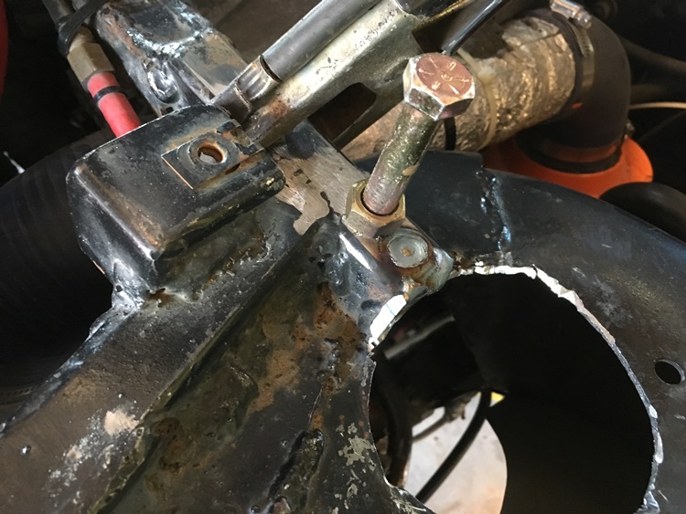

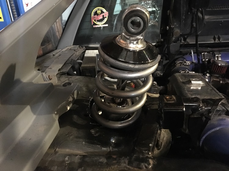

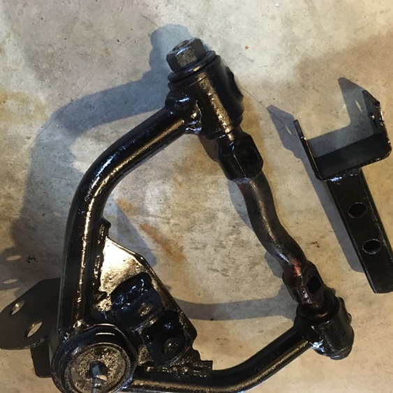

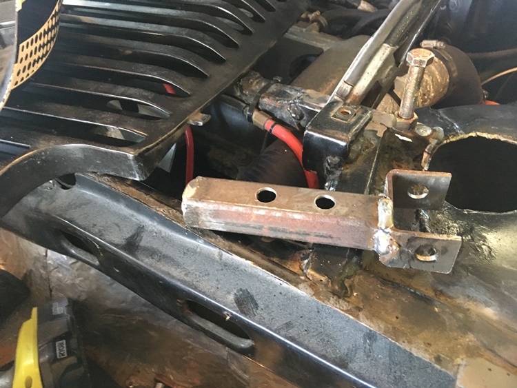

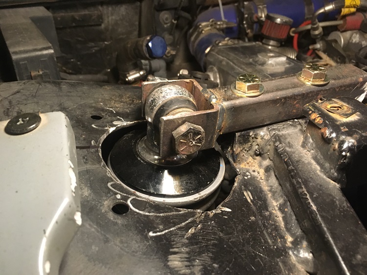

The other day I decided the rear of the car was a bit low so I adjusted the spring perches on the rear shocks to do this.The springs on the back are only 200 lbs so a bit of sag had probably set in. I took it for a ride and in town on our bumpy roads I noticed some thumping that wasnt there before.
The rear of the car has always had minimal travel the way it sat. Wheel movement compared to shock travel was pretty much 1 to 1. So with the soft springs cranked up to get the ride height I was after, when I went over a good sized bump I am pretty sure the shock was hitting its fully extended internal stop. Not good.
I have been thinking of ways to get more travel in the rear suspension. I came pretty close to buying some new KYB struts and some 7" coilover sleeves but just did not want to part with the cash. I built my system so I could go back to struts if I want.
So what I decided to do was to mount the bottom of the coilovers that I am using now on to the upper control arm and off of the strut adapter. This gives about 5" of wheel travel for every 3" of shock travel for a total calculated wheel travel of 6.6", a big improvement.
This requires new perches on the upper arms as well as new upper mounts for the coilovers.

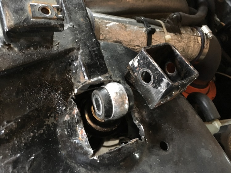

Cutting off old upper mount:
Make a hole big enough to install the shock from the top:
Make a new bolt on upper coilover mount:
I welded a nut to a piece of 1/8" flat bar nd slid it in to the strut brace and welded it to the end of the square tube and plug welded for good measure. This will make it much easier to get the coilovers off. The new mount will be held in place by 2 -7/16" grade 8 bolts. To make the new lower mounts, I carved up some flat bar to fit the arms, cut the old mounting tabs off the strut adapters and welded them on to the upper arms.
I don't have a pic with it all installed yet because I am waiting for paint to dry. I installed everything except the coil springs and I ran it up and down and I now have 1 1/2" more droop and I can run way in to the wheel well, all with out hitting the stops on the shock. I managed to fit the mounting plate so my camber adjusters still work and are easily accessed.
